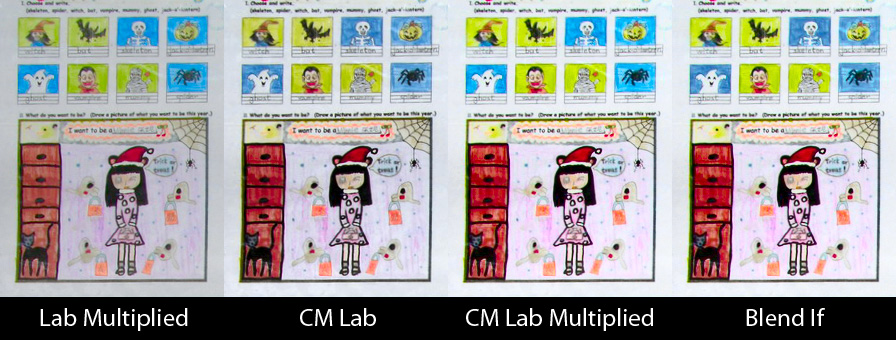

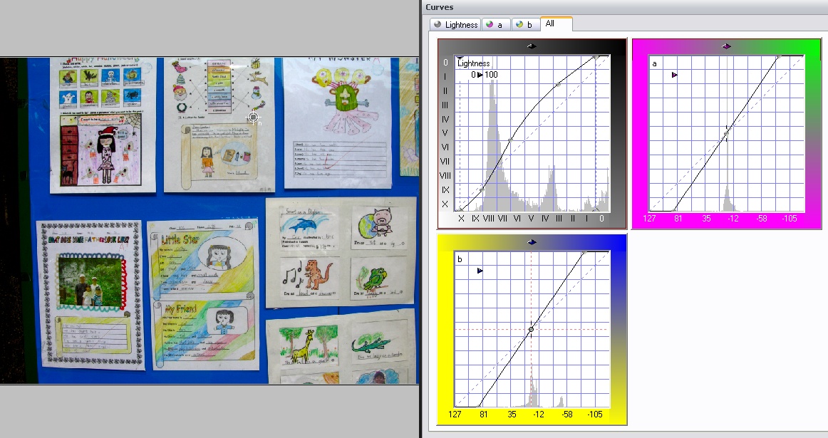

I tried this image two different ways; firstly, a Lab correction of the original; secondly, before opening CurveMeister, I applied a false profile (gamma 1.4) to the image, converted it into Lab, duplicated the background layer, and set the duplicate to 'Multiply'* - and then corrected this in CM (again, in Lab).
The second approach is something Dan Margulis has been doing in the videos I have been watching, and I wanted to compare this approach with the results I might get from going directly to CM. I have uploaded comparison images, so you can judge for yourself which version is better. The Lab curves were not identical, so it is perhaps an unfair comparison, but in both sets of curves I tried to do the best I could for the image.
I generally preferred the look of the premultiplied version - but the blues in a few of the children's drawings looked unrealistic (I've cropped a bit of the photo for comparison). I fixed this by converting the image into Lab, and using the 'Blend If: B' slider to revert to the blues from the normal Lab correction.
This is more colourful than I usually make my images - perhaps watching Dan M has affected my colour judgement!
*I took all of the new colour from this layer, but only half of the luminosity...

Lee you might be over thinking this one...
The CM Lab correction you posted is a touch hot in the highlights but otherwise it appears to be pretty good.
I'd leave the flash flare alone...It is a good test of your skills but the type and color is more important in this image...
Again it is the "significant" shadows and highlights that we are after...if there is no tonality in the highlights it can be a problem but for this image we are after getting the type clear and the colors bright...

Thanks again for the advice and the curves ;)
I just loaded your curves and compared the results to my versions. You're right - I should have been working on making the text more legible (something that your version does, whereas all of my corrections obliterate the text!)
I think that watching those Dan Margulis videos has had the effect of making me over analyse everything! Also, Margulis goes crazy with his colour boosting - making his corrections much more saturated than I usually think looks right, but I attempted this image after watching him correct files and that tendency has obviously messed up my judgement! It's really useful having these things pointed out as they are easy for me to miss.
