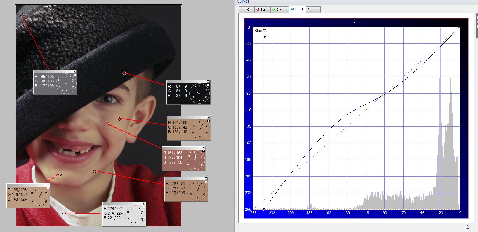

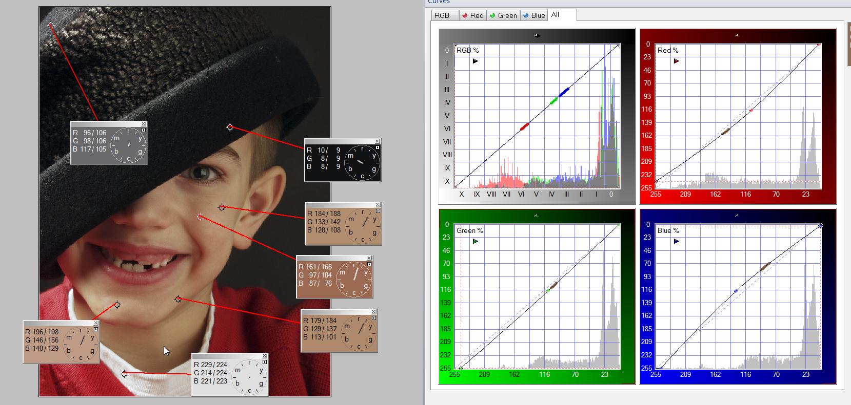

Postby ggroess » Fri Oct 01, 2010 7:42 pm
Ok,
Shot 1 is a straight BTN correction.  It certainly is pushing the limits on the skin tone but they are not "out of bounds" All that said Shot2 makes the skin a bit warmer and less sallow.  I simply adjusted the Blue channel in the range that the skin tones are located.
