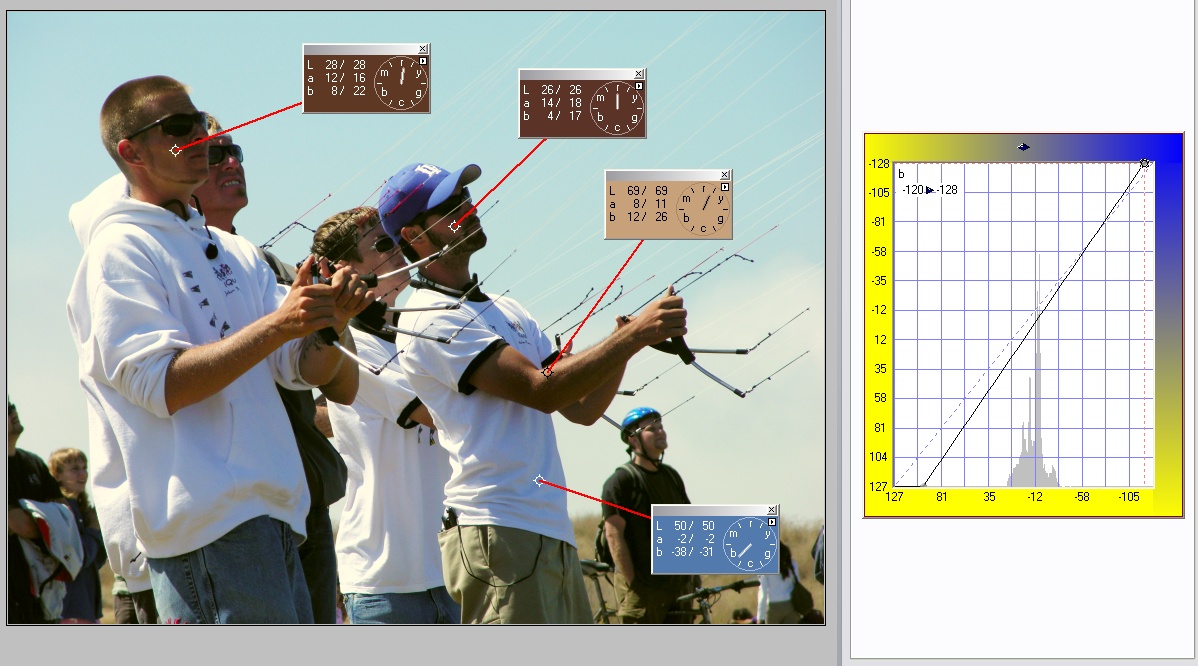

Postby ggroess » Thu Jun 25, 2009 7:33 pm
To get into the ball park fast.....
1) Duplicate the background layer in PS or PSE and set the copied layer to "screen" mode.  Flatten the layer.
2) Open in CM and up the saturation to about 1.5 or so.  Then move the blue end of the B channel back until the skin looks right and the sky is a bit more natural.
This is not the final solution...it just gets you closer...the issue here is the blue cast in the shirts.
Keep curving on this one..go slow and think about what color you are trying to kill and ways you could do that.  I can think of about 3 so far...
shot1-jpg-121
shot1-jpg-121 (239.11 KiB) Viewed 12803 times
