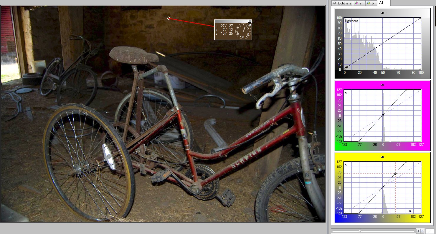

Love the disc brake.Started with blend mode,then color in Lab,then selected red slats and rear wall and removed some red using the red channel in RGB.GregM
Took bright patch down to 247 in RGB composite channel.
