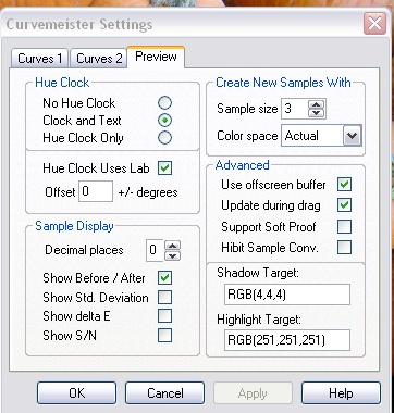

I have my Target settings such that I do not really output the full range of RGB values...See Shot1.

BTW made the changes you suggested in your screen shot. Thanks!
