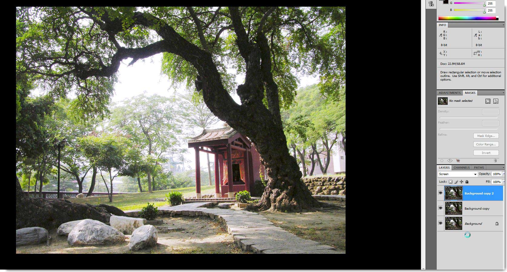

Postby ggroess » Wed Nov 11, 2009 1:18 am
Hey Joann,
No problems...
Start over and go at it this way....

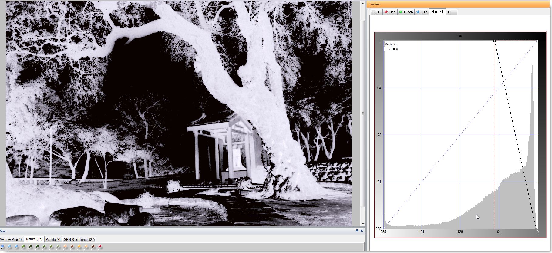

1) copy background and set the layer mode to screen.
2) copy the screen layer so you have 2 screen layers like shown in shot1.
3) Select the background layer and open CM.
4) Select the L channel for a mask.  Adjust as shown in shot2.  Select a light blur.
5) Apply the mask to the top layer of your image.  This will lighten the dark shadows without blowing out the trees.  Shot3
6) Flatten your image.
See next posting....

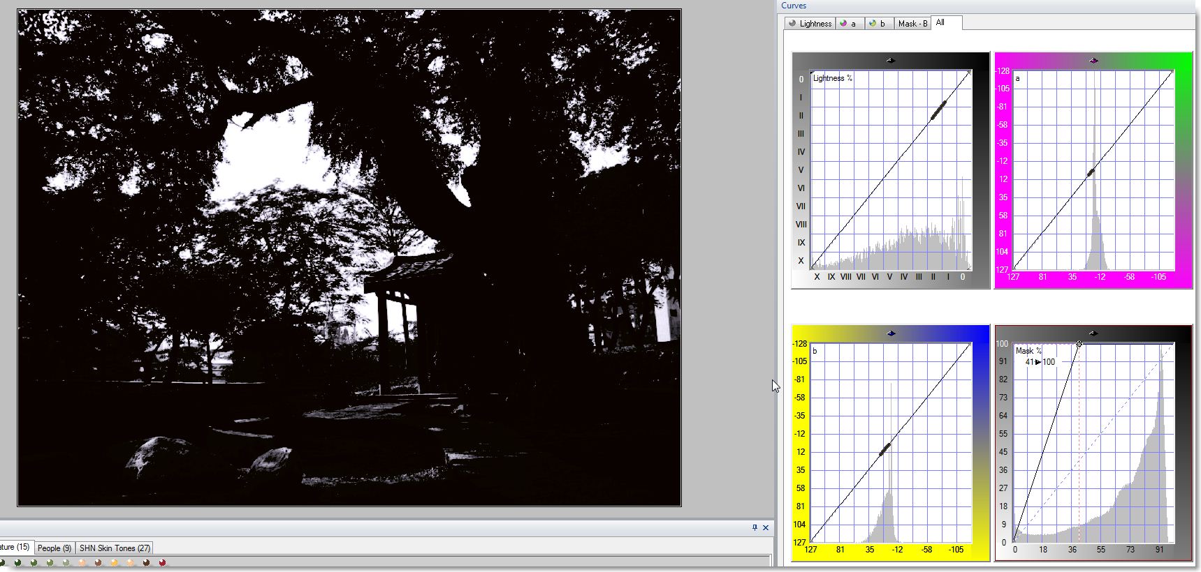

4) Open CM and create a B channel mask as shown in shot5.
5) Paste the mask into the background copy layer.

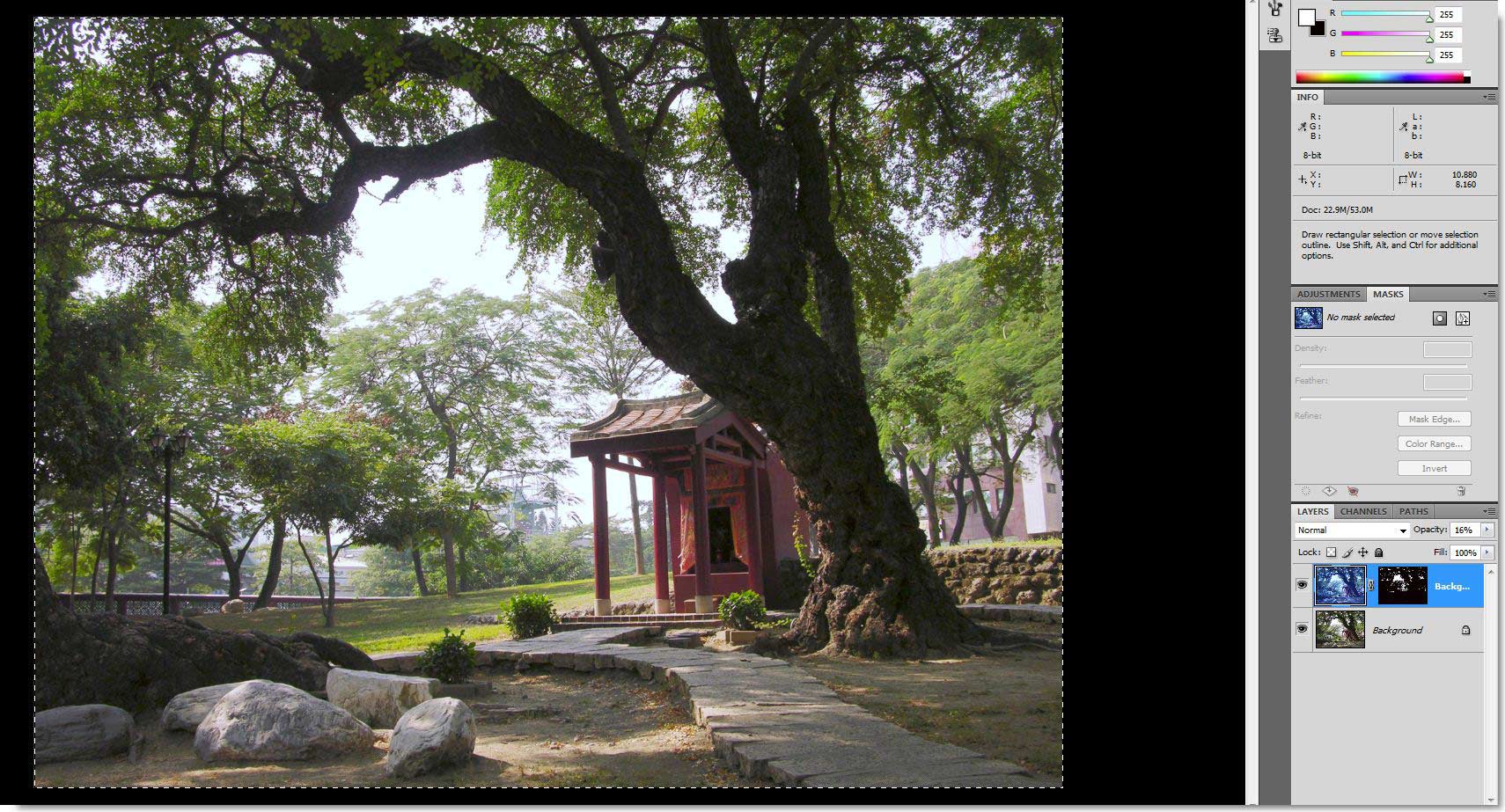

6) The image on the layer and apply a sky pin to an open area of sky. Apply and close CM
7) Set opacity to 16% or so...Shot7.
Flatten image.
8) open in CM for the last time and adjust the color saturation in LAB with the slider and MFM K channel mask as needed.
