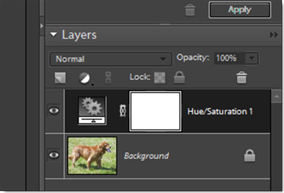

Here it is step by step for PSE using version 7.
The idea here is to create a mask. Not necessarily an adjustment mask that you would apply CM to.

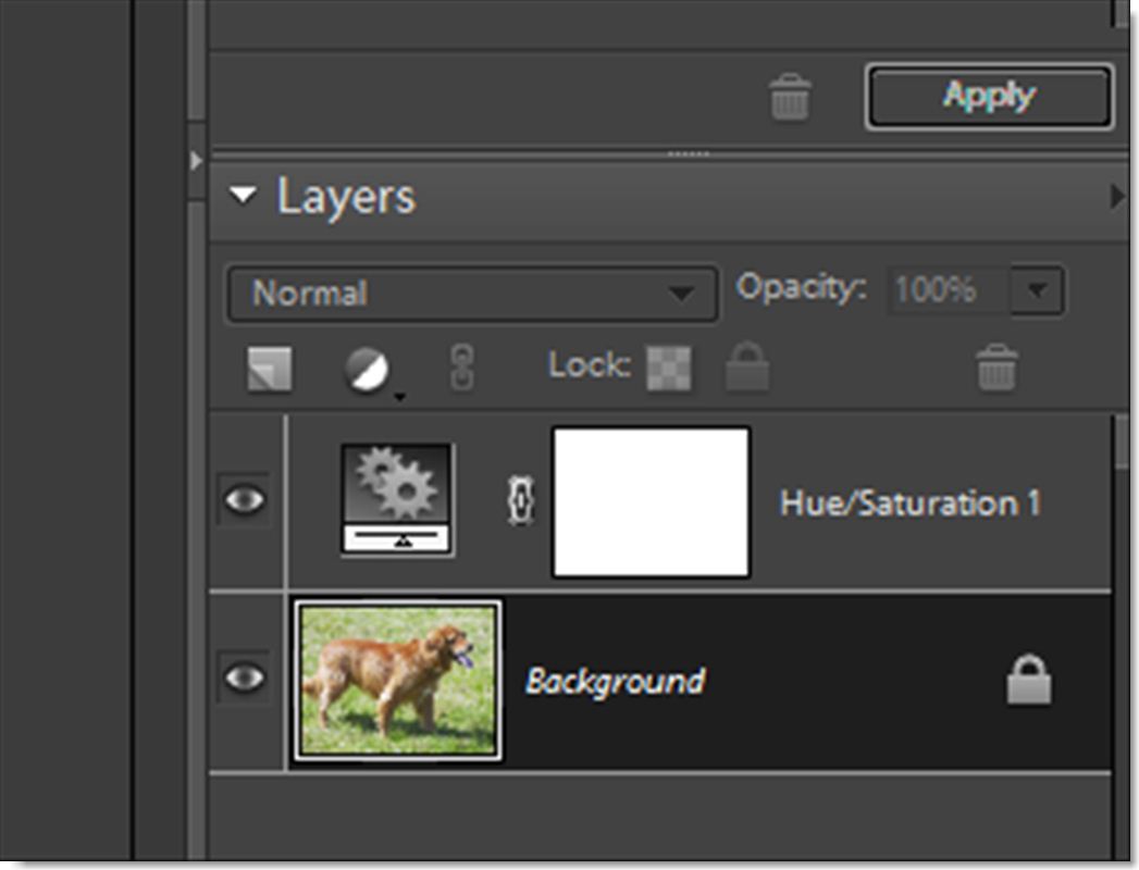

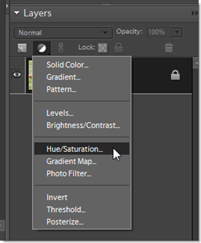

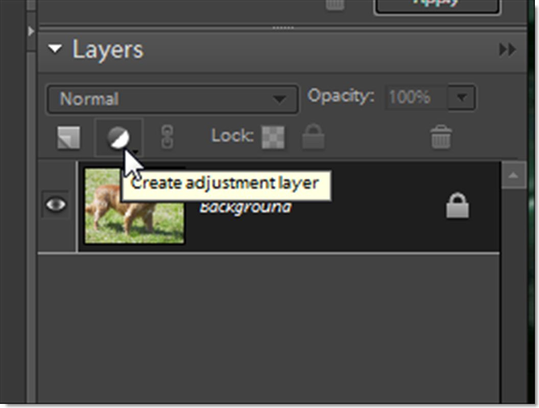

Start by creating an adjustment layer with hue saturation...Shot1 , 2 and 3 Click OK on the dialog box to close it for now...

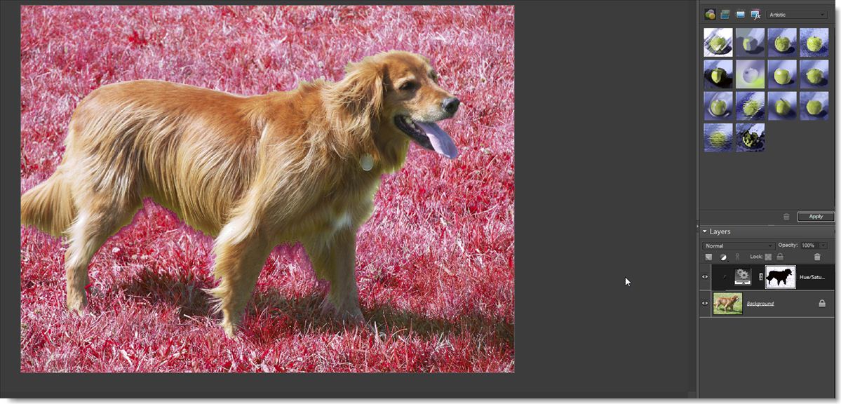

Select the background layer and open CM to create the mask. Shot4. After you copy the mask to the clipboard by using the copy Icon in CM return to PSE by clicking cancel on the CM dialog.

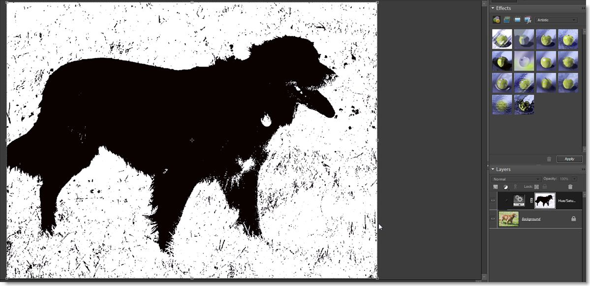

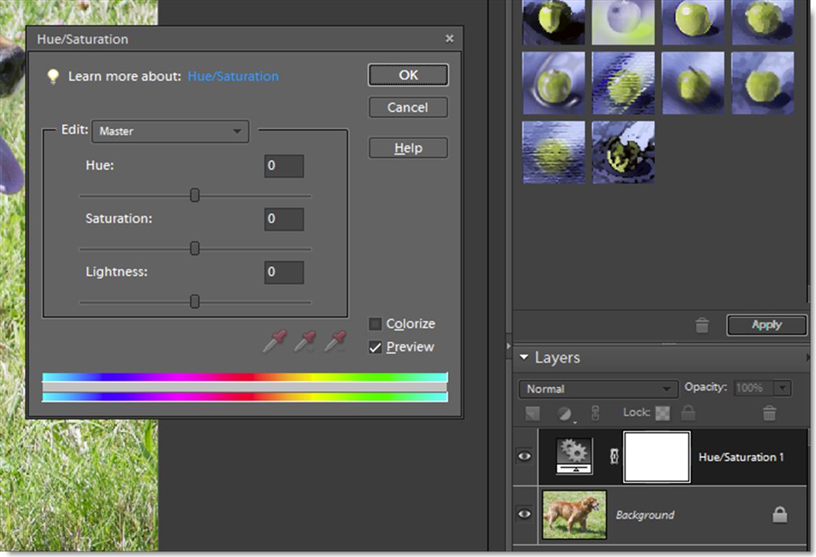

Select the mask by Alt-clicking on it Shot5 you should see the dark line around the white square. Paste the copied mask into the layer mask with Ctrl-V or edit>Paste. Shot6
Re-open the hue adjustment by double clicking on it. and make adjustments as you like....Shot7
