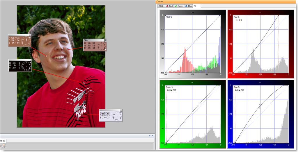

Postby ggroess » Fri Oct 23, 2009 12:00 am
Joann,
I want to show you this so you know where you can take your images...
Here is how I would tackle this image...
First I opened in CM using LAB and lowered the highlight value by dragging the highlight end of the curve into the image until there was tonality in the brightest highlights.
The I opened in CM again in RGB mode.  I did a slight variation on the BTN correction for this image using the white and black on his shirt for the shadow and highlight values.  I then Pinned the skin using the Skin 1 Pin from CM.  Shot1.  Apply and Close CM.

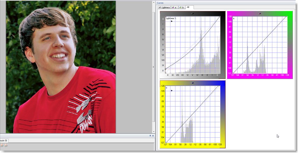

Then I opened in CM using LAB again since the mid tones looked flat I added some mid-tone contrast using L from LAB  This allows me to adjust the lighting without changing the color.  Shot 2.  Apply and close.

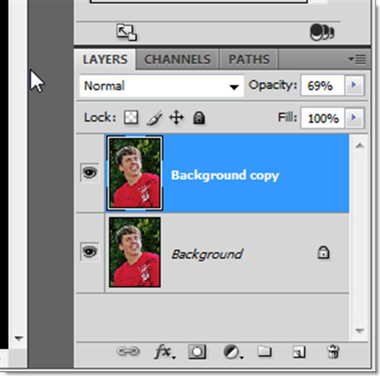

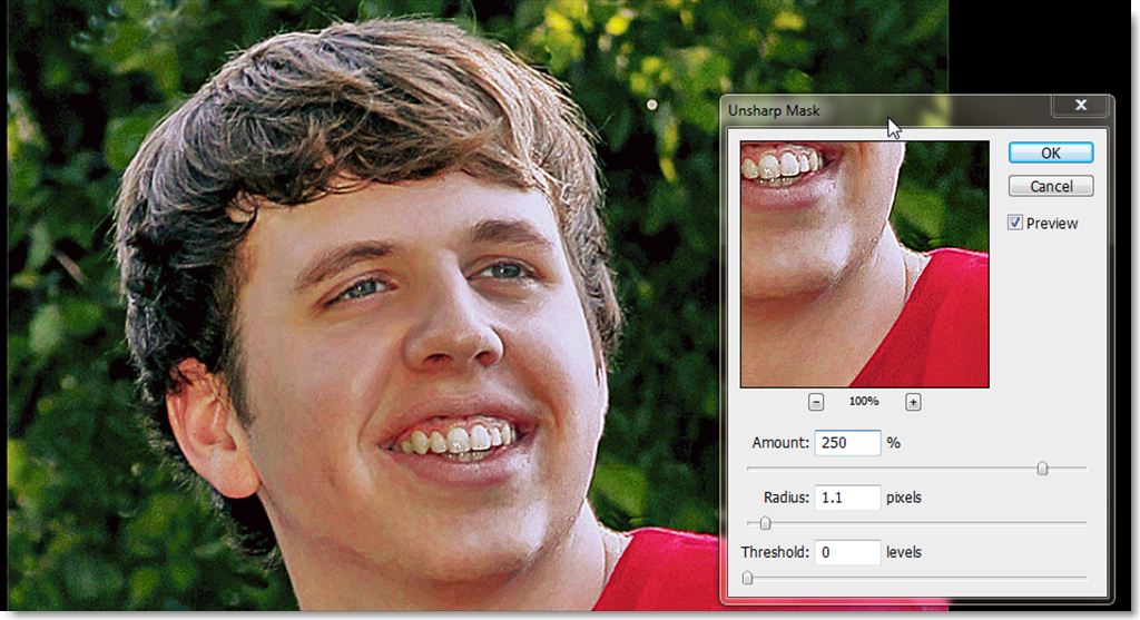

Now for the non-CM moves...You can do what you like but here is my PS adjustments...
Create a layer copy in normal mode and use Unsharp mask.  Shot3.
Reduce the opacity of the layer to 70ish percent .  Shot 4
Flatten the layer and save...
