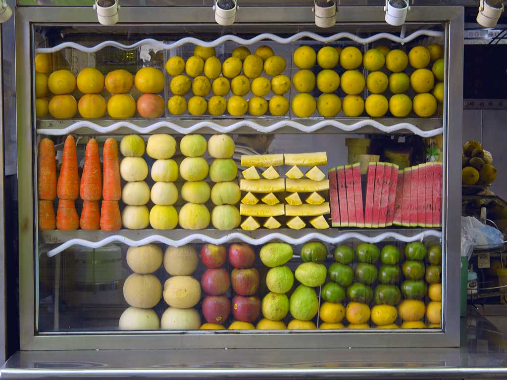

Not ahppy with this at all but couldn't make it any better by moving neutral around. I think my other attempt last week using shadow, highlight , neutral was better. Its all a bit pink but I didn't know how to make it better.
To finish I added a bit of contrast and sharpened
julie fruit using hue clocks

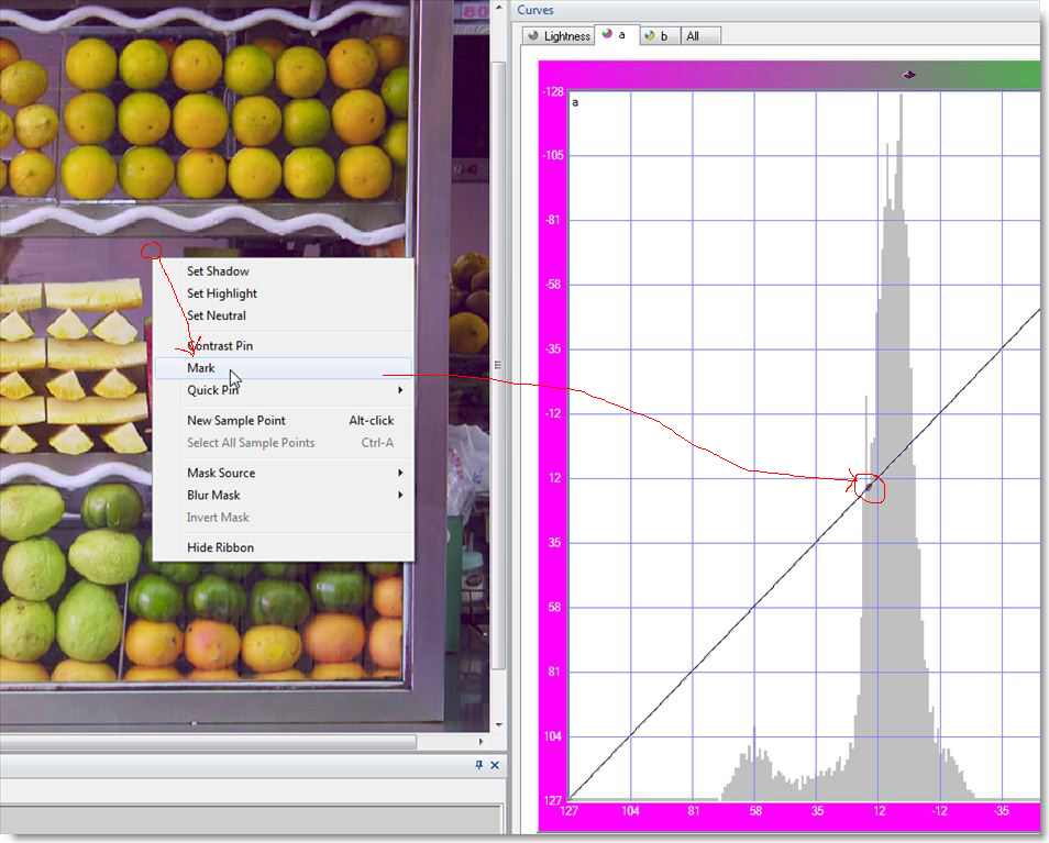

Localize the "pink" to an area that is the real give away, something that should absolutely not be pink.....Right Click and chose "mark" see shot1. The dot on the curve is the mark I just set...this is the adjustment point. Everything else is going to be control points to keep the curve going in the right direction.

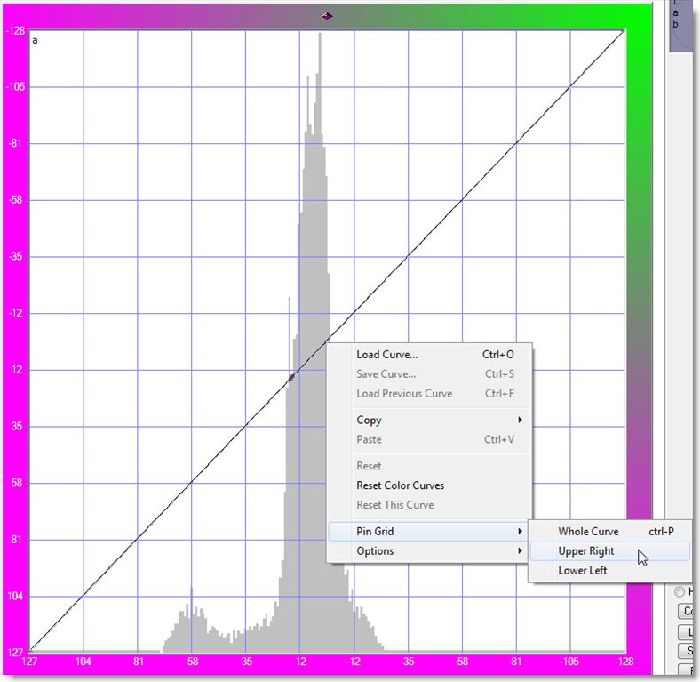

In Shot 2 I "pin" the grid to the upper right so that I do not mess up the Greens. In the center of the A curve right click and chose "Pin Grid" then chose upper right to pin the green side so it cannot move.

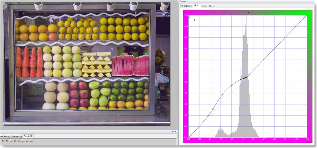

Adjust the marked spot by moving it up towards the center...remember the center of the grid is the neutral....Shot 3...Note that when I move the marked point up the worm gets longer...the three arrows you see are points I placed on the curve for control of the rest of the red and pinks...and I had to move them around a bit to control the pink in the water melon. Have patience and give this a try.
Final shot is the image after this adjustment.
on the image you have posted....

forgot to save the acv file but I know this is better. I didn't understand that the middle of the graph is neutral-its good to know.
