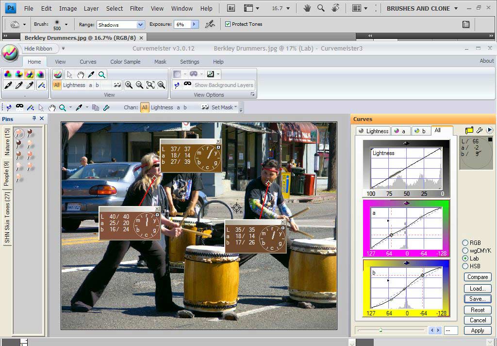

Postby joann » Tue Oct 20, 2009 11:14 pm

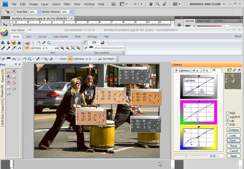

I think I've got the skin color going in the right direction, but how do I make the hue hand shorter? On the girl it's really short but on the men it is not.
berkley-drummers-jpg-lab-acv-2
capture_berkley-drummers-web-jpg
capture_berkley-drummers-web-jpg (999 Bytes) Viewed 15050 times
Postby ggroess » Wed Oct 21, 2009 12:08 am
The length of the hand is saturation.  The longer the hand the more saturated the color.  You might not want the goal to be short hands....

Postby joann » Wed Oct 21, 2009 1:31 am
Oh, Then I need the girls hand to be a little longer.

Postby joann » Wed Oct 21, 2009 6:33 pm

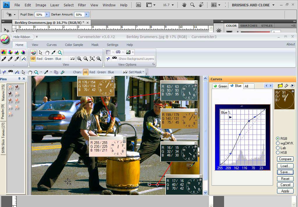

Here's another try at Berkley Drummers.
JoAnn H
(74 Bytes) Downloaded 1008 times
screen-capture-berkley-drummers-web-jpg
screen-capture-berkley-drummers-web-jpg (132.61 KiB) Viewed 15050 times
berkley-drummersweb-jpg
berkley-drummersweb-jpg (126.83 KiB) Viewed 15050 times

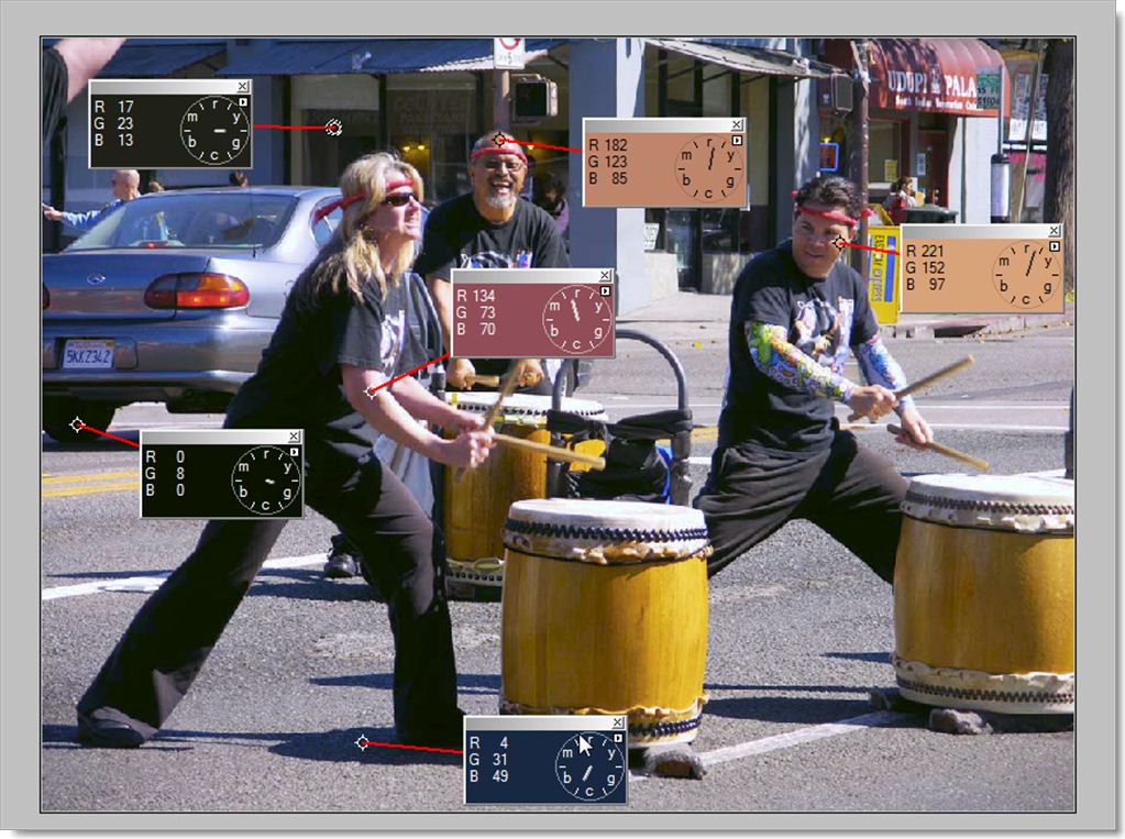

Postby ggroess » Wed Oct 21, 2009 11:46 pm
Overall the image looks better but there are still some issues to tackle...
Try to remove the blue shadows in RGB and see if the faces get better.

joann
Posts: 184

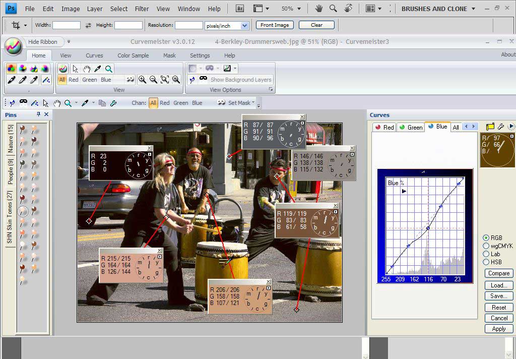

Postby joann » Thu Oct 22, 2009 2:10 am
I may have taken too much blue out. The skin looks a little yellow to me. The shadow looks like it has green.  Did I go too far?
JoAnn H
2-berkley-drummers-jpg-rgb-acv
(90 Bytes) Downloaded 1043 times
2-screen-capture-berkley-drummers-web-jpg
2-screen-capture-berkley-drummers-web-jpg (135.12 KiB) Viewed 15050 times
2-berkley-drummers-jpg (127.32 KiB) Viewed 15050 times
Postby ggroess » Thu Oct 22, 2009 2:17 am
yep...too far...
At least you see it...
Keep going...it's out there for you...
joann
Posts: 184
Postby joann » Thu Oct 22, 2009 2:55 am
I think this is better.

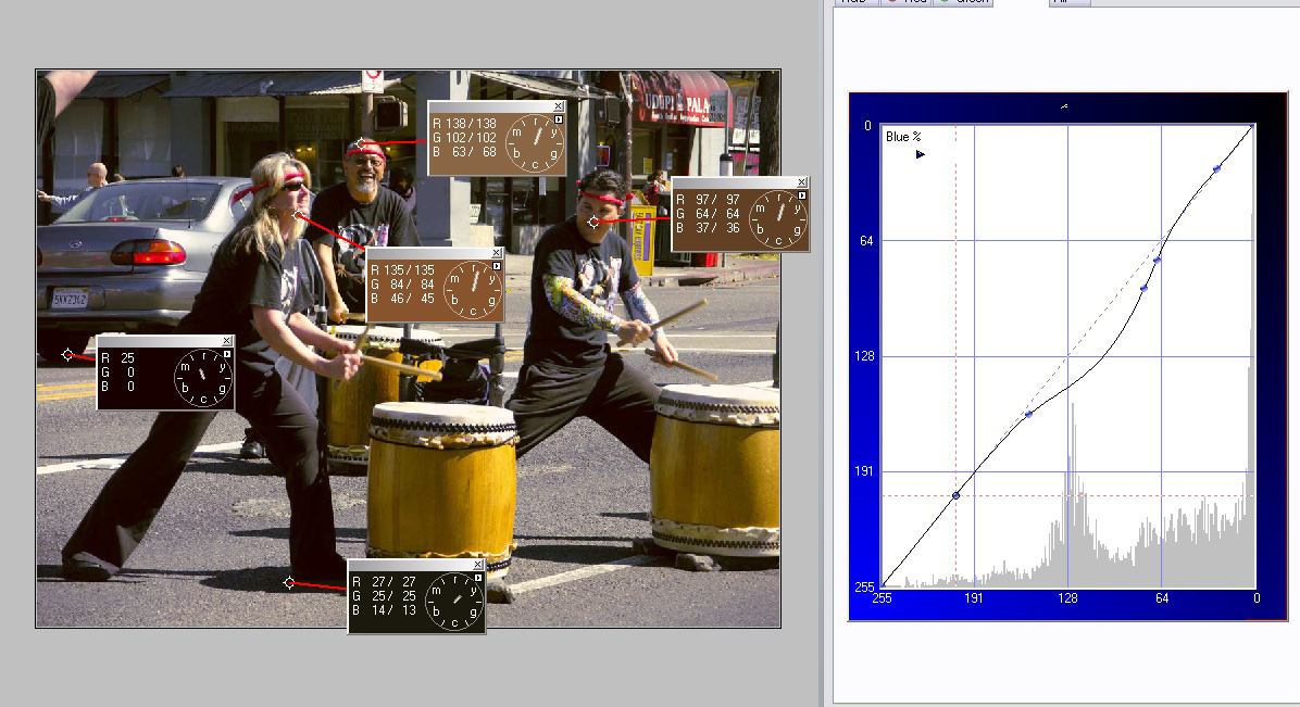

Postby ggroess » Fri Oct 23, 2009 3:44 pm
Sorry I missed this one....
Try bringing the Mid tone blues back into the image....It still looks to yellow...

Postby joann » Fri Oct 23, 2009 4:24 pm
  Here's my new Berkley Drummers..  How's this one. I didn't start from scratch I just took blue out of my last corrected copy.
