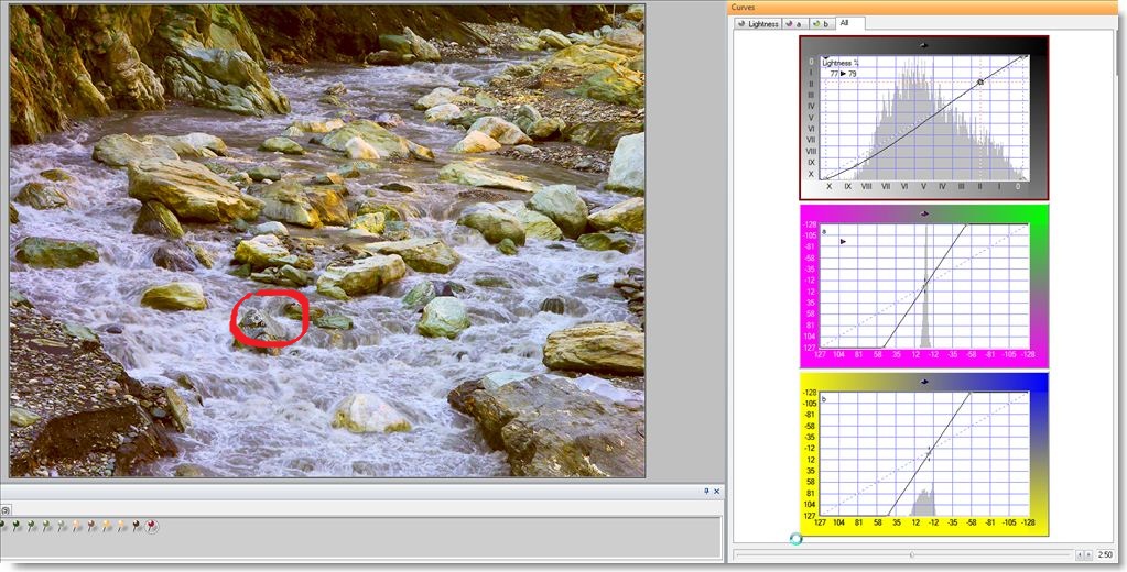

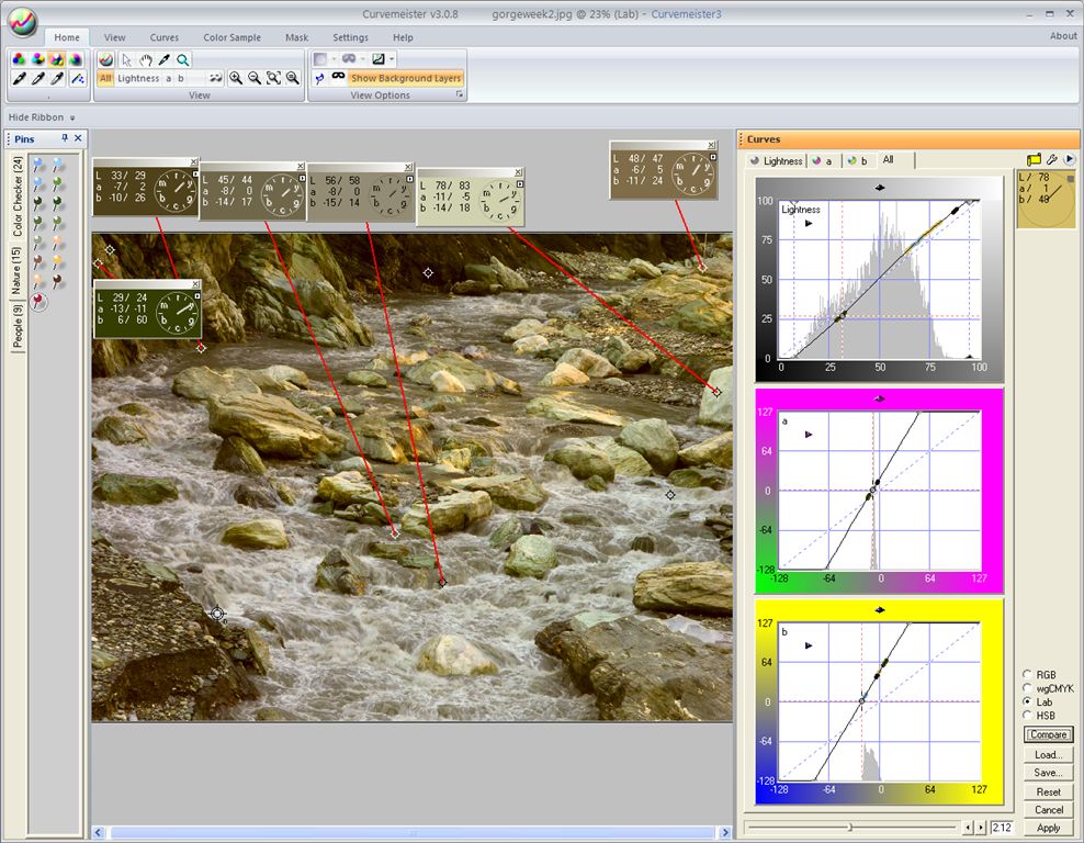

This one really does come down to the neutral. The trouble is...What is a really neutral object in this frame.
I took your posted image and "shopped around" for a new neutral. To do that you set the neutral where you think it should be...usually something obvious. Often times because of the sample size, color noise or just plain bad luck you miss...
But with a bit of patience you can find a good neutral that allows you to really pour on the color....
- screenshot001-jpg-120 (204.85 KiB) Viewed 10243 times
