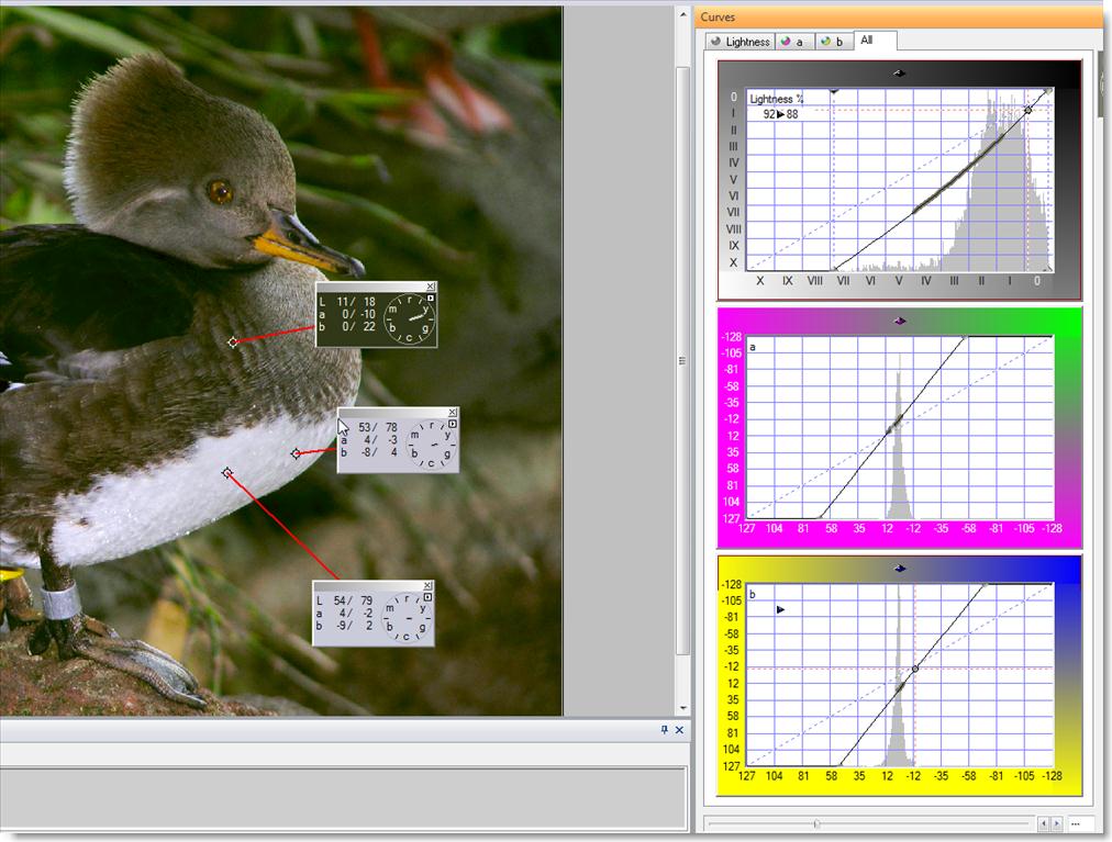

Joann,
These look very nice....really...
In the LAB duck you can make 2 VERY SMALL CHANGES... I use caps here because they are really no big deal but I get the impression that you are trying hard to get these completely right so here we go....
If you look at shot 2 it is your ACV file loaded against my copy of the duck image. Take a look at the hue clocks I have placed on the image.
NOTE: To place Hue Clocks like these "Alt-Click" on your image. You can add as many as you want...They can be confusing at first but they lead you to the right correction. It's like having the info pallet open 3 times at once...
The LAB hue clocks I have set show that in the white parts there is a slight yellow / green cast. I took out the yellow by moving your B channel neutral point straight up. Click on the point and use the arrow keys. Watch the hue clocks change and pay very close attention to the whites. Because you hit the highlight details so well the color shift is more obvious than if you had blown them out. When you remove the yellow the very slight green cast is acceptable on my monitor so I did nothing about it.
Second small change...The shadow detail is great but the separation between the head of the duck and the background is a bit lacking. You can adjust the shadow end of the curve to open it a bit and separate the head from the background a bit. Look at the l channel and try to adjust yours as I have and see if you can find a nice happy medium between the two...
Great work really...

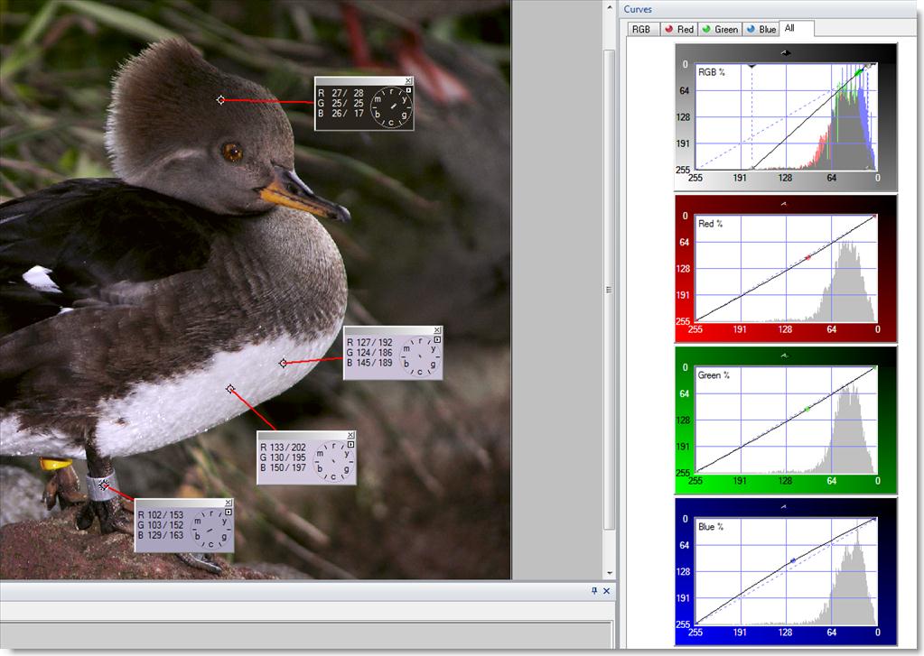

Joann,
RGB Duck has a very similar problem just a different channel...This is good... it is highly fixable and easily seen when you know where to look.
I'll post your ACV on my copy of the image with the hue clocks on it below...I can tell you that the neutral is a bit off...look at the hue clock on the leg band. The B channel is out of line for a known neutral. Try moving the B channel neutral a bit and see if the overall image gets better for you...
Question...Do you use the hue clock on the upper right of the CM window when you set your neutral? Some things to note about the hue clock...
the length of the arm is the saturation value for the color. the longer the arm the more saturated the color. The hue clock on the CM window does not show the color indicators that the alt-click clocks do...that is a disadvantage at first but after you get used to it the hue clock can be fast and easy.
There are many times when something you perceive as a neutral has a pretty strong cast. If you stare at the screen long enough the color begins to look very neutral even when it is not. When I set a neutral I do not shoot for perfection. I try to find a spot that is -2 to +2 in either channel and fairly equal between the channels. If any 1 channel is way out of line it most likely will not make a good neutral point. Unless I know for certain it is neutral then I force the issue.
Great stuff, you are really getting better even if you don't feel it yet...your images are really close and I have been a bit nit-picky. I hope you understand.

I have never used a hue clock because I don't know how. I don't know how to interpret the numbers. Also, I don't know how to interpret the number for neutral. Actually, I don't know very much at all. I don't know what a worm is and how you interpret that either. Sure would like to know how all this works.
