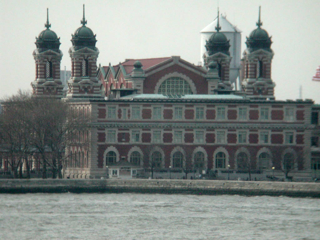

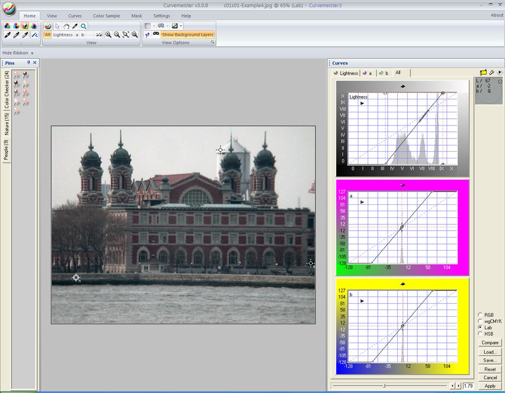

Greg,
i had another go. better now i think. I know that i like contrast in photos and so i have tried to add contrast and brightness. I hope not too much. i was unsure about the colour. It needed to be stronger but it was a difficult choice on how far to go.
In lab I used the saturation slider and used shadow, highlight and neutral. i then sharpened, added a little levels adjustment and added more saturation.
In rgb I used shadow, highlight and neutral but then moved the highlight curve inwards along the top just a little to increase contrast. Is this ok?. Out of curves I added saturation in the red channel, brightness and contrast and sharpened.
I think these are better than before. I think I like the tone of the lab one. the colours look better for a grey winter day. Looking rforward to hearing from you

Good work on both versions...you have begun to isolate the issues you want to fix and formed a plan that has helped you get there...
The LAB version is certainly my favorite so far but I can see advantages in the RGB as well...... what to do....Both images are solid but the lab has richness that the RGB seems lacking....It almost looks thin in comparison.
When it comes to color, we will be really pushing that around as we go forward. It will become the manta I chant at you sometimes..."More Color... More Color" ...I think the Lab version overall has an advantage because the saturation slider makes the color pop out faster. If you want to increase saturation in RGB you really have to be careful.. it is easy to introduce color casts with those kinds of adjustments, hence you went to PS tools to get it done.
Some things to think about going forward....In RGB the color is linked to the brightness. You can have multiple neutrals in RGB in fact one of the things in the class description is a color by the numbers correction using CM. This is best done in RGB. That is a strong advantage...The adjustment of the color is also much more subtle in RGB and even more so in CMYK. LAB can be like a sledge hammer for color.
There are colors in the LAB gamut that cannot be created in RGB that can be a problem..if you correct in LAB and go to print you might find yourself lacking the ability to print the colors you see in the file. Lab also can only have 1 neutral. Oh yea..there are ways to trick the program into allowing more than one but that is so far out of scope for this class I'll only brush it lightly here.
The biggest advantage for LAB and one that is almost impossible to beat is the fact that unlike RGB where Color is linked to brightness in LAB color is totally separate from brightness. The L channel is the biggest tool in the box. It is very versatile and so intuitive. I go to lab for fast and furious color. I use it more often than any other space....The sharpening looks good. not at all over done on my monitor. You do start to pick up some color noise but we'll talk about that as we go further into the class.
