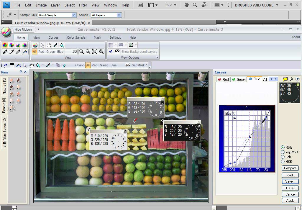

You are trying to go with Absolute values for the correction and this is not necessarily the goal.  Remember that each image has it's own highlight and shadow value.  Most times you do not want to drive the shadow down to "0"  nor do you want the highlight to be "255".
For instance in your posted image you have shadow and highlight values in the hue clocks shown.  The Highlight value is 234 on the screen shot.  Your goal is to make all three channels have "234" as the value for the highlight.  This makes the highlight neutral in RGB.  For the shadow you have "7"  All three channels should equal 7.  That makes the darkest shadow you have chosen neutral.
The Mid-tone Gray is another story.  As Greg M stated.  The Mid-tone is an average of the "before" values.  Setting it to the middle value of the hue clock will upset the contrast.  You should take the before values on the hue clock and average them.  I get "96" , Your value of 106 makes the mid-tones too bright and then you have to fight for contrast later.
Try out these values and see if it gets easier to find the contrast...
