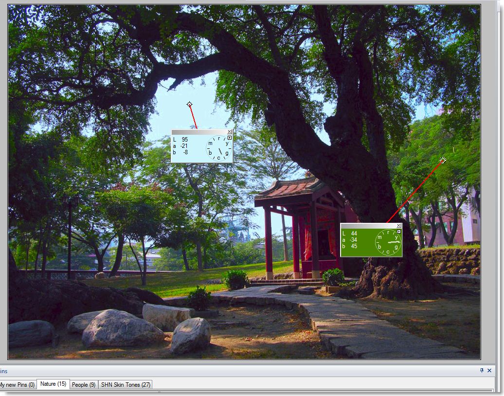

Postby ggroess » Sun Nov 08, 2009 4:16 pm
If you still have access to the sky layer you might wan to visit the color.  I have a very greenish cyan sky.  The MFM move is good but again the greens are a bit over the top.  I like the shadow move but it somehow leaves the stones looking flat.  maybe a bit more contrast there or possibly a CMYK -K
channel move to help the blacks.
I like the way you have approached this...I think it is a very good solution.  Try using the sky pins on the sky mask they help keep the color on the blue side of cyan.  I would also think about using the L channel mask, on a layer set to screen mode, and see if you like the results better.  I found less color cast in the image after that kind of move...
screenshot003-jpg-43
screenshot003-jpg-43 (223.5 KiB) Viewed 32303 times

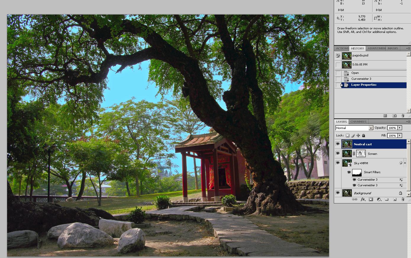

eransh10
Posts: 45
Postby eransh10 » Mon Nov 09, 2009 12:58 am
I loves the screen with lightness mask idea.
I also blurred the mask and used the layer mask for the smart filter (that was used to make the sky blue).
pagoda2-jpg-2
pagoda2-jpg-2 (270.98 KiB) Viewed 32303 times
Postby ggroess » Mon Nov 09, 2009 4:12 am
The sky has gone totally cyan...if you can go back into the sky mask layer and try out one of the sky pins in the hature folder you might like the results a bit better.
