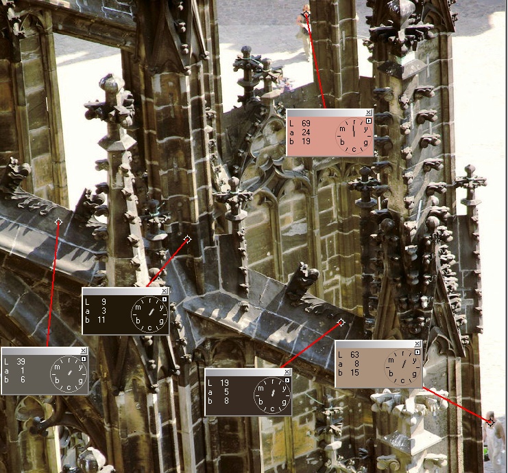

Jim,
Try out the .ACV curve I posted on your posted image. The highlight half of the L curve needs some help.
As for the color look at shot1. the person in the lower right is "ok" as far as skin tones go...not great but better than the person in the top of the frame. Using the hue clock see if you can adjust the skin tone of the top person to be in the 12:00 to 1:30 area. the length of the hand on the hue clock represents saturation. The longer the length of the hand the more saturated the color.
- shot1-jpg-95 (272.91 KiB) Viewed 32302 times

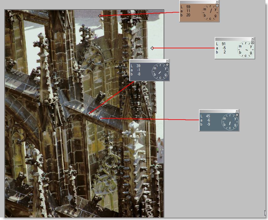

While the skin tones are better the blue has returned to the shadows...
See if you can find a neutral point somewhere that keeps the blue out of the shadows and does not mess up the skin tones...
It really is in there somewhere..there is not a single magic spot for this one...you just have to go fishing for it...If you have not seen the Honest Abe video you might want to watch it and see what I mean about fishing around for the neutral.
- screenshot002-jpg-74 (113.72 KiB) Viewed 32302 times
