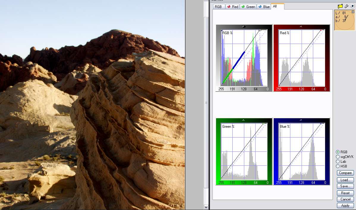

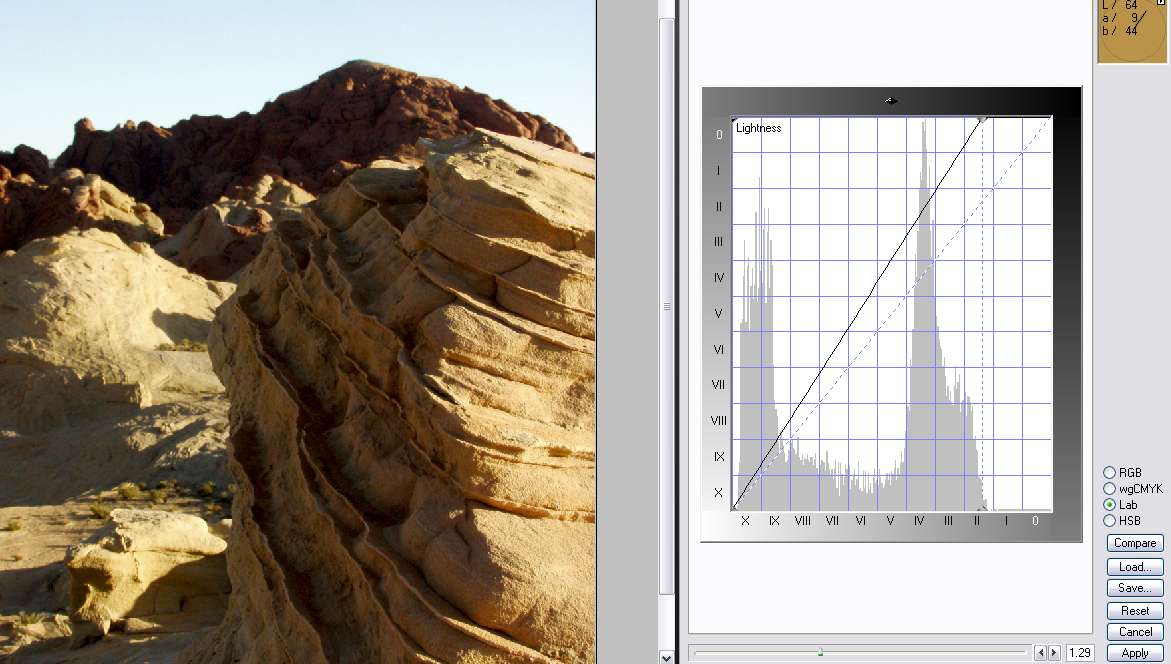

While in CM they are independent of each other not cumulative...Although that might be a nice feature...But you can make an adjustment in LAB then switch to RGB and try to make the same correction and decide which you like better...you can switch back and forth...it will keep the values you set until you apply one of the color spaces to your image.
So the work flow would be open the image in CM...Adjust in LAB....decide that you want to try RGB...Switch the radio button in CM to RGB and make a new correction...decide to go back to LAB....switch radio button...
Shot1 and Shot2 are both open in CM at the same time and I can switch between them to see which I like better...Whichever one I choose to apply is what gets written to the file.

- shot1-jpg-98 (91.74 KiB) Viewed 8483 times
- shot2-jpg-34 (105.87 KiB) Viewed 8483 times
