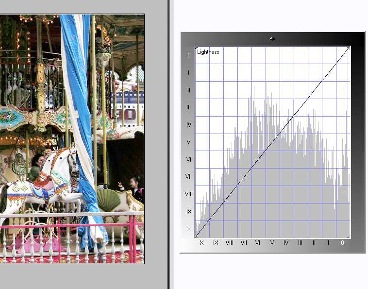

I started using the CM wizard in Lab . . . but then got carried away and forgot to log each step I used for this effort.  So sorry - I can't say exactly how I got here: I'll remember to use a notebook next time.
2007-02-12_122115-merrygoroundrg-jpg
2007-02-12_122115-merrygoroundrg-jpg (999 Bytes) Viewed 33921 times
Postby ggroess » Mon Dec 14, 2009 10:05 pm
So far so good....

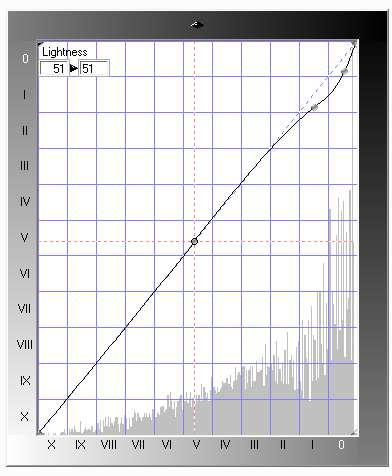

Try adding a small lizard tail to the shadow end of the curve as shown in shot1.jpg  This will open up the shadow end of the curve and not mess up the rest of the image...Try to boost the color a bit as well..you should do this in LAB so you don't add a color shift to the shadows...
shot1-jpg-99
shot1-jpg-99 (26.28 KiB) Viewed 33921 times

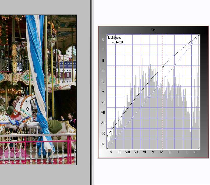

To fix this on your posted image adjust the highlight end of the L curve in lab and give the middle tones an adjustment. shot2.jpg

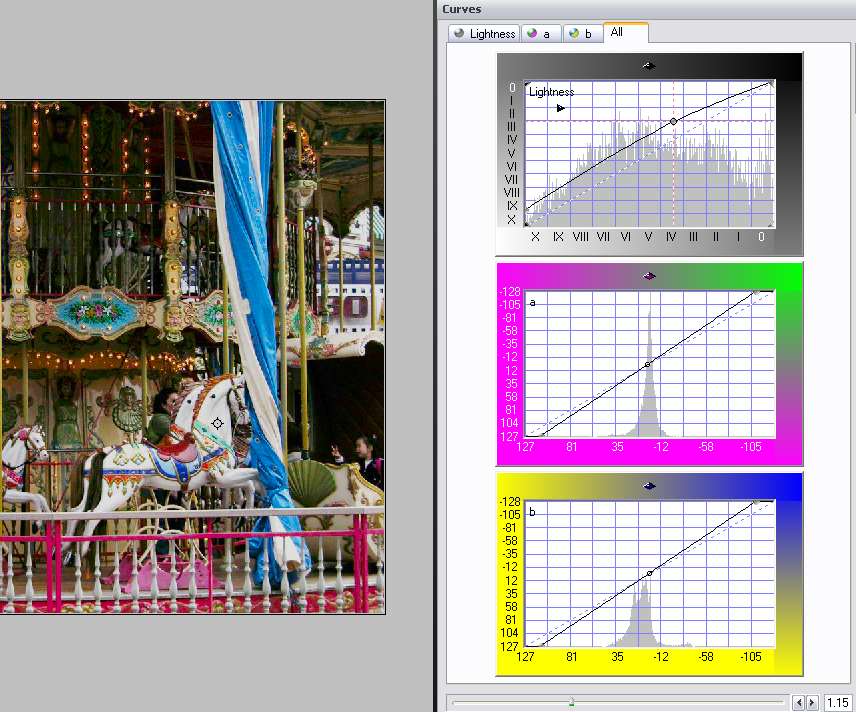

Finally add some saturation using the slider.  You will have to highlight the number and type the value to get 1.15 in the saturation slider dialog.  Shot3.jpg
Give it a try and see what happens...Good stuff so far...

shot2-jpg-33
shot2-jpg-33 (65.92 KiB) Viewed 33921 times
shot3-jpg-12
shot3-jpg-12 (99.48 KiB) Viewed 33921 times
