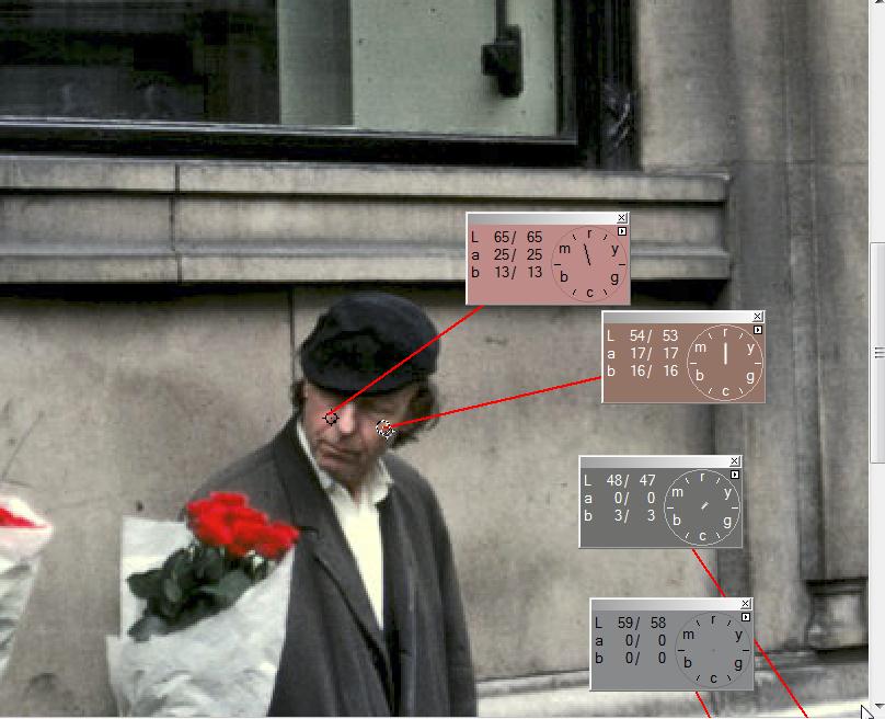

Richard,
the neutrals look good but the skin tones are not where they should be....this is also leaving the greens a bit "flat" see if you can get the skin tones into line and maybe that will help the greens just a bit...
The shadows are in good shape as well you can see reflection detail in the window...
