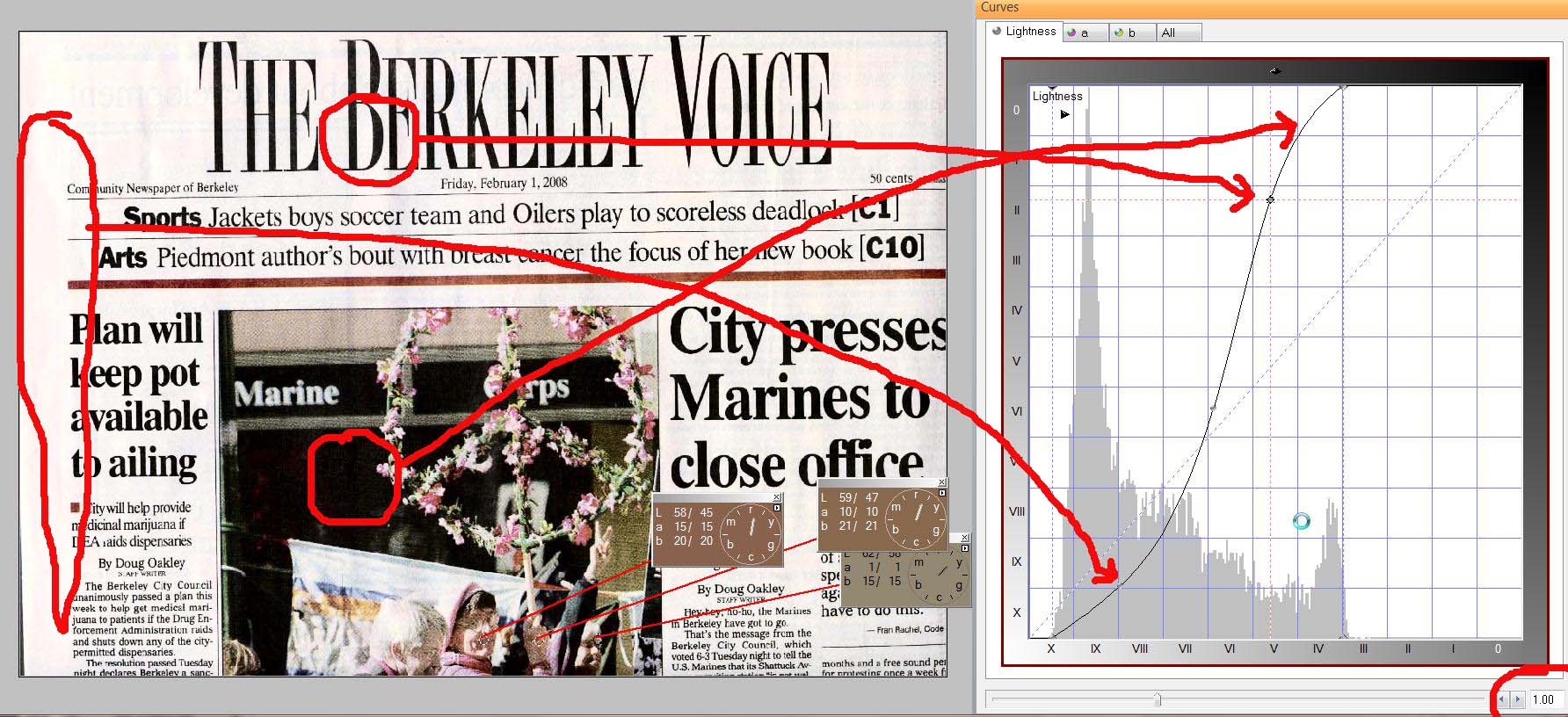

Instead of two curves that at times appear to be competing how about this....See attached shot.
This is one image where the histogram can help you a bit but not as much as the threshold adjustments. If you look at the image I have 3 areas I am most concerned about..the highlight details, the shadow details, and the dots in the picture.
The highlights I want to keep as much information in the image as I possibly can. Remember the prints you might have created will need as much highlight and shadow details as possible. I use the threshold to help me not clip the highlights.
Shadows I wanted them to be dark and saturated but not at the cost of the dots in the shadows of the image. making the s curve helps the shadows without hurting the image shadows too much...You certainly can argue that I did some damage there but I think the scaled down image does it more harm than I did.
The dots....I know I have to tkkep as many as possible in this image. Usually you want to be rid of them and I don't mind losing some here but when the dot loss = details in the image It means I want to keep them...I placed the hue clocks to check the skin tones and see if I needed an adjustment there but they look acceptable for this type of image.
I went on to saturate it a bit more by sliding the saturation slider up to 1.25 It helps the overall image....mine shows 1.00 because after the screen shot I changed my mind...
