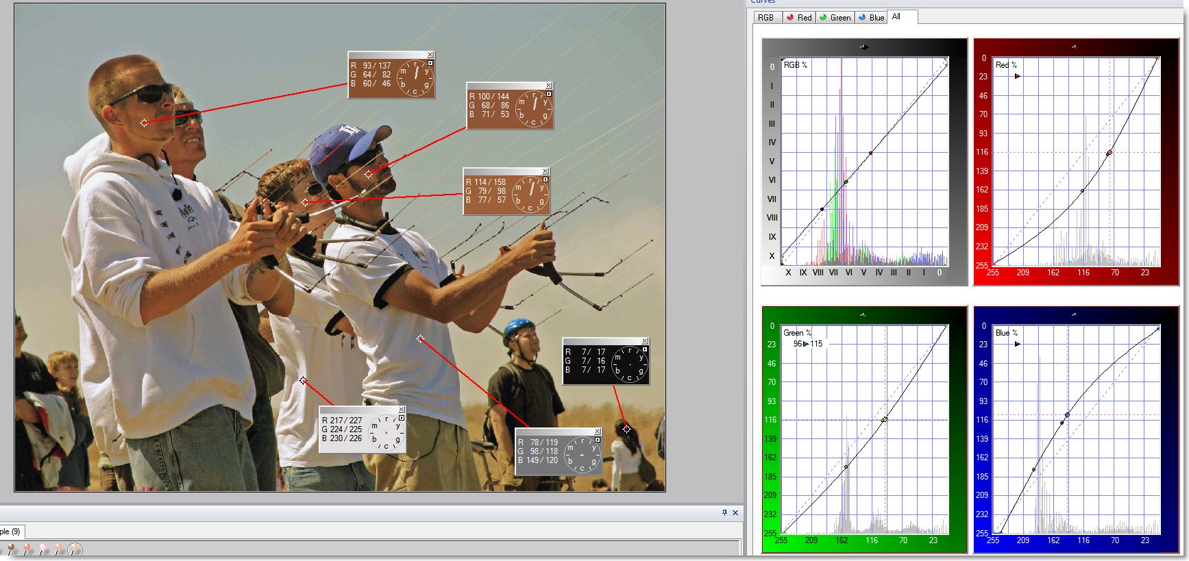

I took Richards correction and I made some changes as shown.
This is a modified version of something coming up: Color By the Numbers. BTN in Curvemeister can be an interesting process. Because of the lower resolution of the posted image there is a lot of noise in the picture.
But as you can see the image can be brought back quite a bit from the blue shadows. There is much more that can and should be done to this image..I am hoping some of you will post your versions so that others can see what is possible...
- screenshot001-jpg-100 (246.58 KiB) Viewed 6358 times
