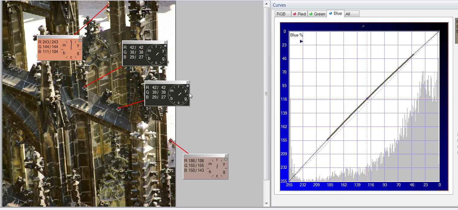

I first set a shadow, then used RGB to remove the colour cast and finally used Lab to make the colours look more vivid.
Kessi

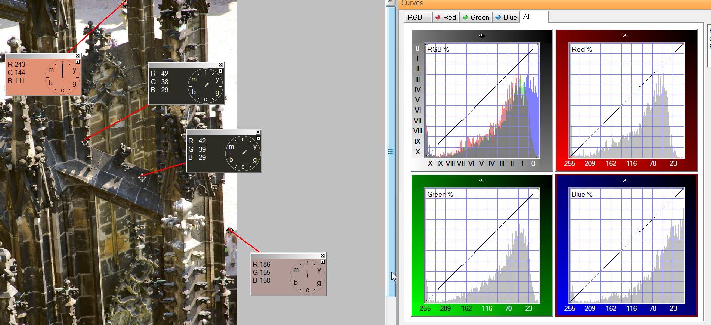

Postby ggroess » Sun Mar 28, 2010 5:04 pm
well handled..
The give away here is the skin tones.  You have managed the stones quite well and the only change would be to bump the middle of the blue curve as shown in shot 2.
This brings the skin tones of the people back into the 12:30 range...
Otherwise well done..

Postby kessi » Sun Mar 28, 2010 5:22 pm
I'll try that. The woman looks like she has serious sunburn.
