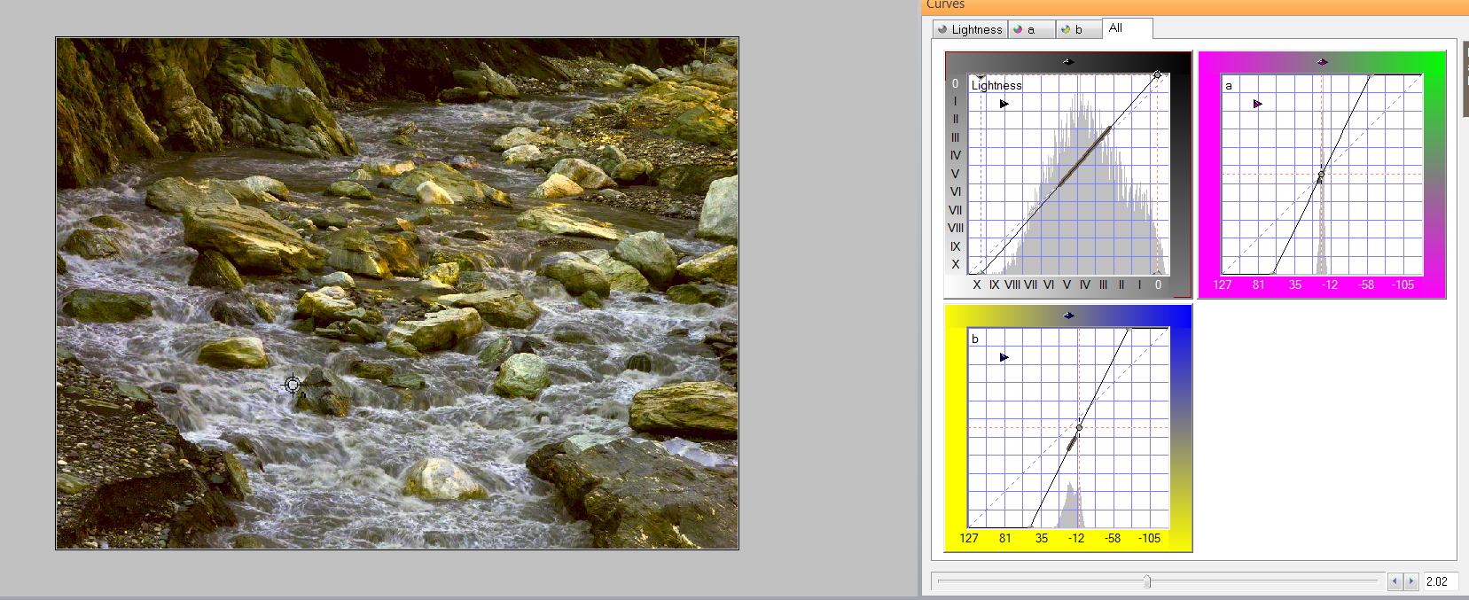

Corrected in Lab and then went out of Curvemeister. Did another run and changed only the b channel a bit.

Kessi,
This image has a very distinct cast. The trick is to find a reasonable neutral...Think of things in the image that are close to neutral than the rocks which can be any color at all in this image. Waterfalls / Whitewater "generally" have less of a color cast than the water that produces them. They are a fair choice for a neutral.
Take a look at the image and if you like apply the ACV file I have attached as well. I used you posted image as the starting point. You are pretty close to getting this...it is the extra little push you might be looking for...I like to add too much color to this image. you certainly do not have to add as much.
