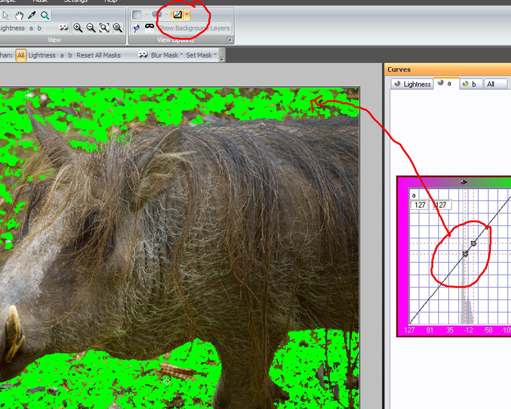

Try placing the mouse over the grass and looking at the A Channel curve in LAB. The "Color Worm" on the channel will show you where in the curve you need to adjust.  Set points above and below the area and see if you can adjust the grass without messing with the rest of the image.
The Curve highlighter is a tool we can cover in the class that helps you to see the areas you are working on.  See Shot1.  The areas highlighted are the ones between the two control points that are effected by any change to the curve.
shot1-jpg-86
shot1-jpg-86 (279.88 KiB) Viewed 13629 times
