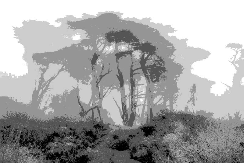

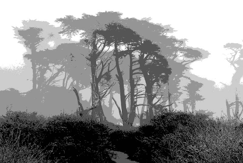

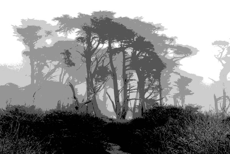

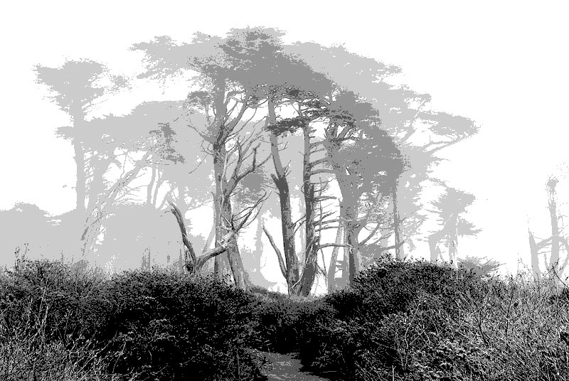

Let me throw a thought out for you all - this is an atmospheric image and of our 3 renditions it is interesting to see how the tones change the mood and perspective.
Here are the 4 images (with the original just processed by auto-levels) with all the detail removed and just 5 equal (tone) stops showing. I'm beginning to find this an interesting way to look at a photo to see how the composition hangs together.
Probably a daft idea, but just to give you something to think about!
- point-reyesoriginalautolevel5stops-jpg (81.66 KiB) Viewed 12505 times
- point-reyesganna5stops-jpg (148.13 KiB) Viewed 12505 times
- point-reyesgreg5stops-jpg (101.96 KiB) Viewed 12505 times
- point-reyeszog5stops-jpg (80.93 KiB) Viewed 12505 times

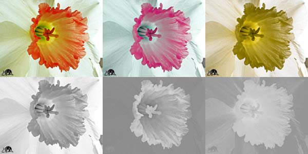

You will learn about the Lab colour space, which uses 3 channels, like the RGB colour space, but they hold different information
Here is an image showing the channels
- top row is Original, a & then b channels (in their own colours)
and the bottom row are the 3 channels L, a & b in grey as you will see them in photoshop.
Go search for Lab colour space on the web and have a wee read before the course starts - have fun
Chris
