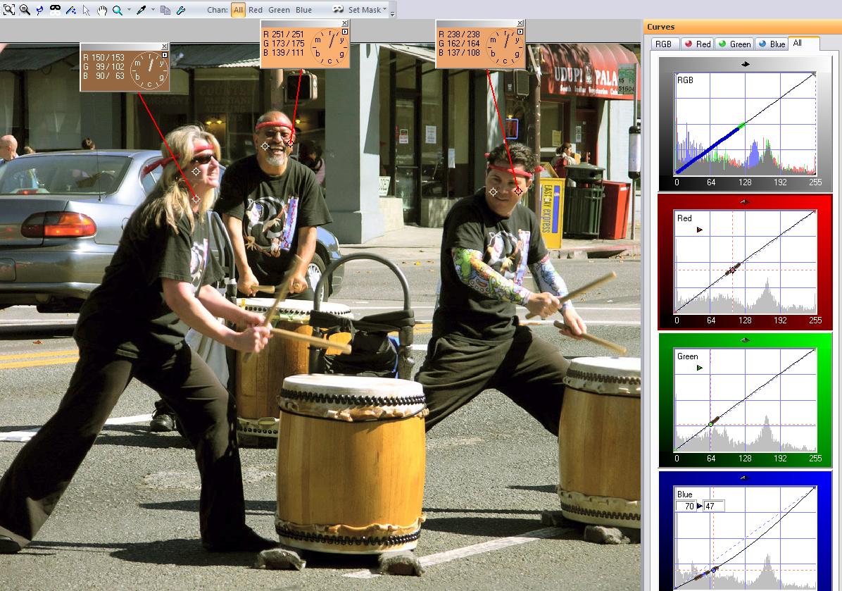

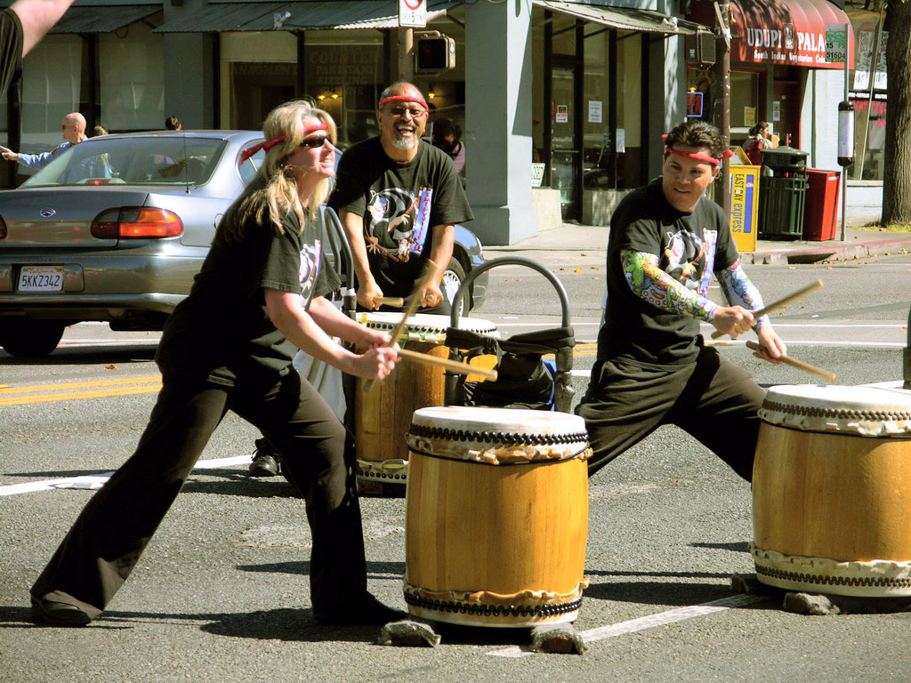

Postby kessi » Sun Mar 28, 2010 3:06 pm
My Corrections. I don't seem to get the hue clock pointers shorter.
Kessi
screenshot-berkely-drummers-corrections-jpg
screenshot-berkely-drummers-corrections-jpg (202.73 KiB) Viewed 30552 times
c1s3-example5-berkely-drummers_corrected-jpg
c1s3-example5-berkely-drummers_corrected-jpg (273.73 KiB) Viewed 30552 times
Postby ggroess » Sun Mar 28, 2010 5:00 pm
Ahh...shorter is not necessarily the goal.  When we talk about 12:30 on the hue clock we are talking about the direction of the hand it should fall to the right of 12:00 but not much farther to the right than what would be 1:00 to 1:30; if we were using the short hand on a real clock.
The length of the hand is the saturation of the color.  Shorter hands means less saturated and therfore closer to neutral.  not necessarily what we want in a skin tone...
