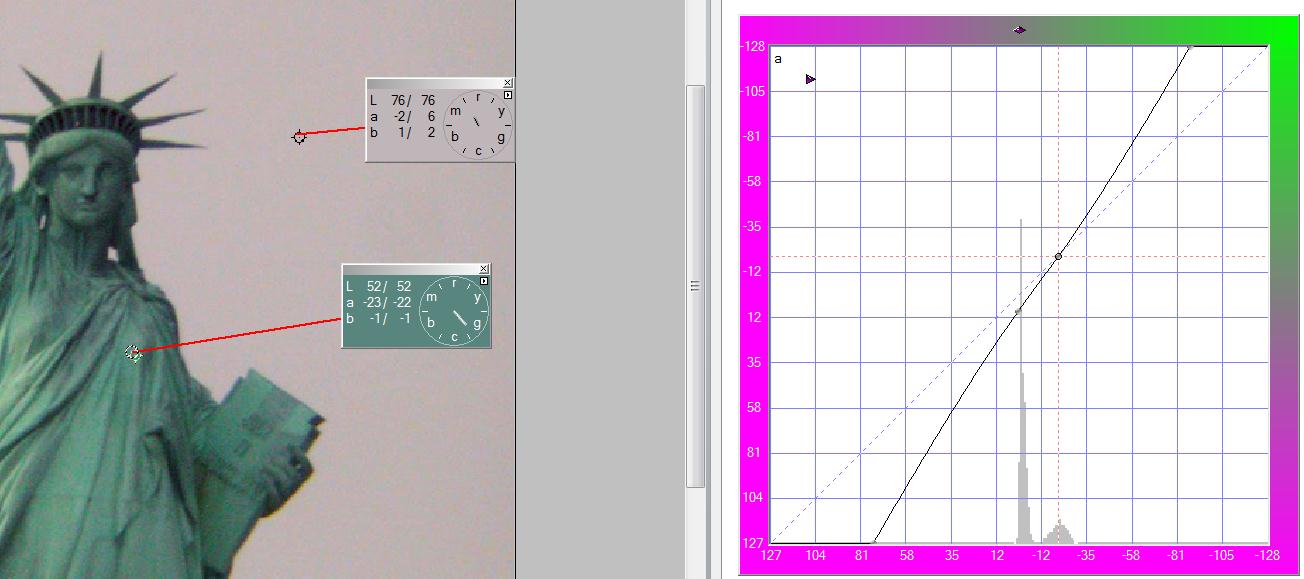

Postby ggroess » Sat Mar 13, 2010 10:15 pm
This is quite the subjective image...one does not quite what to do with the sky...I do know this though...Green sky is not as pleasant as a warm sky...
Your shadow and highlight were great, the lack of a neutral makes you work hard for the right color. People would  just would rather see neutral to warm rather than greenish.. . If you look at the slight bend in the A channel above the center of the grid you can see a small change makes a huge difference.
You are not that far off Kessi...
screenshot002-jpg-67
screenshot002-jpg-67 (85.66 KiB) Viewed 8503 times
