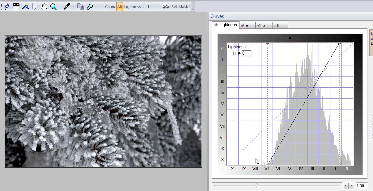

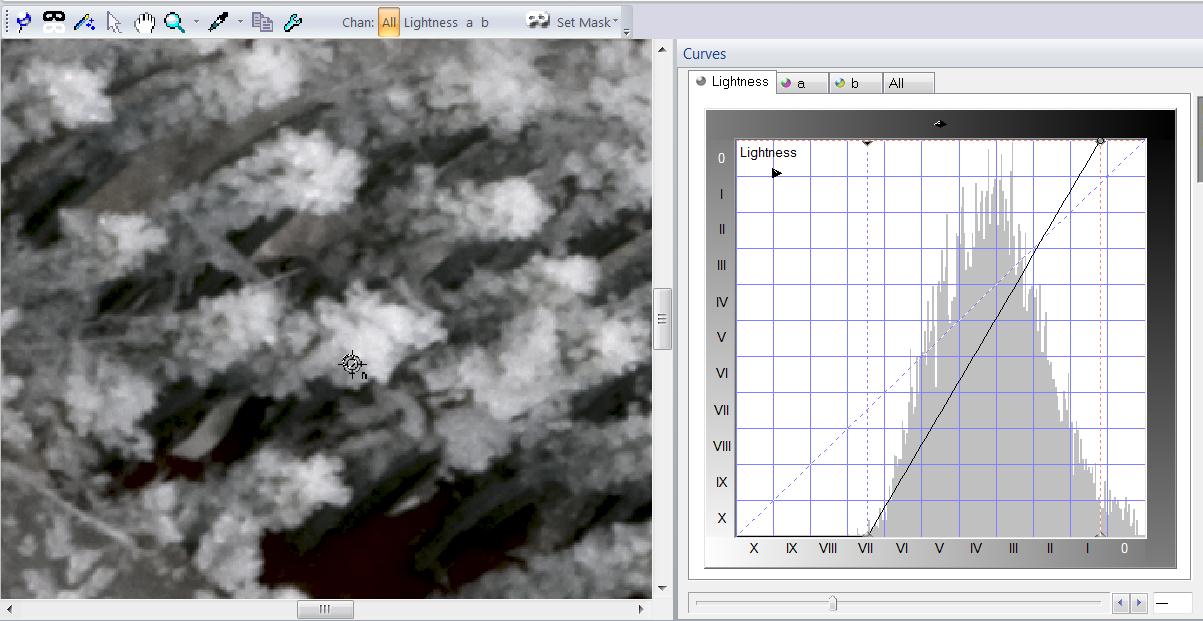

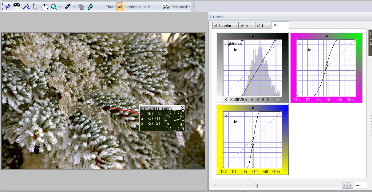

First things first Shadow/Highlight/Neutral in LAB. Shot2 / Shot3

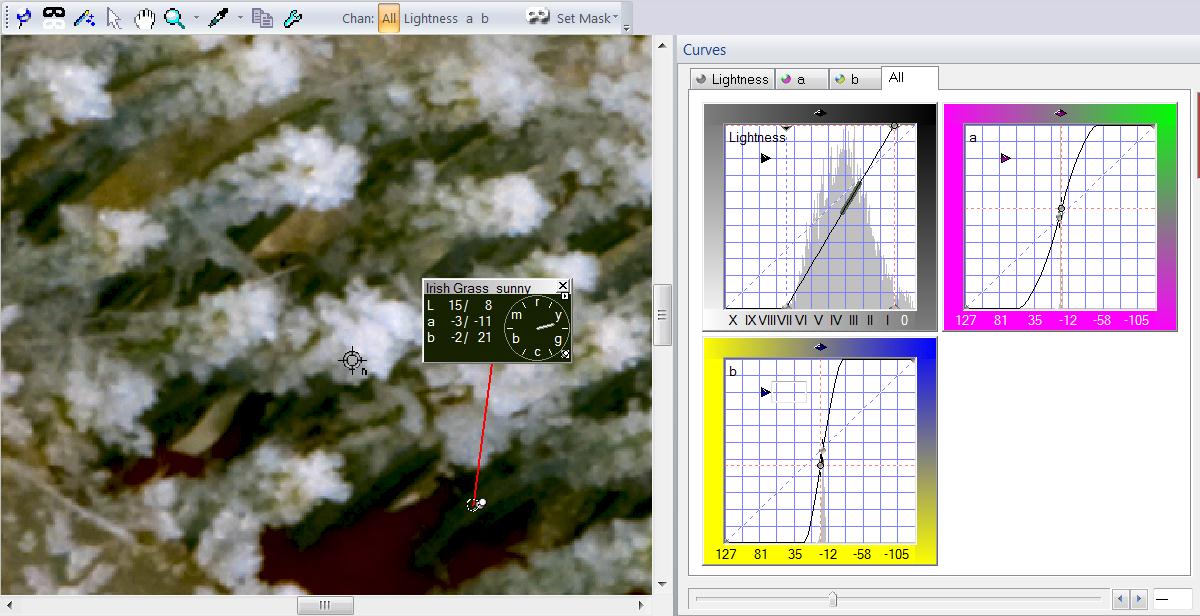

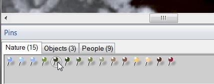

Next I choose the Irish Grass Pin from the pin Gallery because it was the closest to the color of the pine needles I wanted. Shot4
When I place the pin in the image by dragging it to the point I want the image changes quite a bit. Shot5
Notice that CM respects the neutral I pinned earlier. This will only work for 1 neutral in LAB but you can use 2-3 in RGB sometimes...That is a trial and error process...
Apply the correction and exit CM.

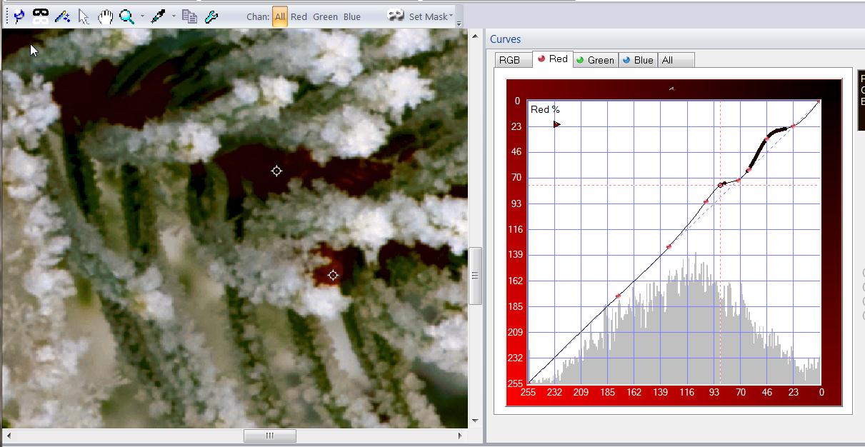

Now the red of the tree branches is too strong so I need to reduce it.

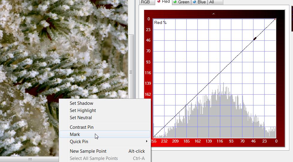

Open the Image in CM and use RGB mode.
for shot7:
I selected a spot on the branch that has the color I want to reduce and I right click. From the fly out menu I select "Mark" This creates a mark on the RGB curve that represents the values under the mouse. Switch to the red channel and notice the black spot where the mark is. This is the area of the curve I want to adjust.
To make the adjustment I have to pin the curve down so my changes do not cause the rest of the curve to whip around and flex too much.
In Shot 8 you can see the points I set so that the curve was adjusted only for the spots I wanted to adjust. After the first adjustment I chose another spot to reduce because there was more red in another part of the image.
Apply CM adjustments and exit CM.

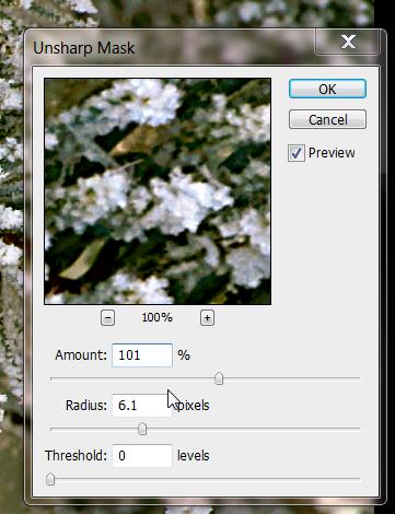

Shot 9 is the Un-Sharp Mask I applied to the image to sharpen. I did try a Highpass filter as well but in the end I chose the Un-Sharp for this image. I like the details better.
for shot7:
