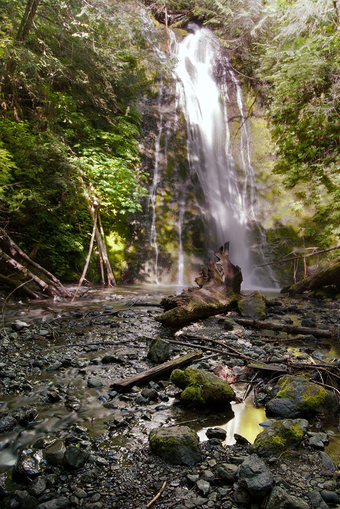

Lee,
Give this image a test fly...
Sorry for the quality...it is cobbled together fast from two images...both from the same spot just a different exposure for the falls...
Goals:  Make the foreground look less green and keep the waterfall as neutral as possible...Blown out parts exempted...
gjg_0077-jpg
gjg_0077-jpg (999 Bytes) Viewed 45807 times

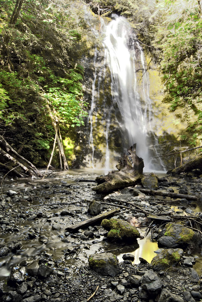

Postby mikemeister_admin » Mon Jul 26, 2010 2:31 am
Actually I've got one...GregM
gjg_0077-copy-2-jpg
gjg_0077-copy-2-jpg (293.85 KiB) Viewed 45807 times
Postby ggroess » Mon Jul 26, 2010 2:39 am
not too bad really...
How did you handle the magenta in the falls??
Postby mikemeister_admin » Mon Jul 26, 2010 3:06 am
Msnap was first step,then sharpening,last step acv file.GregM
7/26 forgot there was a middle step where I selected the waterfall and reduced brightness.GJM
gjg-0077-jpg
gjg-0077-jpg (246.25 KiB) Viewed 45807 times
gjg_0077-copy-rgb-acv
(66 Bytes) Downloaded 1438 times

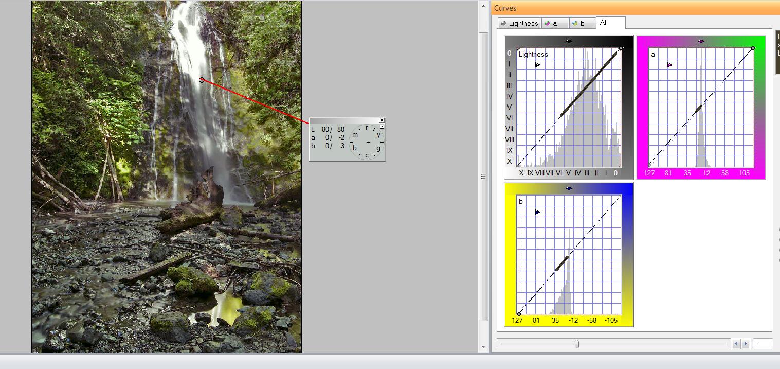

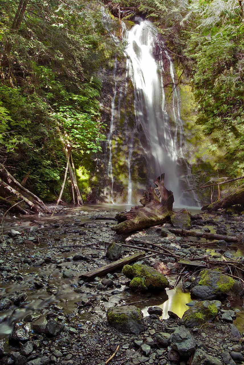

Postby leeharper_admin » Mon Jul 26, 2010 11:44 am
I've had a go at this too...
I think that this is the first image that I've been able to correct with a single curve!
Before I opened CurveMeister I applied Apple RGB to the file (Edit > Apply Profile), before switching it into sRGB (Edit > Convert to Profile). I chose Apple RGB because I wanted a lighter, and more saturated image.
My Lab curves fixed everything - except for the greenery, which they wreaked (as you'll see if you apply the curve). To get around this I converted the file into Lab (in Photoshop), and used the Blend If sliders to bring back the original greens:
  • Blend If: L > This Layer: 0 - 205/234
  • Blend If: a > Underlying Layer: 112/115 - 255
I didn't do much else to the file - a Green channel luminosity blend, and a touch of sharpening, but I used a light touch.
gjg_0077_lh-jpg
gjg_0077_lh-jpg (276.26 KiB) Viewed 45807 times
lab_lh-acv
(74 Bytes) Downloaded 1448 times

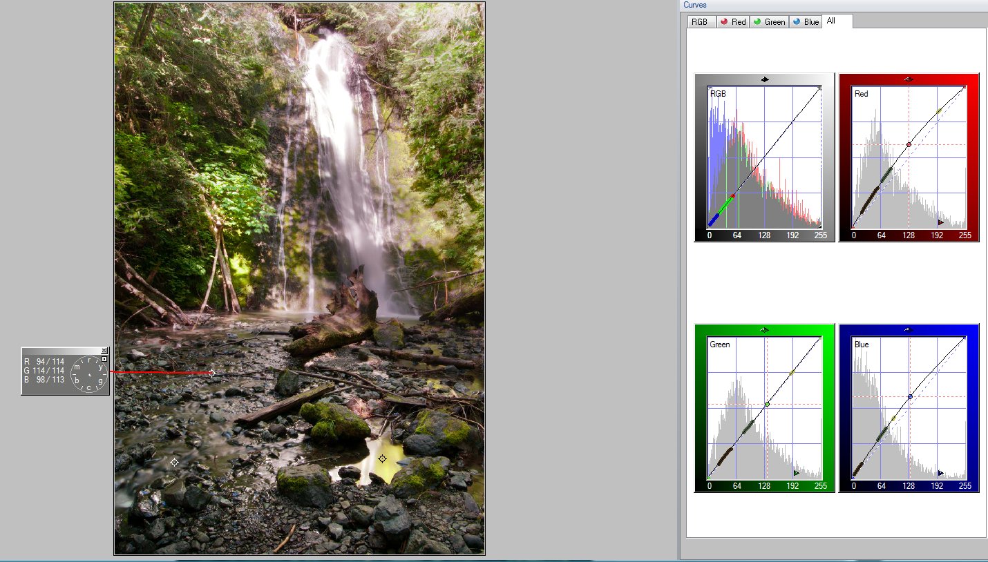

Postby imported_BoydMac » Mon Jul 26, 2010 4:47 pm
Here's my attempt.  I just ran it through CM and set two neutrals, one on the rocks and one on the whitewater in the falls, in the RGB mode then through Focus Magic.
waaterfall-adj-jpg
waaterfall-adj-jpg (264.46 KiB) Viewed 45807 times
Postby ggroess » Mon Jul 26, 2010 9:11 pm
Boyd...
Very nice overall...try the very subtle correction in My posted ACV.
If it helps great if not...try to reduce the magenta a bit and see if the overall color looks better.
screenshot001-jpg-70
screenshot001-jpg-70 (202.91 KiB) Viewed 45807 times
waaterfall-adj-jpg-lab_gg-acv
(54 Bytes) Downloaded 1293 times
