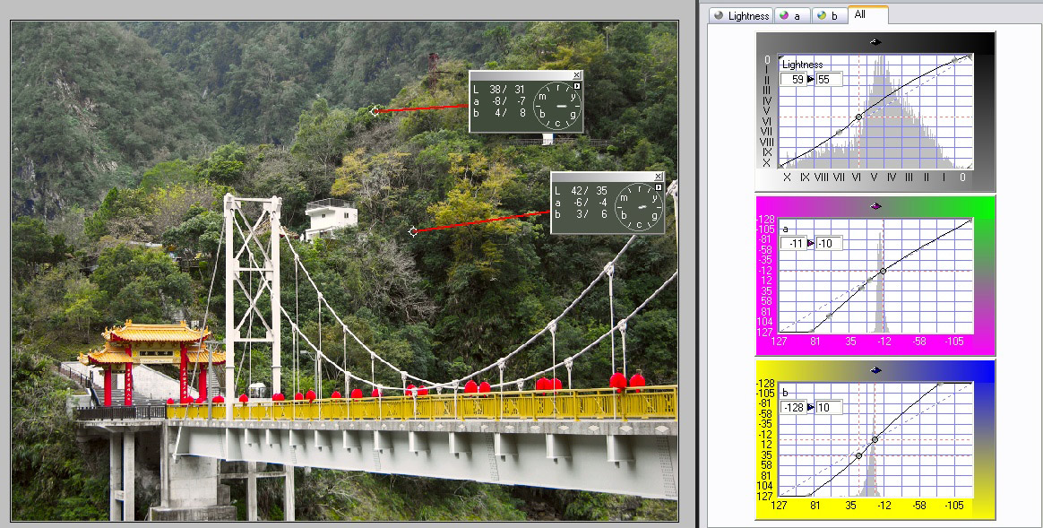

Ok...Here is a under 5 minute correction for this image.
Step 1 Drive the greens apart to add variation and saturation. Use some manually placed control points to adjust both the A and B curves Make sure the greens are on the green side of yellow not the yellow side of green on the hue clock. We will be accepting that the shadow colors may have some greener greens but they are acceptable for now.
This is where you appear to hurt the image for a few minutes while you accomplish 1 goal...The greens. Step 1 ACV file
Step 2 Manage the color cast. The bridge actually becomes more green than cyan after step 1 and an RGB correction is all that you need to get the color cast out. Step 2 ACV.
That about all I would do in CM...

Thanks Greg ;)
I'm not in Boot Camp right now, so I can't check out your curves at present. I like the look of the foliage though.
I just wanted to ask - you say that the hue clock on the greens should be closer to green than to yellow. Elsewhere on the course the advice is that the hue clock should be closer to yellow than to green. In one of the videos Mike says "the closer to yellow the better". Is your advice regarding the hue clock position specific to this image, or have I misinterpreted what has been said about this previously? I've always thought that greenery ought to be weighted towards green...
So a greenish yellow is better than a yellowish green....
