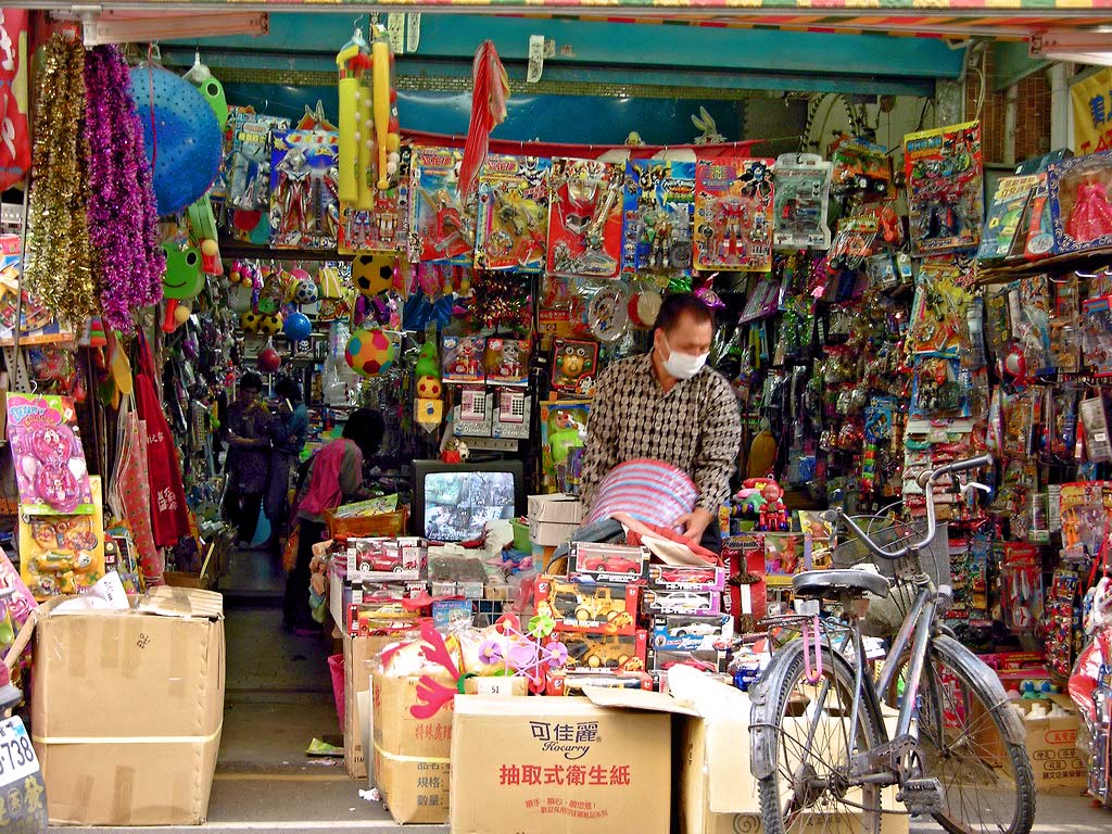

This correction is pretty much in accordance with the instructions - though I set shadow, highlight and neutral first (and checked the skin tone).
In my second pass, I used the L channel (inverted, and curved) to mask my saturation boost. I took the slider to 3.30 - probably the furthest I've ever pushed it! Having applied the saturation boost, I decided that switching that layer's blending mode to 'Saturation' pulled back some detail in the blue ball (by the tinsel).
Rather than try to work on the luminosity of the image with a curve, I used the Shadow/Highlight command - I didn't think that I would have had enough rope to work with a curve.

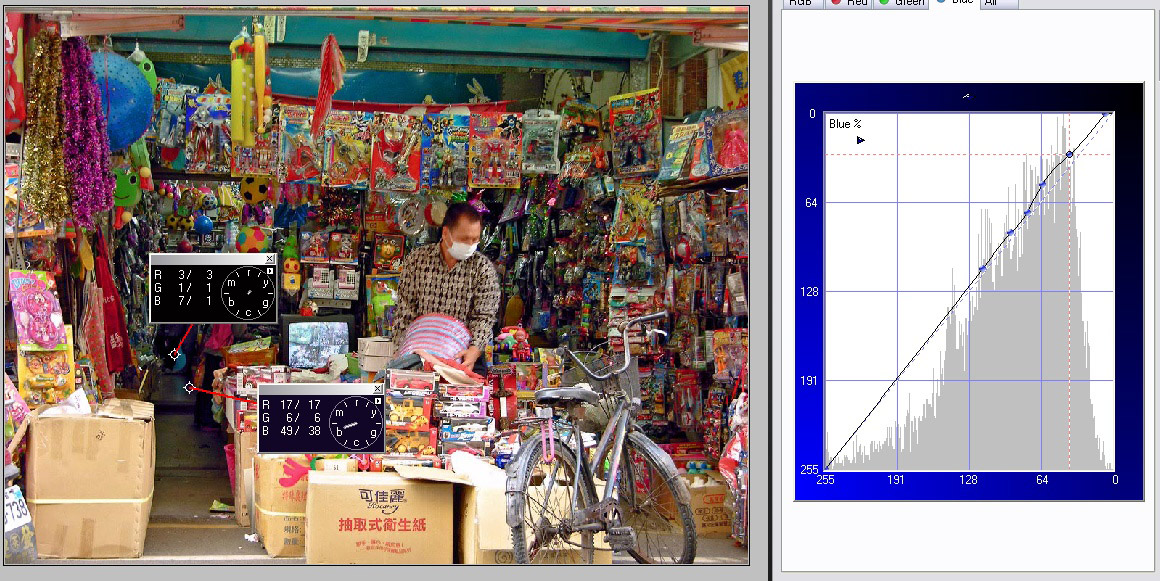

This is one image that really can get you confused about what you are trying to do...
Remember that when you inject color into the shadows you also can introduce a Cast...in your case a blue one...Since RGB is awesome at color cast related to brightness...I made a slight correction to the Blue Channel.

- shot1-jpg-69 (297.62 KiB) Viewed 42317 times
Thanks for the tip-off - I hadn't noticed the blue cast until you pointed it out, but it's quite severe - I've taken it out now (thanks for the screenshot), and the image looks much better.
I think that I'm reaching a stage where I can visually identify uniform casts, but casts that are specific to a particular tonal range are still not really on my radar. I think that some exercises related to nonuniform casts would be great in the CM201 course. Of course, nonuniform casts have been mentioned during this 101 course, but I've not been sufficiently beaten over the head with them to make me routinely check for them ;).
It's strange, because I do check that lighter neutrals are actually neutral - I must have a mental block with shadows...

- wk5_ex6_lh_v2-jpg (236.28 KiB) Viewed 42317 times
We all tend to accept colors in the shadows that we can justify as being there. Reflections are a good example...we all accept that the color is there because it is reflected in the scene. Recognizing that they do not belong is a learned habit...
