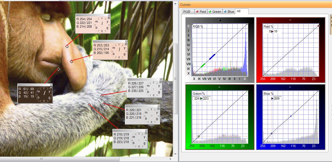

Lee,
The RGB is looking pretty good some very small changes...
Watch out for impossible colors like blue or green fur. See screen shot.
The skin Pin will make the skin look good but you have to check for the other faults as well.
I am not posting an ACV since the changes are easily managed.
- screenshot001-jpg-73 (195.95 KiB) Viewed 11333 times

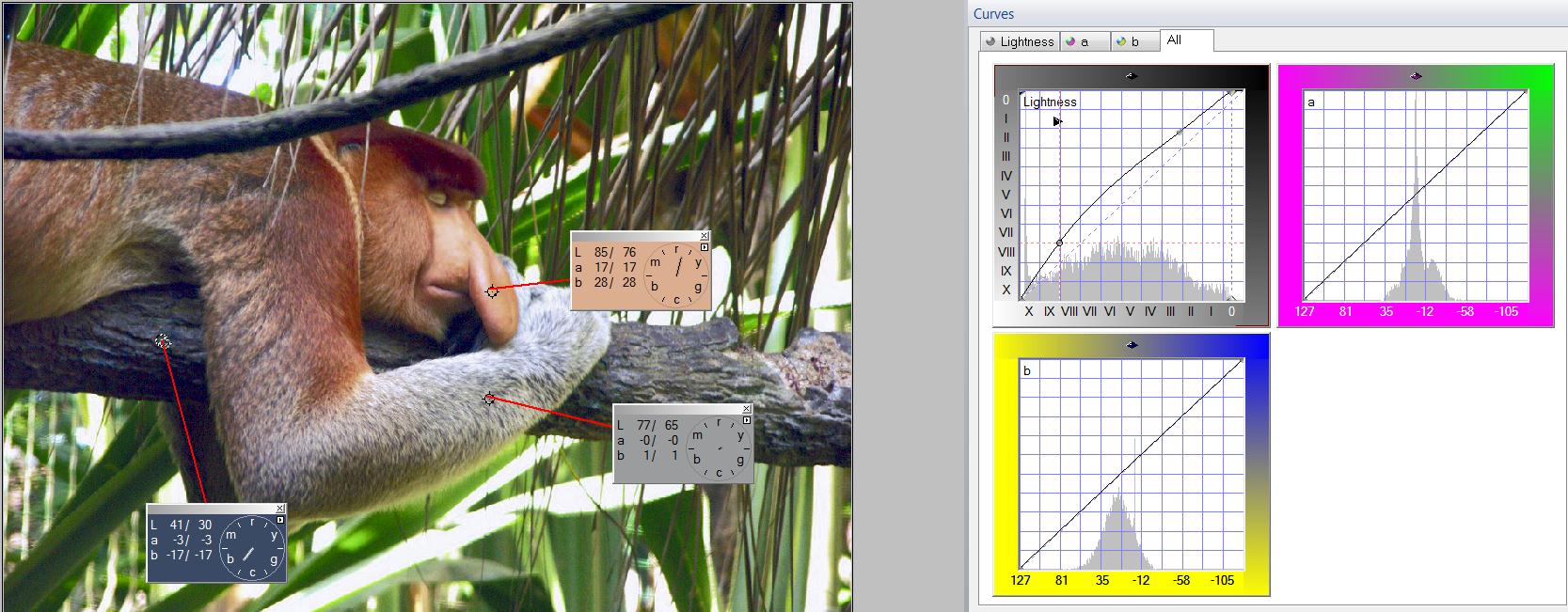

I didn't find fixing the green and blue patches of fur particularly easy. I applied some small moves in RGB that made the animal's arm look better, but messed up the darker areas of fur. I got around this by masking with the Blue channel. This made the fur look better, but I couldn't address the blue tree bark with those curves, so I decided that I might have more luck in Lab.
It was easier in Lab to address the fur and the tree bark with the same curves, as the separation was between saturated and less saturated areas, rather than by brightness range, and this gave me a greater sense of control.
Personally, I like the previous version more - this one feels more monochromatic. I found it hard to keep things 'By the Numbers' and keep the image looking interesting. I think at this stage I'm still lacking the knowledge to be able to do something good with this one...
