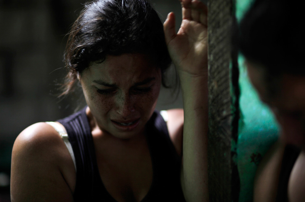

I've found three examples of the kinds of skintone correction that I generally struggle with. I have added copyright/attribution information into the image metadata where appropriate.
The first was an image from Boston Globe's Big Picture website (www.boston.com/bigpicture). I'm not a photographer, so I usually work on other peoples' images, and sometimes - just for practice - I try my hand at some of the images that are published on The Big Picture. This first example is a case where the lighting is quite unusual. Sometimes at work I shoot the Costume department's summer show, which is usually held at a local theatre, under heavily gelled lights. It would be really good to know how to deal with skin tones that are being affected by strongly coloured lighting.
- danielleclair-jpg (123.56 KiB) Viewed 27976 times

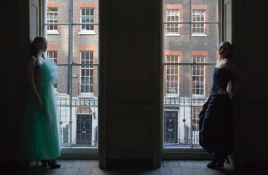

The second example again is not one of my images - it was taken by the photography tutor here. I'd mentioned to him that I'd be happy to fix up any pictures that he was having trouble with, and he gave me this!
The model on the right-hand-side seems to be just about well enough lit to be able to use the skin tone pins, but the one on the left is more-or-less completely in shadow. Supposing that we were just looking at the model on the left, and the other girl wasn't in the shot, how should something like this be approached?

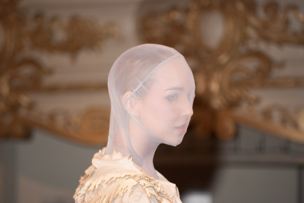

This last image is one of mine from that fashion shoot that I told you about. I'm not sure how difficult something like this would be to correct. The designer of this collection had made these headpieces out of netting, which have the effect of desaturating the skin tone (and assuming that the netting is not completely neutral would also slightly change the hue of the skin).
I suppose that this kind of problem would be a big headache for wedding photographers (who could also run into the problem of non-neutral veils). I guess that the question I'm really asking with this image is if you can't correct the skin tone as if it was unobstructed, how far towards natural should you go?

The other skin tone related question that I have relates to diversity in skin tones. By this I'm referring both to the difference between Caucasian and Asian skin (as an example), and also to the various skin tones within a population (i.e., caucasian skin is not of one uniform tone - there are tans to consider amongst other things).
These questions make me wary of the Hue Clock recommendation of aiming for hues between 12 and 1pm. I'm sure that doing this is the right thing to do, but I wonder where exactly between 12 and 1 should I be aiming for given a particular ethnicity?
I've read CMYK recommendations in Dan's book, and his recipes do differentiate between ethnicity. The hue clock recommendation seems too general.

Re: Fashion Shoot...

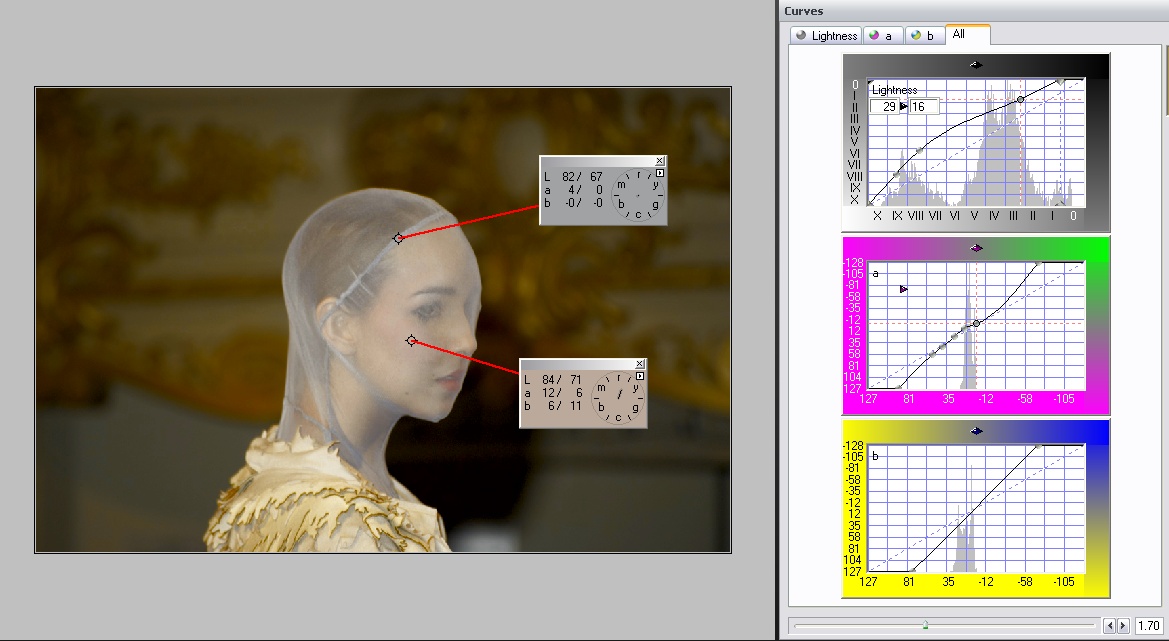

Lee this one is kind of subjective...The model obviously has makeup under the netting...so I would use the general rule of skin tones between 12 and 1.
The netting can be made to be neutral as shown. It actually improved the overall image when I did that. This image is less of a struggle when you "settle" for some assumptions...
I was not there to see the gown so I settled for a more golden hue in the fabric. I kept the skin reasonable...and I added some contrast in the netted area so that the face stood out more.
Apply my ACV to your posted image and take a look.
