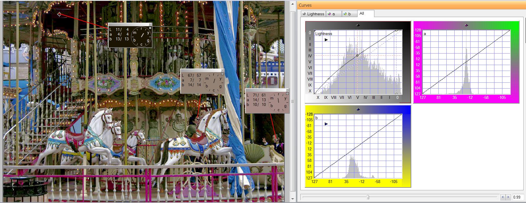

Lee,
I have to be careful here because you really have opened up this image. I think for the number of times I have seen people struggle with this that have you certainly have pulled much more out that I would expect. Having said that and please take it as a complement...I have to say that I think it is too open...not by much but by enough that It has made me want to comment.
OK...All that said
If you apply the curve I have attached and look at a few specific areas of the image I think you will see that you have lost something important here...
1) The necks of the horses; The information is there but they lack shape. I started to take this into CMYK to just add some K to the image but like you I found the CMYK to be tough... more on that later...I really ended up using the next best thing for shape and tonality...the L channel in LAB. If you look at the hue clocks I have set you will see changes are modest but yet the effect is strong.
2) The deep shadow on the top of the carousel...This comes down for me as a "significant details" problem. What I mean by that is it is sometimes good to have areas of the image with little or low detail. the goal for this image was to open the shadows and you certainly did do that but if you expand the area you allow to be darker by say 2-6 points... you can retain the shape of the image and keep some of the visual interest and contrast; It also helps the overall color and tone of the image.
3) Lastly the skin tone on the child is too red. If you lift the very end of the A curve in LAB you can push that skin tone into a better spot without messing up the color too much. You can also fix this in RGB.
Overall you made a vast improvement on the image; I get the feeling you were not entirely happy with some of the choices you had to make. This image is a good example of compromise there is only so much you can squeeze out of it at the resolution we have to work with...
- exercise1_lh-jpg-labgg-acv
- (62 Bytes) Downloaded 722 times
- screenshot001-jpg-76 (267.75 KiB) Viewed 10931 times

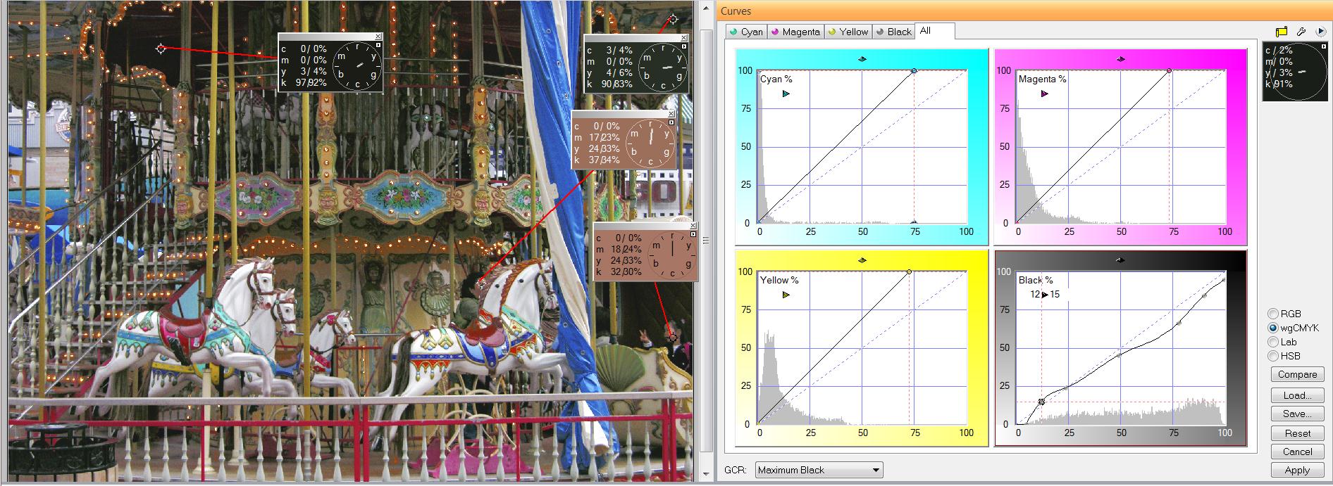

And now for the CMYK...
I think the quarter tones are the hardest part of this image. To begin with the image needs to be opened up more than I would do using just curves alone. To make faster work of this I copied the background and switched the layer mode to screen. I did this 3 more times before I went into the CM process. I could of also used the shadow highlight adjustment in PS but sometimes I just whack an image with a hammer....
Then I opened in CM and used CMYK as shown. As you can see the K channel is really the problem it requires the most adjustment...I think I even went too far in my example. The color channels are a straight shift of the shadow ends of the curve to add some color contrast and saturation. Each channel was adjusted to the same point then individual channels were adjusted. I did not check a neutral and did this by eye...I spent less time on this than I did writing this response...I would probably take the image back into CM and do a simple LAB pass to fix any problems at this point.
So...to take this all the way back to your original question...it can be adjusted in CMYK but you need to be in a better starting point before you go to the curves.
- 2007-02-12_122115-jpg-wgcmyk-acv
- (74 Bytes) Downloaded 732 times
- screenshot002-jpg-56 (270.54 KiB) Viewed 10931 times
