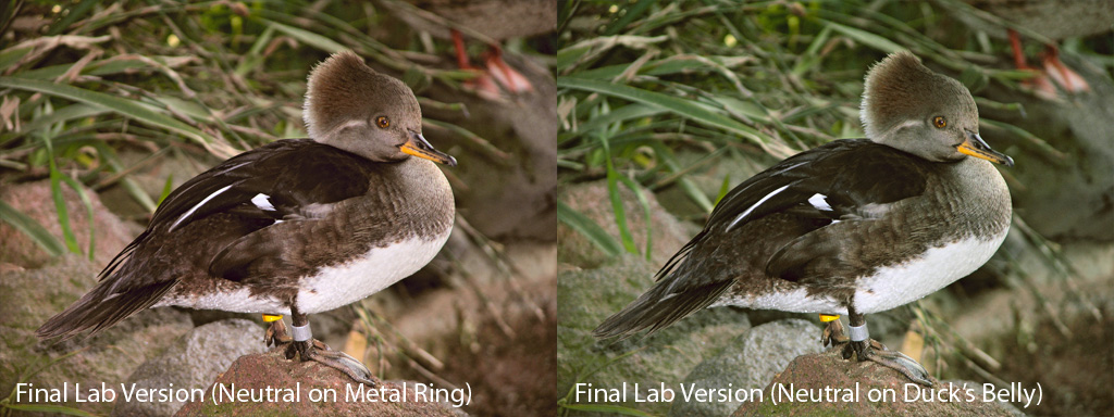

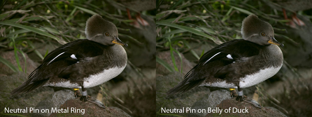

My initial decision (having set endpoints) was where should I set the neutral point. Lab_NeutralPinLocation.jpg demonstrates the effect of moving it around. The image on the left used the metal ring around the duck's foot; the image on the right used the feathers on the underside of the duck. I felt that using the metal ring made the image too warm (and I did not trust it to be completely neutral, because I thought that it could be contaminated by the sky reflecting from the water).

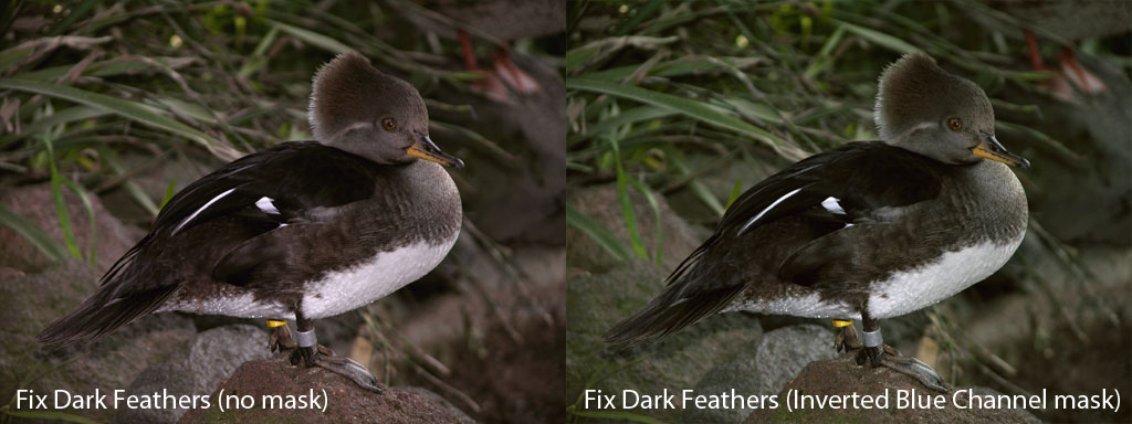

In my Lab correction, I found that my neutral pin had made the dark feathers slightly green (-3/-4 in the A channel). I moved the endpoints of the A and B channels to try to correct this. Unmasked, this adjustment made the whole image too red (Lab_FixFeathers.jpg).

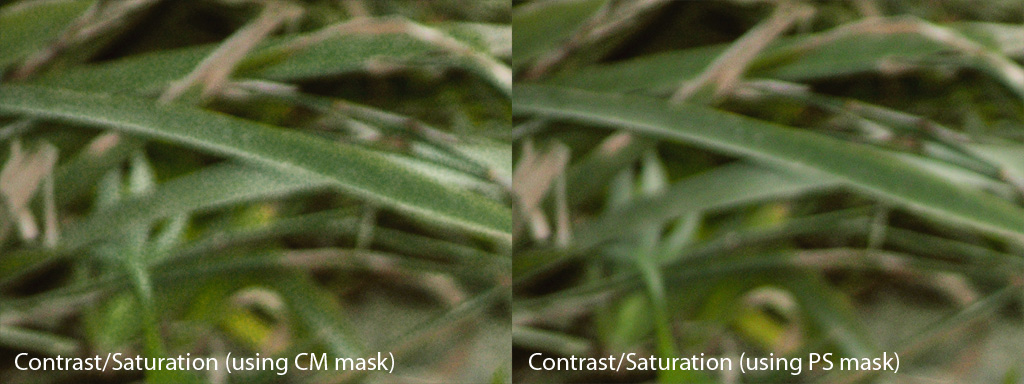

The final adjustment that I want to mention in this post relates to adjusments I made to improve contrast and colour saturation. I did not want these adjustments to be applied as strongly to the greenery as I did to the duck, so I used a curved A channel mask to protect the greenery from the adjustments. MaskComparison.jpg shows the difference between generating the mask in CurveMeister versus generating it in Photoshop. The effect of the CM mask is shown on the left; the effect of the PS mask is on the right. As you can see, the mask generated in Photoshop is much smoother - thanks to the improved blurring options in PS.

- lab_neutralpinlocation-jpg (80.46 KiB) Viewed 10812 times
- lab_fixfeathers-jpg (81.45 KiB) Viewed 10812 times
- maskcomparison-jpg (150.71 KiB) Viewed 10812 times

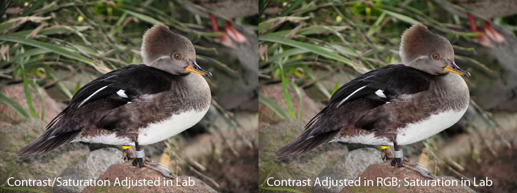

Having decided that the Shadow, Highlight, and Neutral pins were more effective in RGB, I then needed to adjust the contrast in the image and boost the saturation.
(The neutral point adjustment worked so well in RGB that the duck's dark feathers did not require further adjustment).
I tried two approaches (see ContrastSaturation.jpg, attached): firstly, a L channel curve followed by a move of the saturation slider; secondly, a RGB master curve adjustment, followed separately by a Lab saturation slider adjustment.
Overall, I prefer the second approach. Most of the duck's feathers look better with the L channel curve, but the image looks more three-dimensional in the RGB version - and consequently, there is a greater feeling of openness in the image. I also prefer the colour (although I may have simply moved the saturation slider a bit further on the second attempt).

- contrastsaturation-jpg (174.48 KiB) Viewed 10812 times

Both of your corrections are really well done. One of the topics I touch on often in the class is color saturation. One of the trade offs for LAB is a loss of saturation when you curve the L channel. This is the primary reason for the Saturation slider. The secondary reason for the slider is that in PS when you boost the A and B curves you have to fiddle around a bit to make sure they are equal. In CM the saturation slider moves both curve together the exact same amount; you can then boost the separate channels as needed.
As you have worked through the neutral problem; I see that you are doing a solid comparison between LAB and RGB; in theory they should be the same and based on the same neutral selection. In fact RGB usually wins for color until you add back some saturation in LAB. It looked to me that you were comparing the images by color space and not neutral point.

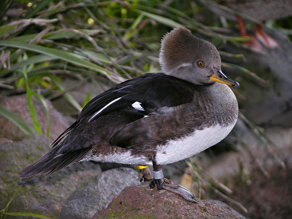

This was background layer set to screen,reeled in with the acv file.I've always had trouble with a neutral on the metal band so I used a rock over at 3 oclock with a=-0,b=-0 in Lab as a neutral.GregM
- 2007-01-23_145313-duck-copy-jpg (281.38 KiB) Viewed 10812 times
