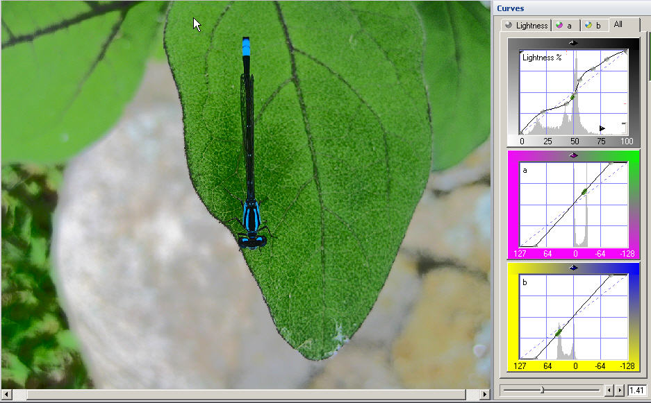

Postby Chris Nicola » Fri Jun 11, 2010 2:13 pm
Another interesting challenge which was not so easy as it first looked! I did the main tweaking in lab to increase the saturation and improve detail in the leaf while not darkening the insect too much and darkening the light coloured background.  I also tried to give the leaf a translucent surreal look. I added a bit of red in rgb to warm the tone. The picture can be improved by cropping.  Thanks for letting me have a go, I enjoyed the challenge!
Kind Regards
Chris
