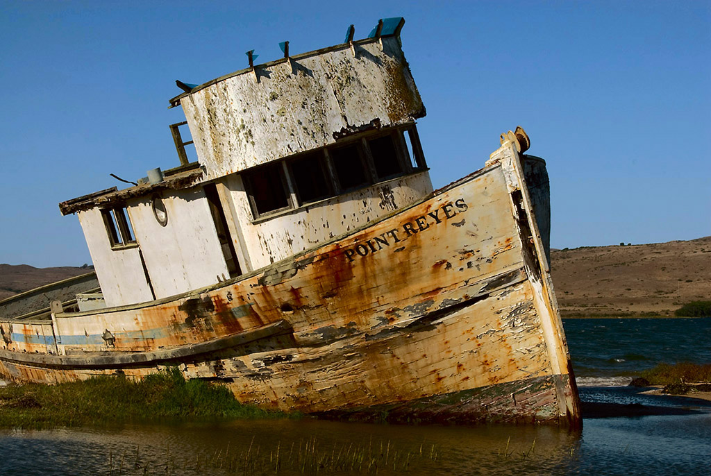

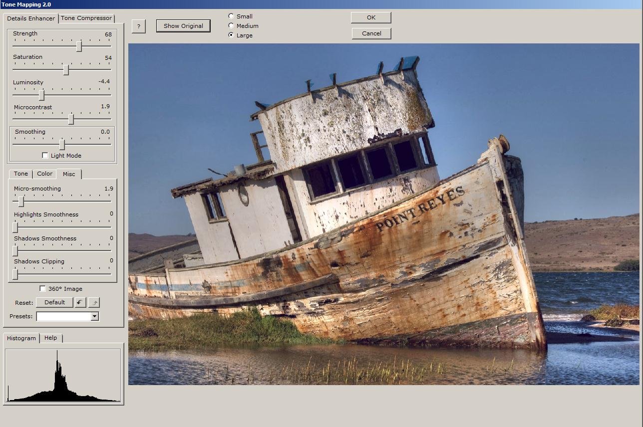

Well here is my first attempt. I just set the highlite, black point and neutral. I tried other things but was not successful and further improving the image. I wanted to bring out the grass more and the water but could not find settings that didn't do more damage than good. Because you mentioned keeping the texture I thought of a microcontrast adjustment that is available in Photomatrix - another program that I don't know how to use - so I gave it a try and got the second example. Somehow it brought out the grass and water but it also added a magenta cast to the shadow detail in the cockpit window. The only reason I mention this diversion is that I'm sure CM can give me the grass and water effects and would like to know how. - Boyd

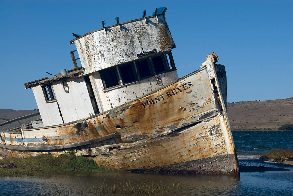

Here's my attemt. Unfortunately my "pins" function in CM does not work.(Already written to Mike) I am not sure about the colour of the vessel, but used the white foam as a neutral and then the colour of the sky and of the grass appear to be within OK range.

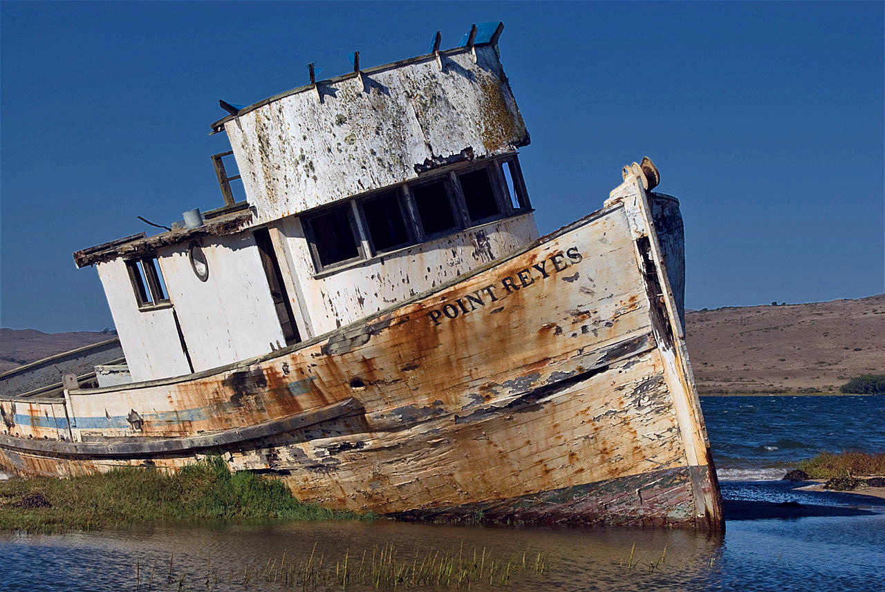

For the boat I wanted red rust,some bleached white paint spots,green grass and blue skies.GregM
1 shaped the lightness line in Lab,little color boost
2 boost to a channel for rust,less boost to b
3 edge sharpening action to get line drawing of boat
4 touch up in RGB,dial back yellow and magenta

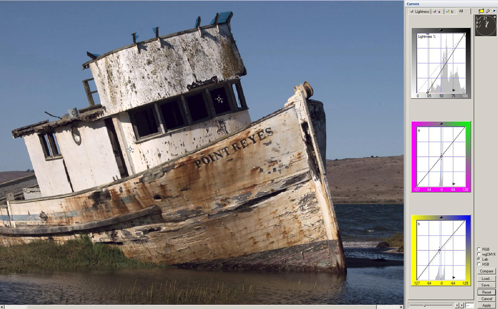

A rethink of the original image.I wanted the advantages of shadow/highlights in CS4,but to stay in curveM.Also,how different are the colors of the deckhouse and the pilothouse,pure white and very light grey?First time around I tried to get a neutral from the deck structures but wasn't happy with result.GregM
1 in HSB I did a threshold for brightness,then located the deckhouses along the line,last spike in histogram to right,then pinned the area to the left and below,then a bit more of a boost to the houses.
2 in LabI put a neutral (no shadow or hilight)just below the first window of the pilothouse.Chris Nicola was able to get neutrals on these houses.Very slight saturation boost.
3 sharpening as above
Image2. as per Greg's suggestion.Curve in b channel to hold blue back a bit
- hsb-point-reyes-jpg (240.77 KiB) Viewed 14992 times
- point-reyes-final-jpg (299.63 KiB) Viewed 14992 times

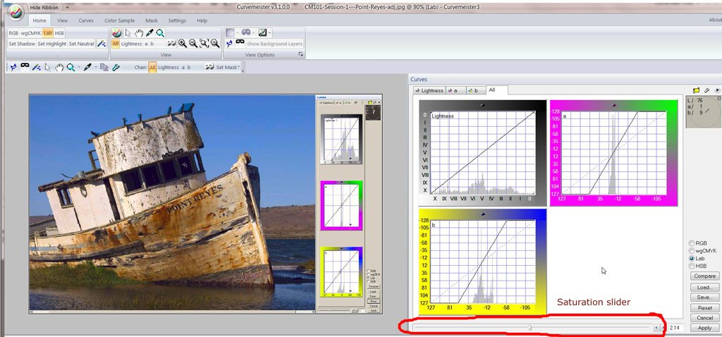

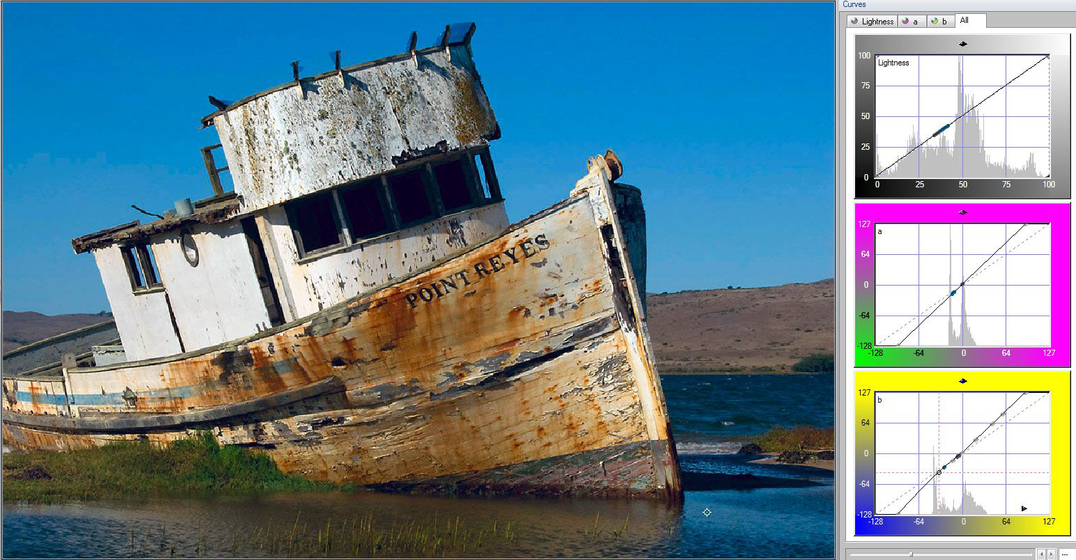

Here is the image after adjustment with CM
Boyd, excellent so far...the part that is missing from this image is color saturation. When you curve in LAB the saturation tends to fall off the image.
Attached is your posted image with saturation added in less than 5 seconds using the saturation slider at the bottom of the curves window in LAB.
- screenshot001-jpg-80 (239.8 KiB) Viewed 14992 times

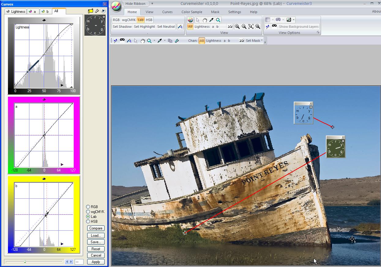

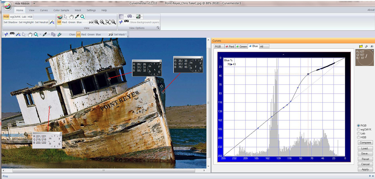

Greetings Chris,
A nice correction. you solved most of the issues with the image except the shadows. You are correct in that most of the work you did could be done in fewer steps in CM and I'll provide a more detailed sample of that after a few more people have a swing at this image.
For your posted image I would use the Blue channel and adjust only the area of the curve that controls the shadows. Since the color cast is worse in that area. In RGB color and lightness are linked so you can use the Blue channel to get rid of the cast without too much effect on the other colors. I noticed that when I fix the shadows the other colors snap much more as well. I'm betting a better choice for your neutral would help the image overall.
Notice the Hue Clocks in the image they show both before and after adjustment values for the sample point. unlike PS or PSE you can set multiple hue clocks on an image and watch the changes and how they effect your image. I used the hue clocks to help me adjust only the shadows on the Blue curve so that they are more neutral.
I am very glad you are watching this week and hope we can show you some interesting things to use CM for...
- screenshot002-jpg-60 (285.15 KiB) Viewed 14992 times
