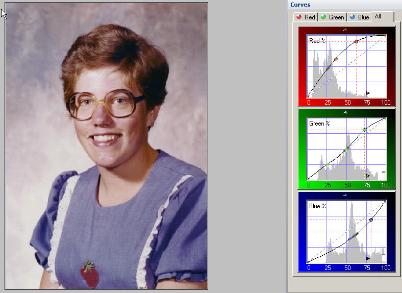

- I went back into CurveMeister (in wg-CMYK) and curved the Cyan and Black channels (curve attached) to make the dress look better. Black generation was set to Heavy as far as I remember...

- sh-jpg (73.32 KiB) Viewed 16539 times
- colourboost-jpg (83.48 KiB) Viewed 16539 times
- lab_multiply-jpg (208.78 KiB) Viewed 16539 times
- bluedress-lab-acv
- (62 Bytes) Downloaded 964 times
- beth-wgcmyk-acv
- (74 Bytes) Downloaded 908 times
- beth-lab_2-acv
- (74 Bytes) Downloaded 953 times
