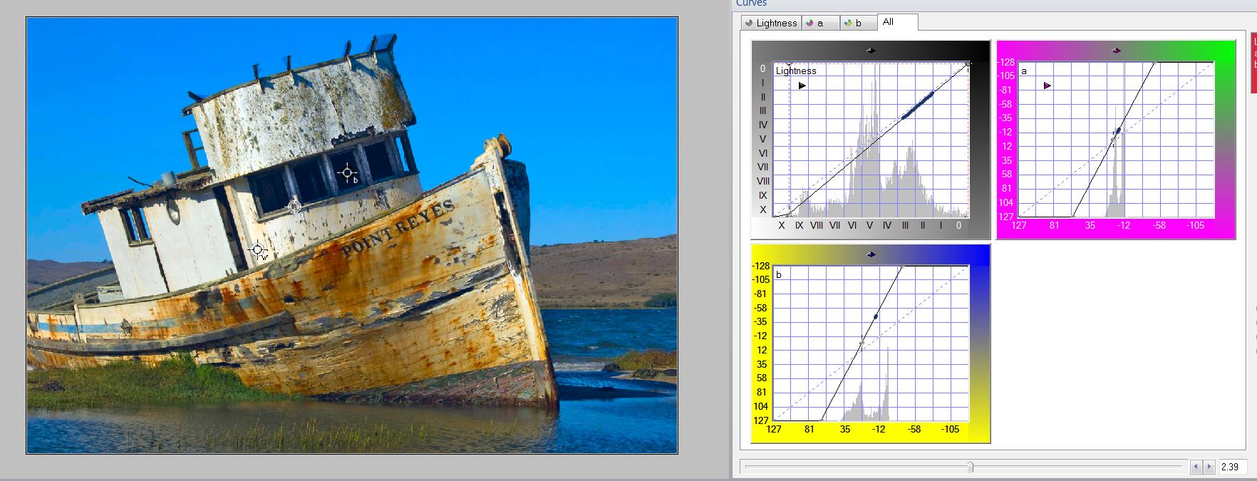

A rethink of the original image.I wanted the advantages of shadow/highlights in CS4,but to stay in curveM.Also,how different are the colors of the deckhouse and the pilothouse,pure white and very light grey?First time around I tried to get a neutral from the deck structures but wasn't happy with result.GregM
  1 in HSB I did a threshold for brightness,then located the deckhouses along the line,last spike in histogram to right,then pinned the area to the left and below,then a bit more of a boost to the houses.
  2 in LabI put a neutral (no shadow or hilight)just below the first window of the pilothouse.Chris Nicola was able to get neutrals on these houses.Very slight saturation boost.
  3 sharpening as above

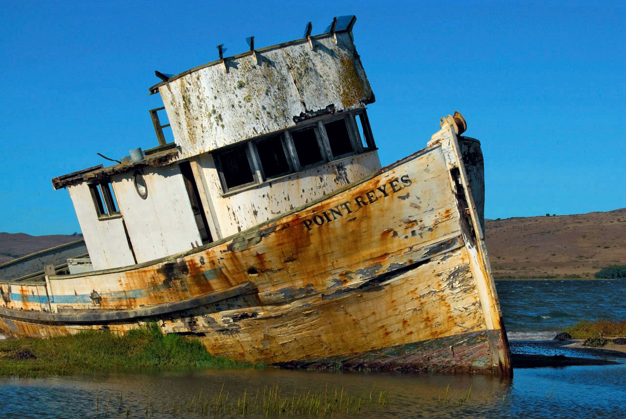

Postby ggroess » Thu Jun 10, 2010 12:11 am
My Turn...

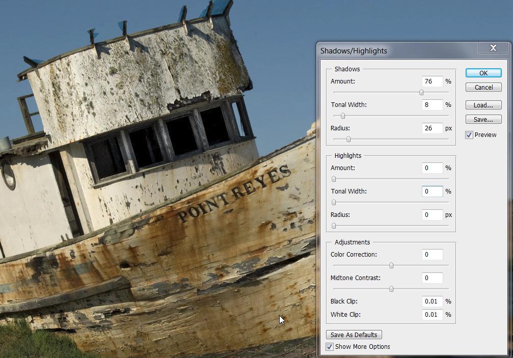

1) I used PS shadow and highlight command again.  It really is a useful short cut and If you limit the use to images with highlights less than 230 you can get some really good results.

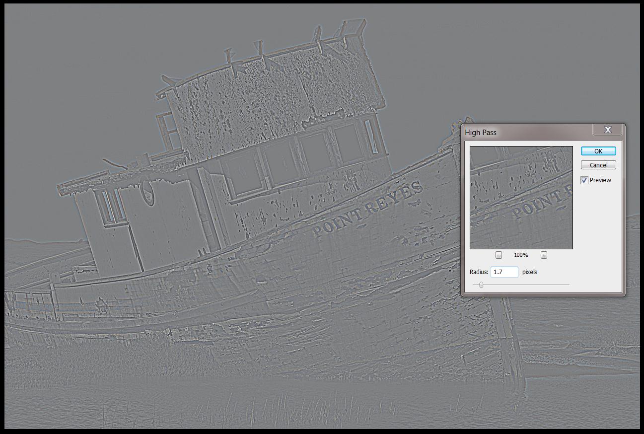

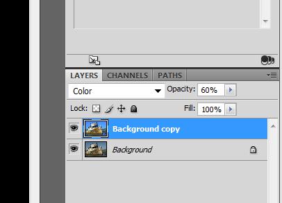

2) Copied the background to a new layer and opend CM on that layer.  I know I want to pop the color using a modified Man From Mars type technique but I also need to get control of the contrast and color.  I decided to split the difference by making all the color correction to this layer and setting the mode of the layer to be "color".  This allowed me to make the color over the top and then set the opacity to my liking.  After the color was corrected I went back to the background layer and  bumped the shadows a bit to make the image just a tiny bit more contrasty.  and
3) I applied high pass sharpening with the settings shown at 65% on the layer opacity.
4) Final image
Some final thoughts...
There is a bit of banding in the sky...It does not show up in the full resolution image.  I thought about a B channel blur to try to remove it but thought better of it.  This is a pretty simple correction when you get down to it.. This is an image where setting a good neutral saves you plenty of trouble later in the process.

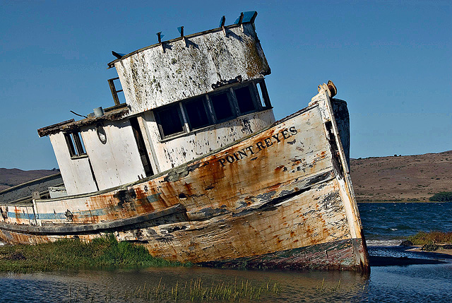

Postby ggroess » Thu Jun 10, 2010 12:12 am
I did not post the ACV files since the curves are really just end point adjustments after the neutral setting.
Final Image
point-reyes_gg-jpg
point-reyes_gg-jpg (297.05 KiB) Viewed 10486 times
