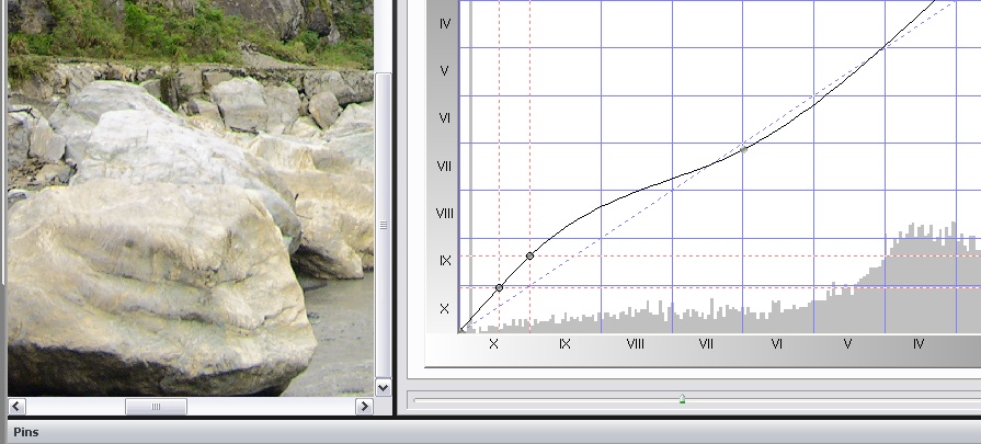

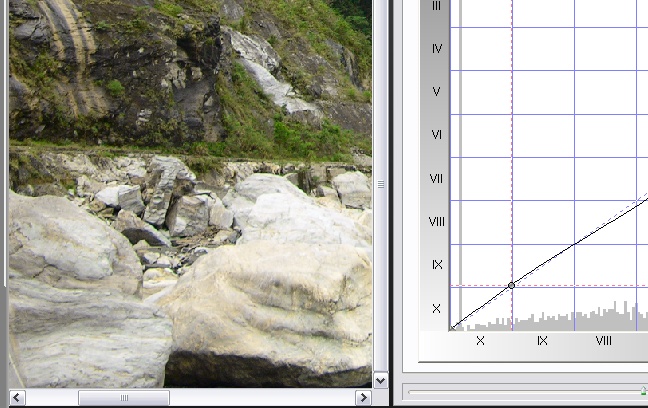

Since we are giving away the sky let's focus on the rocks....
Not a critique...just accepting the choice...
To make them look a bit better in the l channel you need to do a bit of a lizard tail on the L channel. See shots1 and 2
Shot 1 is your image as posted...
Shot 2 is a combination of a contrast pin and Lizard tail that helps the brighter parts of the rocks. I created the contrast pin manually since I could not exactly see where the worm was...it is a bit of a trick and I have asked mike to fix the worms so that they are always black on the L and K channels.
To create them manually you click on the curve to set one end of the contrast pin and then you Ctrl-click on the second point. This creates a manual link that allows you to adjust a range of values.
The color and variation looks good. you could shop the neutral around a bit if you like and see if a different tone adds or subtracts from the image overall.

- shot1-jpg-67 (117.28 KiB) Viewed 27776 times
- shot2-jpg-27 (128.58 KiB) Viewed 27776 times
That would be wonderful! Trying to see what's going on with the K channel drives me crazy!
I like the additional contrast in the rocks - I will give that a try, thanks for the tip ;)
By the way, I like critiques - you can be as blunt as you like, I won't be offended. :)
It's not about fear anymore..having talked to you and sharing some opinion...I am not afraid to tell you what you need to hear...It's more about changing your subjective view of the image..I want your version. Not another copy of mine...If I give you too much you try to make the image in my vision...I want you to trust yours...
