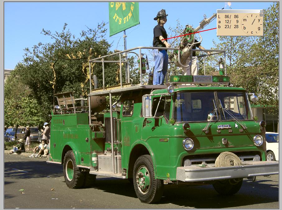

The fire engine was easy - just invert the a curve in Lab. I liked the effect a little better with a K mask applied, but since that's not what the exercise called for I'm just uploading the image as is.

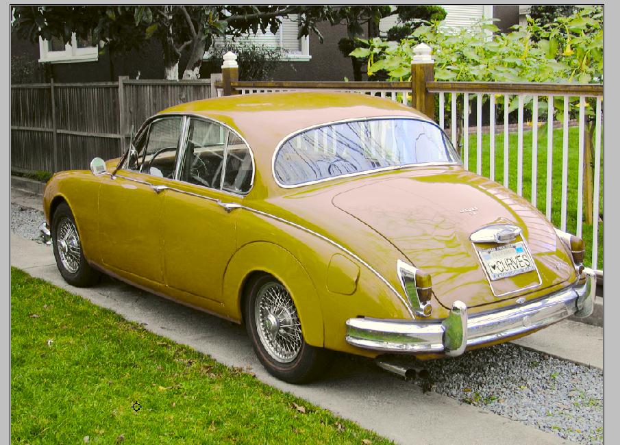

For the car image, I kept the negative halves of the a and b curves where they were (more-or-less, I did add a tiny bit of saturation to the green grass); I flattened the positive half of the a curve - taking all of the red out of the image; and finished by steepening the positive half of the b channel.
As suggested, I lightened the car in the L channel, which made it look a lot better. Returning to Photoshop, I decided to use the 'Blend If: A' sliders (set to underlying layers) to bring the grass more in line with the uncorrected image. I didn't completely revert it, as I think a slight saturation boost makes the grass look better, but on reflection the colour of the grass created by my (attached) curve did look a bit radioactive, so I wanted to knock that back a bit.

the car is a bit hot as well...if you are going to go further...
On the fire truck it is possible to keep the skin tones in line...up for a challenge??
Always  ;)

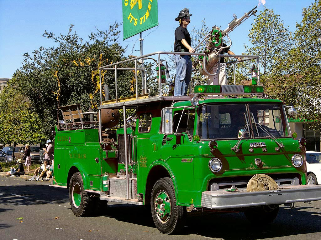

Thanks for the challenge  ;) It was fun having another go at the fire engine, and trying to limit the adjustment to the engine (although in the end I decided to steepen the b channel to add some more saturation to the sky and natural greenery).
It was a really simple curve to write, as there was so much separation between the skin and the engine in the a channel (I've attached the curve in case you want a peek at it).
I also set shadow, highlight, and neutral points, and added a little contrast in the L channel - something that I hadn't done in the other version I posted, so this is also a little snappier.

well done...
These are pretty easy curves to write...as you say...
