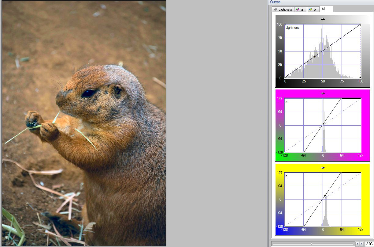

Postby ggroess » Tue Jun 08, 2010 4:11 pm
I moved the blue slider to get rid of the excess yelow. Adjusted the green slider to improve the colour. Then fiddled with he RGB slider to improve the contrast. Opened in PSE and increase brightness +20 and sharpened USM radus 1 at 100%.
I have a question please. What curve would I use that is comparible to the brightness slider in PSE?
Kind Regards
Chris Nicola
Guest for the week

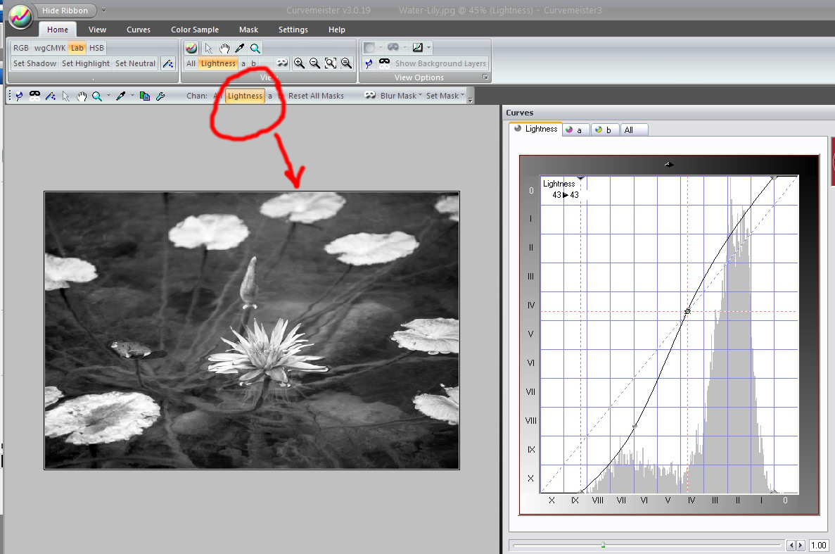

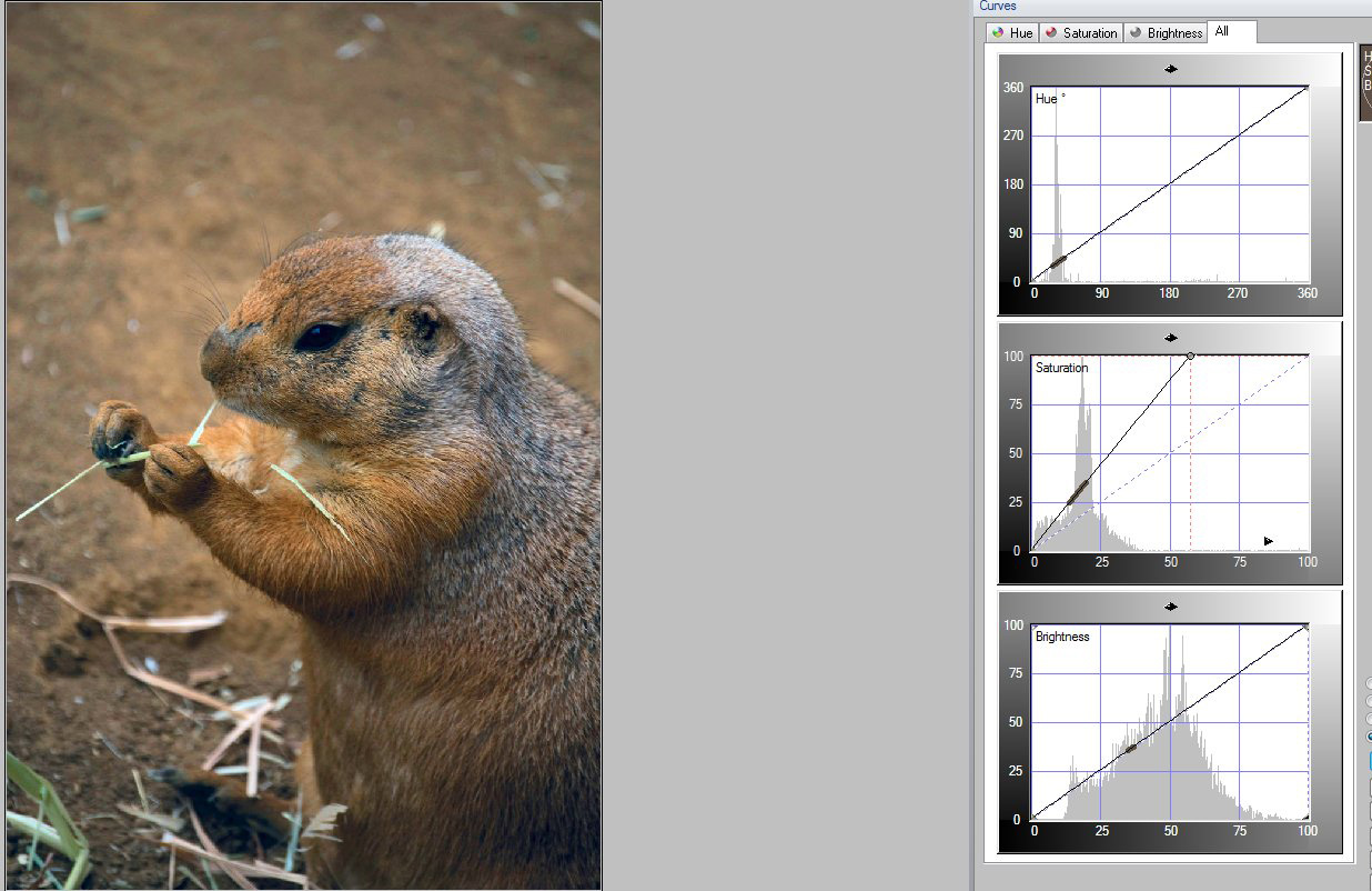

The L channel in LAB is the closest analog to brightness and contrast.  It allows you to adjust the luminosity without effecting color.
This is one of the primary reasons for using LAB.  You can adjust image contrast and brightness without dealing with color.  Click on the LAB button and then the L channel in the upper center of the window and you will see only the L channel for image adjustment.
See screen shot...
shot1-jpg-80
shot1-jpg-80 (201.37 KiB) Viewed 12226 times

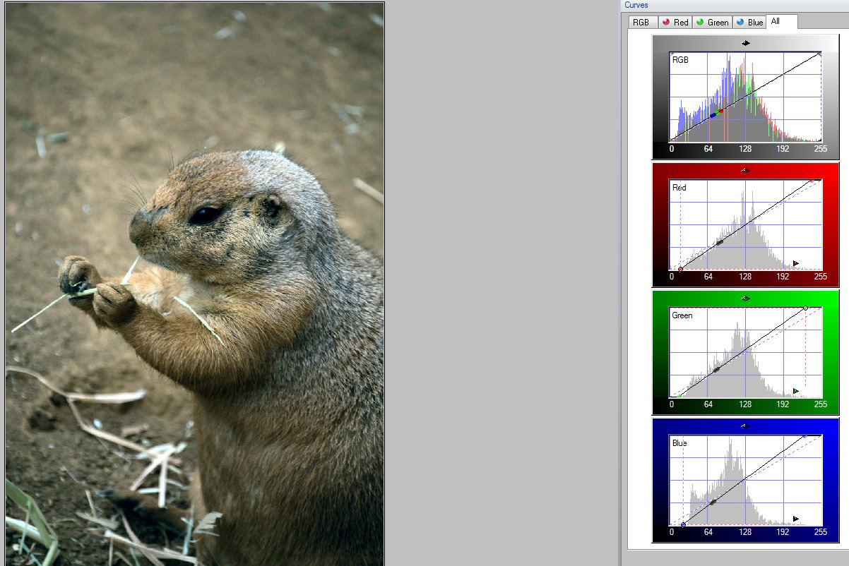

Postby mikemeister_admin » Tue Jun 08, 2010 4:50 pm
A move from red clay country.More naturalistic and more green in that blade of grass.GregM
Sharpening action set to 40% opacity.The nature of the ground suggests vignetting in the upper corners,someting I had changed in the Lchannel in the first image but left here.Messing with the RGB composite channel  can cause unexpected color shifts.

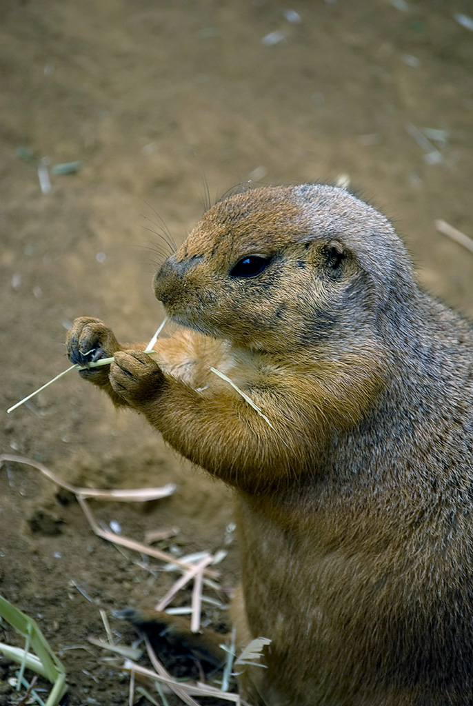

Postby imported_BoydMac » Tue Jun 08, 2010 7:47 pm
I adjusted the black point to the darkest area of the eye and the light end of the cure to an area that appeared reasonable to me.  It's not clear to me that the image should be a brown as it is do I played with the neutral.  The result is a image which to me appears more reasonable from a color standpoint.  I'm sure further optimization is possible and that we'll learn additional techniques in the coming weeks.  I'm already amazed by what we can do.
BoydMac
cm101-session-1-brownie-adj-jpg
cm101-session-1-brownie-adj-jpg (196.89 KiB) Viewed 12226 times
Postby mikemeister_admin » Tue Jun 08, 2010 8:37 pm
BoydMac,here is your image with some embellishments.you can control the effect by increasing or holding back the action or c
hanging the layer opacity.
Part I RGB and Lab
boydmac1-jpg
boydmac1-jpg (276.87 KiB) Viewed 12226 times
boydmac2-jpg
boydmac2-jpg (268.73 KiB) Viewed 12226 times

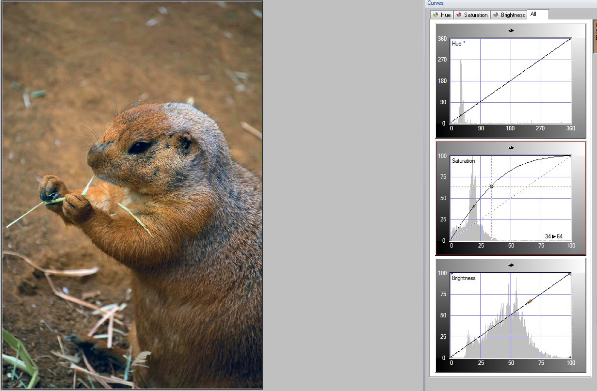

Postby mikemeister_admin » Tue Jun 08, 2010 8:40 pm
PartII HSB
I think of the line in the saturation box of the first image as a slope and the second as lifted(or curved)GregM
PS You'll never get in trouble with Greg Groess for too much color.
boydmac3-jpg
boydmac3-jpg (257.83 KiB) Viewed 12226 times
boydmac4-jpg
boydmac4-jpg (263.81 KiB) Viewed 12226 times
