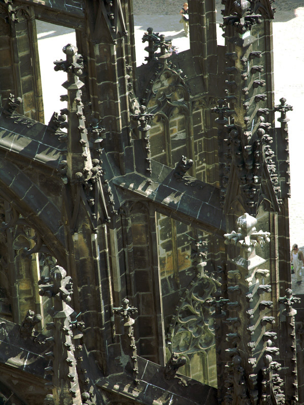

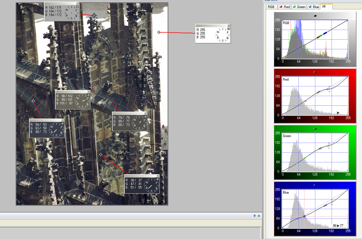

To me this is a challenging image. I have set the shadow threshold and gone back in using RGB. As you can see, I have multiple hue clocks, two in areas that looked like the ones you chose as examples in the lesson. Don't know whether it was good or not, but I set a neutral on the gray pavement on the top. Maybe it's because of where I chose to put the hue clocks, but I cannot equalize one without messing up another. Looks slightly green on my monitor. The last image is the original one I did in LAB--no screenshot--sorry. I know it's blue. I like it, but it doesn't address the assignment, which is the color cast :-)

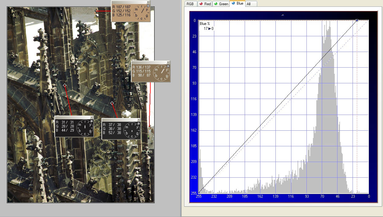

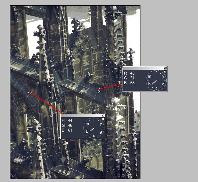

Rhonda let's look at the the second image for this...you are pretty close here...My shot 1 shows 2 hue clocks on the image. What are we seeing...
1) the shadows are too blue
2) The values for the blue are close together...so 1 adjustment is going to effect the other.
3) Both blue values are higher than the rest of the colors and we need to be closer to the other numbers.
So...

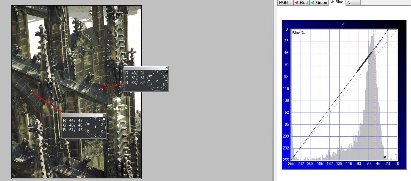

Since they are close together I lifted the end of the curve as shown in shot 2 to bring the blue shadows down a bit closer to the red and green values. Not perfect but closer...I too had one adjustment start to mess up the other so I set two adjustment points on the blue curve. One at 51 and then 1 at about 45. The actual numbers are not as important as being able to limit the curves effect on the image. Then I used the arrow keys to move the selected point at 45 around a bit to get the 2 clocks closer...it was not an exact science but rather a slow single arrow at a time process. It really only took about a minute...

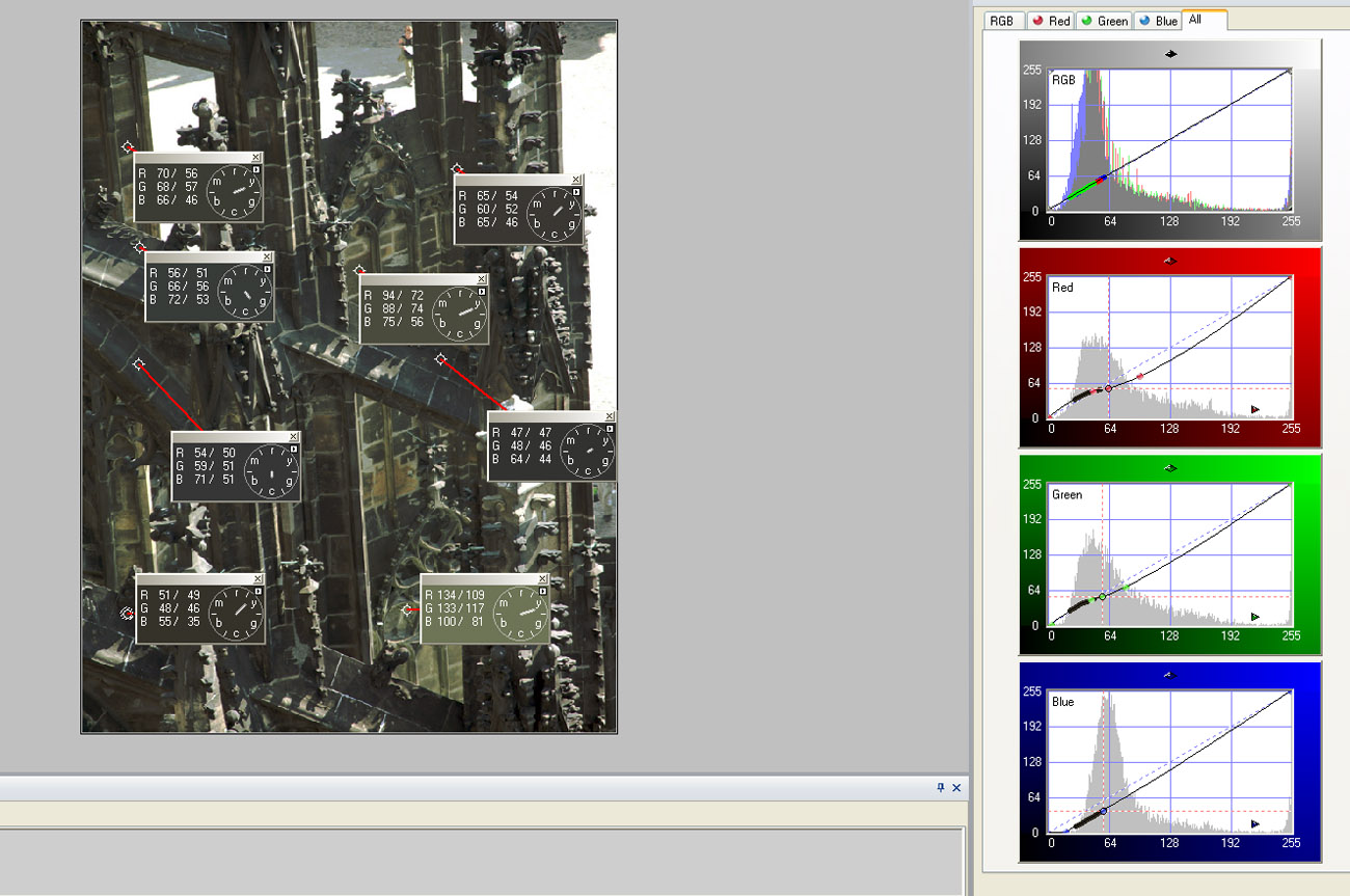

Thanks, Greg. I took my image back into CM and tried to duplicate your hue clock positions. I was able to get both hue clocks to equalize, but then I added other clocks around the image to check other colors--the plot thickened. All kinds of other casts... As I worked to correct them, my original two hue clocks that imitated your position, got out of whack. It seems that as you add clocks, the more unmanageable your image is. Is it actually possible to get the casts out of the entire image?
When I said that the hue clock only gave one number I was comparing it to the input/output, in which there are two numbers, one for the vertical plane and another for the horizontal. After you move on the curve and get a second number on the hue clock (after the slash) it is an "after" number--but is it the input or output number, or neither? The first image is my post from above for comparison. The second and third are the screenshot and Photoshop of my last re-work.
