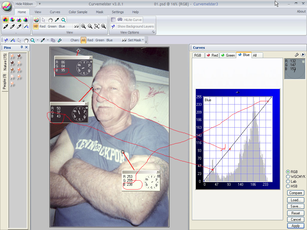

The screen shots attached show how to locate the points in question. If you click on the grid square but not the curve line and you hover your mouse on the line without clicking you will see a set of numbers like the ones in the top left of the curve grid. These show me the value of the curve under the mouse. I just move up and down the curve line until I hit the number I want to adjust and click there...

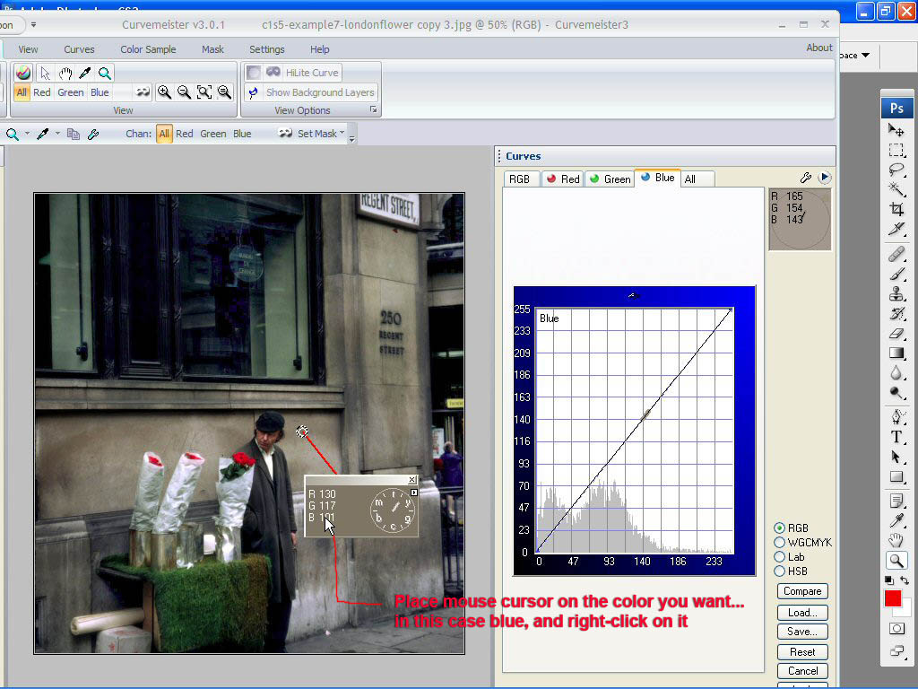

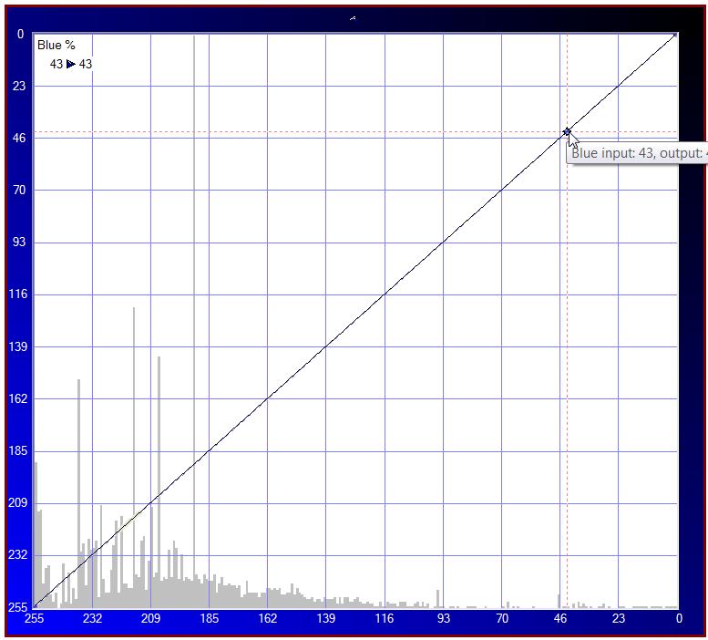

Great post, Art! I've had the same questions. I know I can slide my mouse around on the image and see where the "worms" are on the curve channels, but then I guess when it comes to remembering the exact spot and go from there. For me, the input/output numbers are confusing--I can see what they mean in terms of the place on the grid, but when I'm using my up/down arrows (which doesn't always work) to modify a point, it doesn't seem like the input/out points are related to the color number on the hue clock. The hue clock has one number for each color--say 83 for Blue, but I can't get the i/o numbers on my curve to actually become active until I click on a point--hovering doesn't work. Anyway, does that 83 stand for input or output on a curve? Great help from your reply, Greg!
The notation is : "Input / Output" You cannot have an output until you make a selection.
If you have a point selected then you will get a "number / number" notation when you make a change.

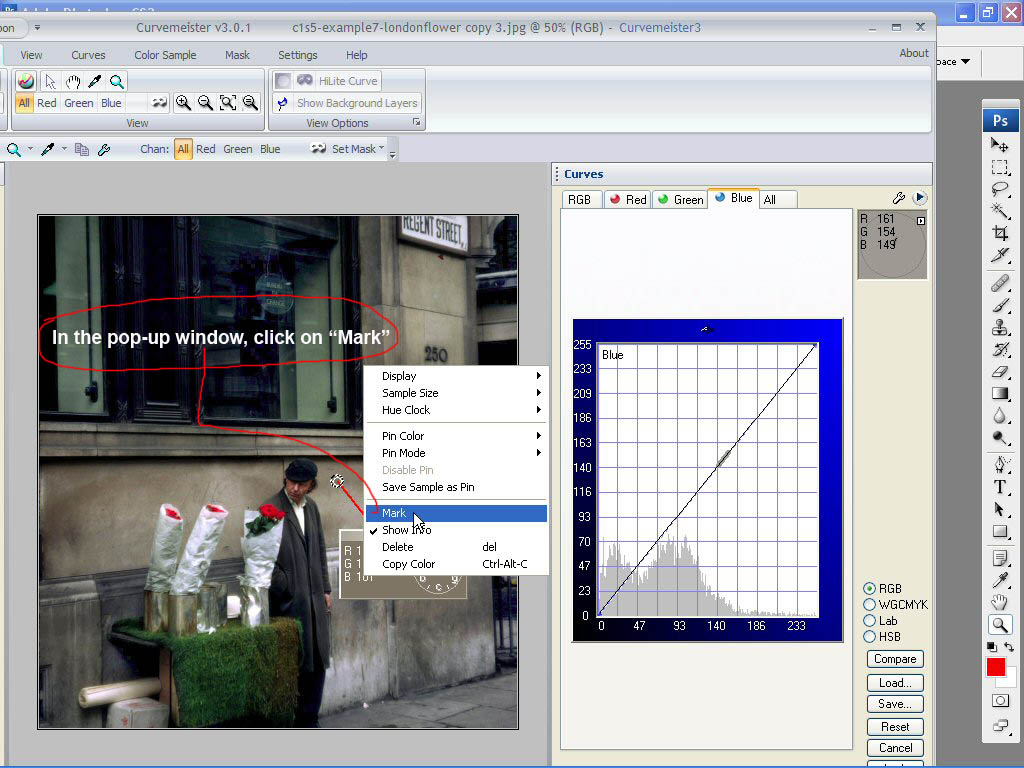

You can set a hue clock and then right click and select "mark" to add a mark to the curve line.

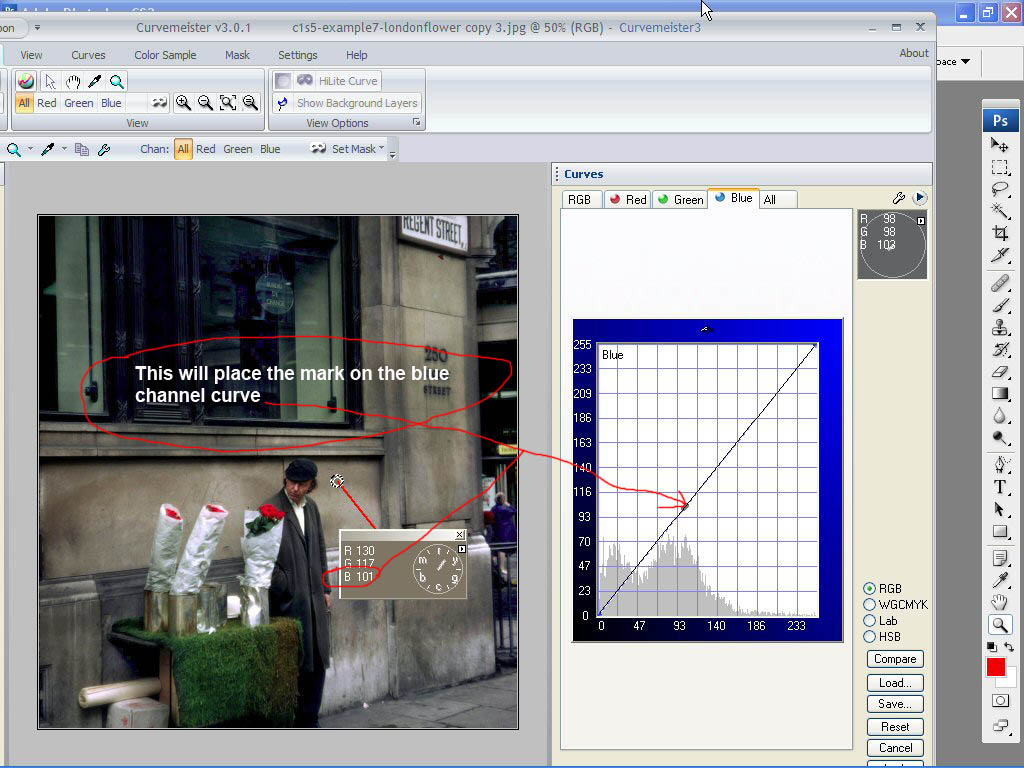

Rhonda, to explain what Greg just said........if you want to find the value of a color on the curve that the hue clock displays, here are some pictures that explain it.
