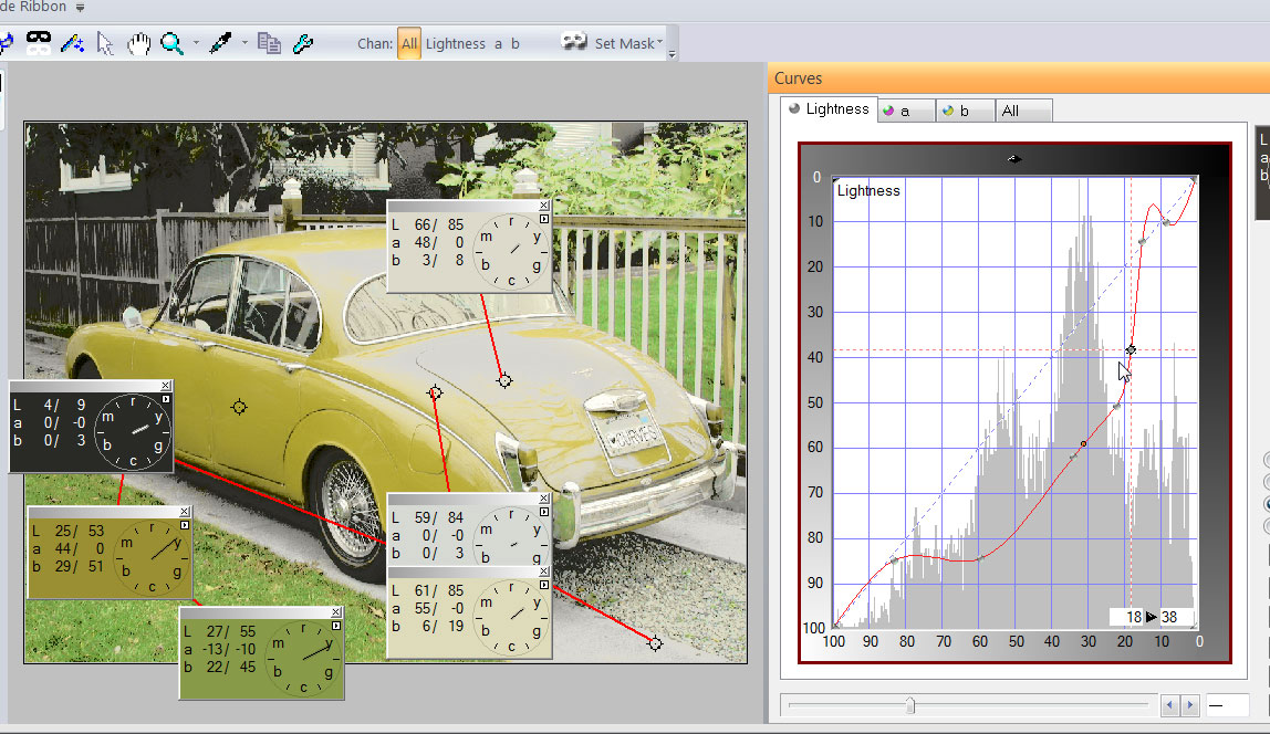

I like the license... I (heart) curves.  It was tougher.  I do not think I nailed this one.
jaguar-jpg
jaguar-jpg (999 Bytes) Viewed 14856 times
jaguar-ss-jpg
jaguar-ss-jpg (999 Bytes) Viewed 14856 times

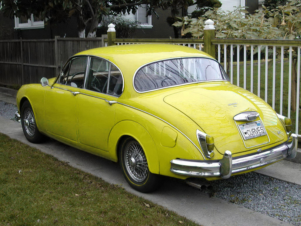

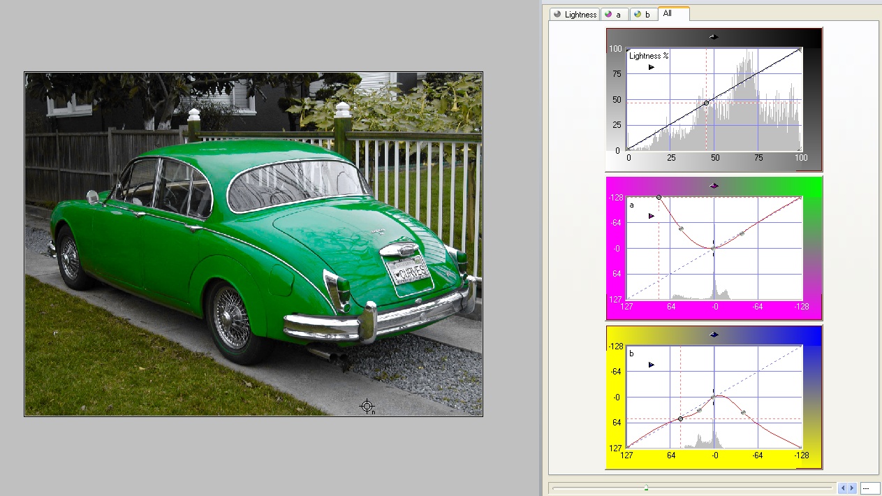

Postby ggroess » Thu Oct 07, 2010 12:15 pm
No...Swing and a miss...
The rest of the image has to be reasonable....
Here is a green version....
shot1-jpg-32
shot1-jpg-32 (278.79 KiB) Viewed 14856 times

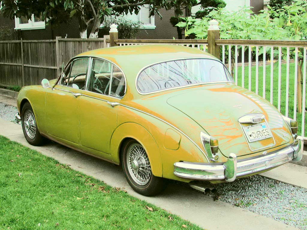

Postby sjordan93436 » Thu Oct 07, 2010 6:13 pm
Another try.  Any better?
47-jaguar-ss1-jpg
47-jaguar-ss1-jpg (130.52 KiB) Viewed 14856 times
47-jaguar-ss2-jpg
47-jaguar-ss2-jpg (155.25 KiB) Viewed 14856 times
jaguar-2-jpg
jaguar-2-jpg (161.96 KiB) Viewed 14856 times
Postby ggroess » Thu Oct 07, 2010 6:26 pm
It is better yes...
The Green is getting into the yellow too much...see what you can do to isolate that...
I don't want to give too much away yet....

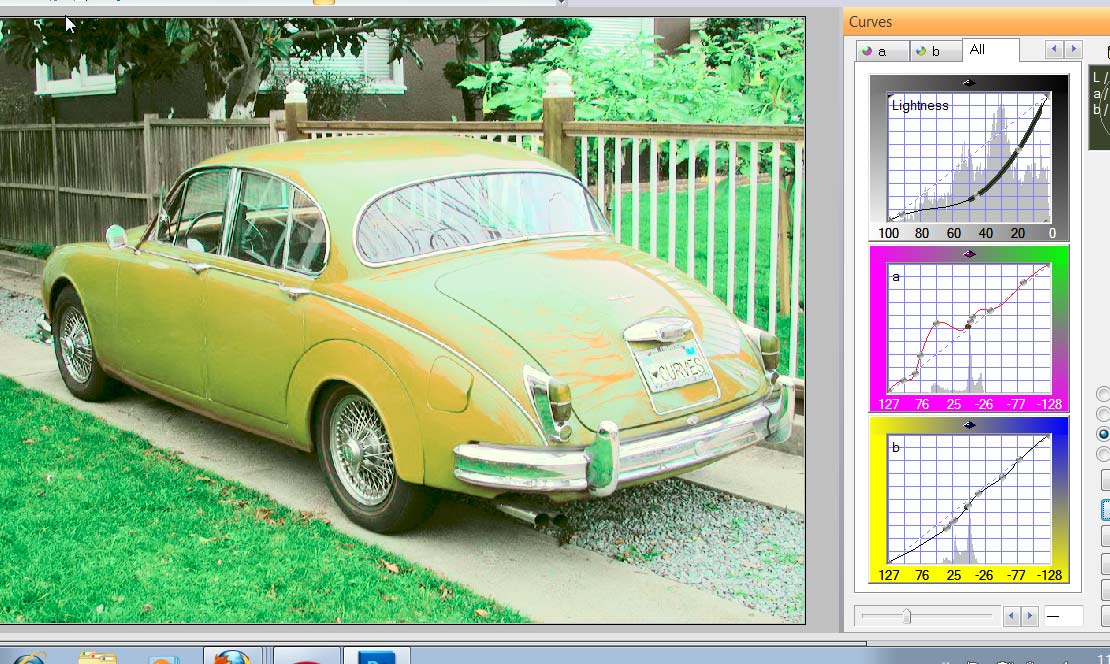

Postby sjordan93436 » Fri Oct 08, 2010 5:20 pm
Yet another feeble attempt.
I thought 0 a and positive b is yellow.  But the L channel changes that apparent color.
46-jaguar2-ss-jpg
46-jaguar2-ss-jpg (216.82 KiB) Viewed 14856 times
46-jaguar2-ss2-jpg
46-jaguar2-ss2-jpg (221.21 KiB) Viewed 14856 times
46-jaguar2-jpg
46-jaguar2-jpg (255.99 KiB) Viewed 14856 times

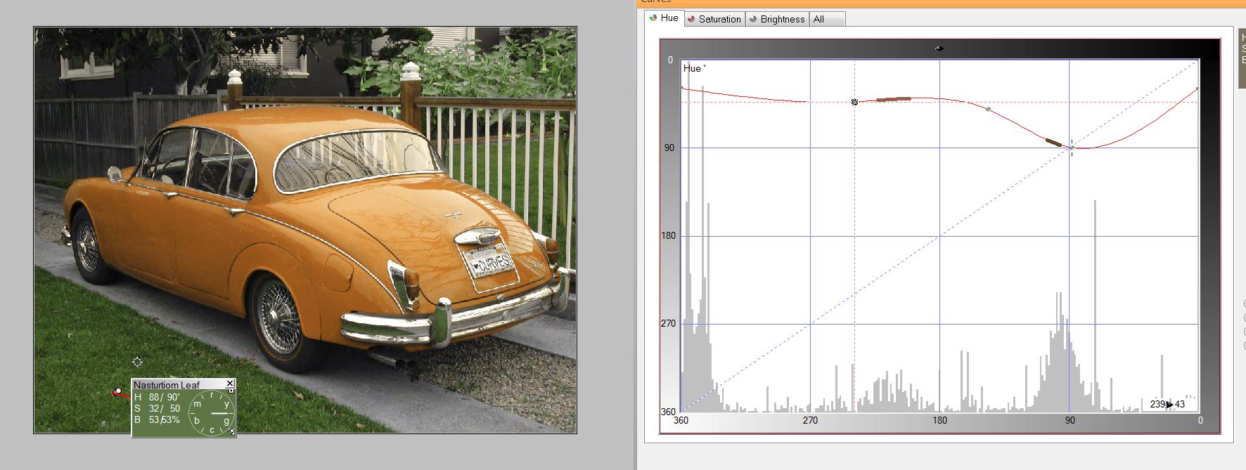

Postby ggroess » Fri Oct 08, 2010 6:11 pm
See if you can spot the hint..... ;D
This is a great way to paint it any color really...
screenshot001-jpg-45
screenshot001-jpg-45 (167.86 KiB) Viewed 14856 times
screenshot002-jpg-34
screenshot002-jpg-34 (158.84 KiB) Viewed 14856 times

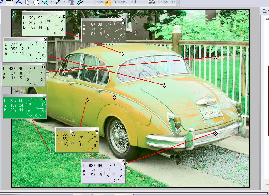

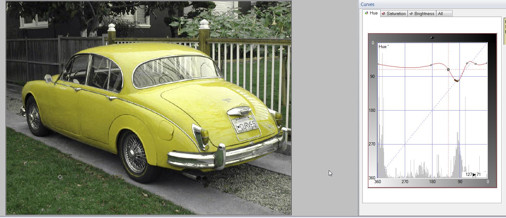

Postby ggroess » Sat Oct 09, 2010 1:13 pm
sorry to hear that...lol
If you try this in HSB you can go to any hue you want.  Make the Hue curve a horizontal line by moving the ends to the mid line of the curve window.  Select one end of the curve then Ctrl-click the other end.  It is the same as making a contrast pin really.  Then you can move the line up and down and find any hue you want.

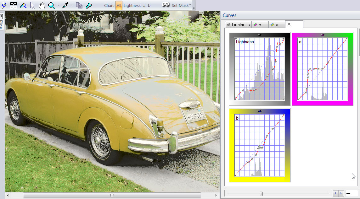

Postby sjordan93436 » Sat Oct 09, 2010 2:24 pm
Greg.  I "cheated"  I used HSB for that image.
I am not a curvemeister or
cm jr or
even curvemeister jr apprentice.
I found the exercise easy in HSB, and difficult in LAB.  Here is my LAB technique.  I pinned all three curves.  I alt clicked a couple of red places to change.  Then I forced the A curve to zero for those spots, B curve to positive, and made the L higher.  The problem that I ran into was 0,0.  Neutral is 0,0 and that had to stay.  there were several red points at -1 b or 0b or 1b.  If I moved them to positive b then my neutral went also.
It is interesting and I await the solution.
Postby ggroess » Sat Oct 09, 2010 5:29 pm
It's not cheating...it's solving the problem..
The point of using LAB is to make this more difficult than it has to be..it forces you to play in LAB..In that you succeeded.
