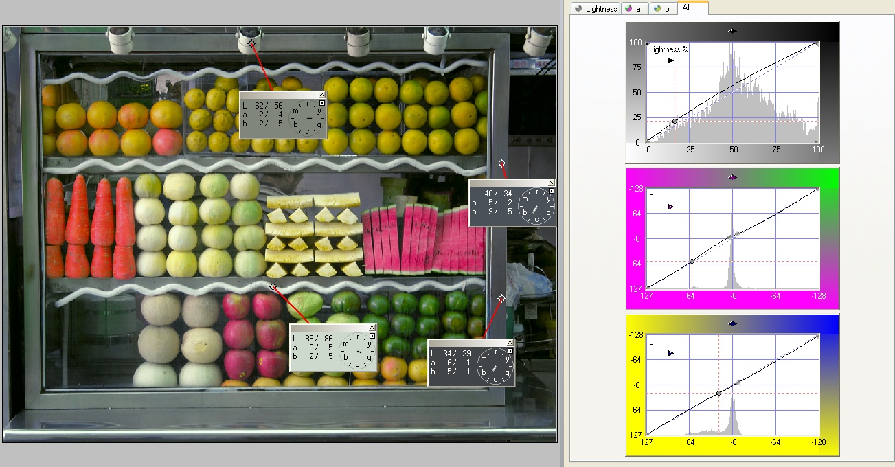

Postby ggroess » Thu Oct 07, 2010 2:08 pm
Julie...
I think you are closer to the results you want than you think you are...
Remember to use the Arrow keys if needed for small adjustments...
Take your image as posted and add the ACV file I have posted.  Some of the issue is the brightness...Adjust the brightness down a bit and the perception of the color cast changes a bit...
There are issues but they are not too big...
shot1-jpg-31
shot1-jpg-31 (297.73 KiB) Viewed 5424 times
