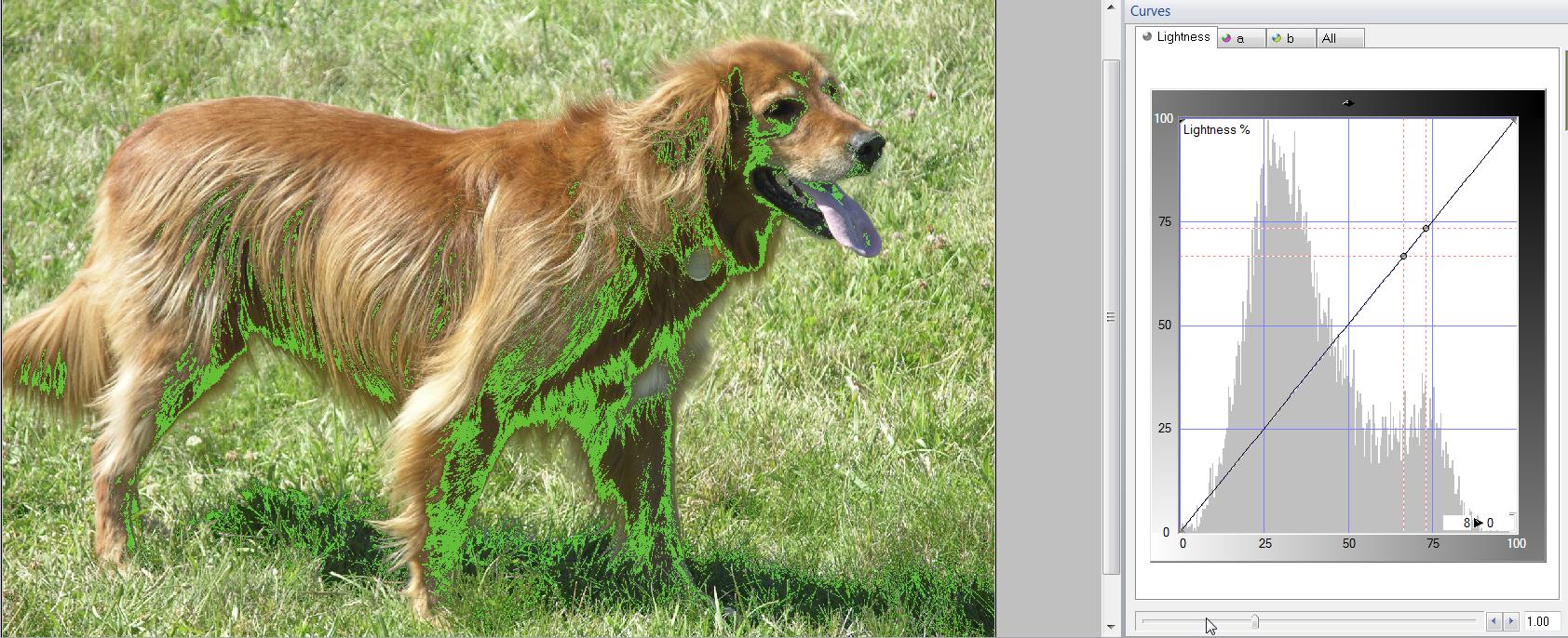

Postby ggroess » Fri Oct 08, 2010 6:24 pm
One thing to remember about this...It can be a "little goes a long way" kind of process.  I often use one of the other tools we have called the curve highlighter to help me figure out what I am affecting.
If you select the contrast pin and then click on the highlight curve tool you can better see what is being changed.  The area of the curve between the two selected points is in the highlight.
screenshot003-jpg-18
