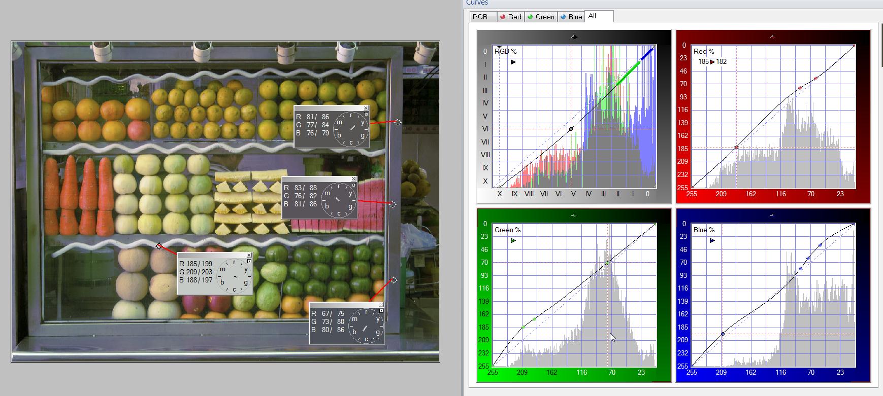

Postby ggroess » Wed Sep 29, 2010 7:31 pm
Really not too bad...
This is a really tough image and you are forced to make a lot of compromise...One thing that always helps with this is choosing sample points that are far enough apart in brightness in RGB so that you can adjust without your work overlapping.  Some of the adjustments cross over each other and sometimes compete for the same space on the curve.

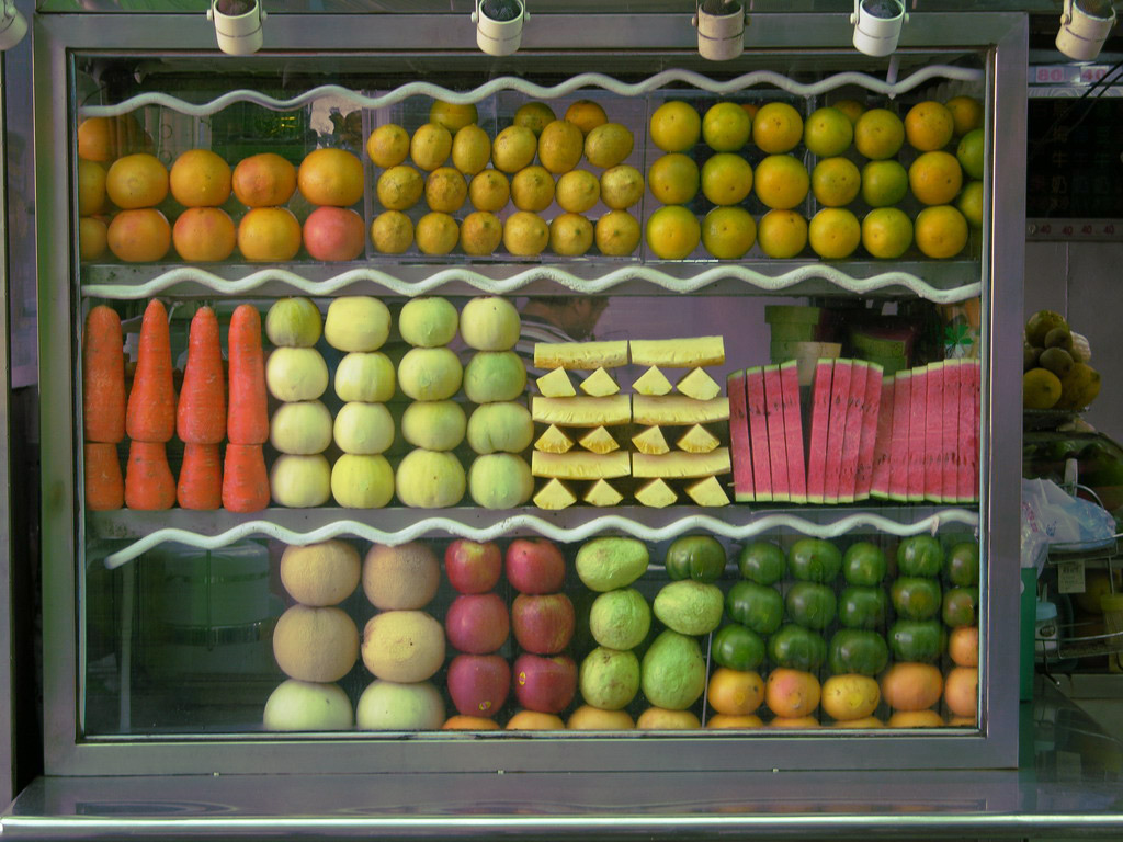

Postby sjordan93436 » Fri Oct 01, 2010 7:12 pm
another attempt.  I would now fix contrast/ lightness, but the exercise is to see color correction.  It actually helped to finish the last exercise before reattempting this.  The grays are better, but the color clock on the flesh moved to the 1 o'clock.
32-fruita-ss-jpg
32-fruita-ss-jpg (245.85 KiB) Viewed 15992 times
32-fruita-jpg
32-fruita-jpg (234.93 KiB) Viewed 15992 times

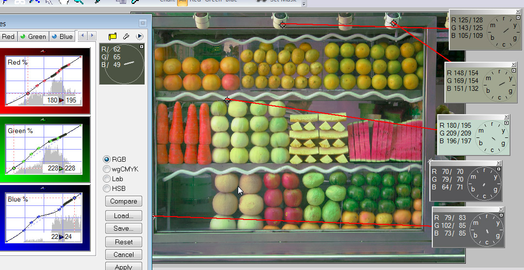

Postby ggroess » Fri Oct 01, 2010 7:32 pm
It is looking much better...
I can see that you are having a fairly good time with this tough image...
Take your image as posted and apply the ACV file I have attached...I don't know if it is better (I think so but it's subjective) but it does make it look less green...
screenshot002-jpg-37
screenshot002-jpg-37 (226.08 KiB) Viewed 15992 times
32-fruita-jpg-rgb_gg1-acv
(98 Bytes) Downloaded 873 times

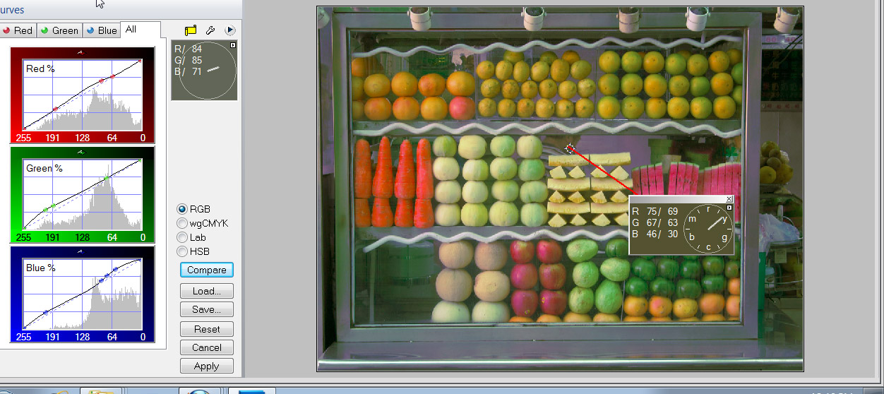

Postby sjordan93436 » Fri Oct 01, 2010 7:48 pm
I tried that, but the hue clock on the man went from 1:30 to 1:50  ...  wrong direction?
r from 75 to 69
g 67 63
b 46 to 30
did I do something wrong
35-drums-a-ss3-jpg
35-drums-a-ss3-jpg (206.26 KiB) Viewed 15992 times

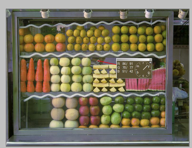

Postby ggroess » Fri Oct 01, 2010 8:14 pm
Try reloading it..When I loaded on my system it Skin went from 86 to 91 in the Red.  I re-sampled and attached Screen shot...
screenshot001-jpg-48
screenshot001-jpg-48 (79.41 KiB) Viewed 15992 times
Postby sjordan93436 » Fri Oct 01, 2010 8:58 pm
I must be me.  I must have applied a curve twice or gone back too far,
Postby ggroess » Fri Oct 01, 2010 9:08 pm
did it work the second time??
Postby sjordan93436 » Fri Oct 01, 2010 9:26 pm
er, no, It did not work.
On your screenshot saved to my computer the man's neck was 91,82,51  .  You said you had 91 in R.  So I think I got that right.
I then loaded to original photo.  added the curve from history.  add your curve.  Should be the same??
I had 82,81,46 same spot before curves.
I loaded a curve from history and
76, 76, 31
I opened a new layer.  Loaded your curve and
71,71, 18
I seem to going in the wrong direction.
