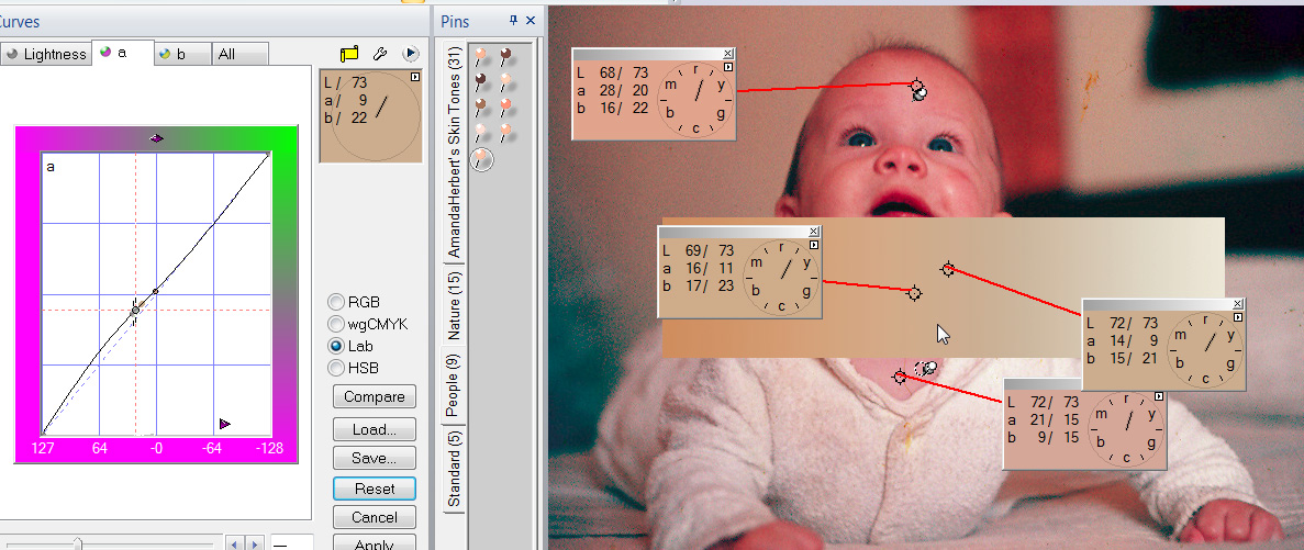

Here I tried something different.
After pasting the swatch into a blank layer, I ran CM on the composite image. . I marked a spot on the baby and the swatch where the L numbers matched. I pinned the swatch and set the pin mode to match image original color. I move the pin to a new location on the baby with the same L value. Perhaps (????) I made a mistake. I did not set the mode to hue/saturation. Since the brightness was the same, that does not make a difference?? It probably was set to H/S/B.

LAB will have problems with more than one pin you might want to try this in RGB mode
I'll have to try thi sbut if you do this in RGB you will get a better match.

I think you are right. RGB is a better color space for pins with multiple points. LAB is better (in my mind) for selecting the points.
I think this technique would work, it I used LAB to selected the points. (I could put hue clocks). Change to RGB mode staying within CM. Mark points on the swatch and pin the image with these points.
This seems to be to be much easier than setting foreground and background points in PS.
I think this swatch technique is good and better than pins for skins. It is less important or unnecessary for other corrections. I will continue to use this to fix critical skin tones. It is fairly easy since my grandchildren have Caucasian pallor skins.
