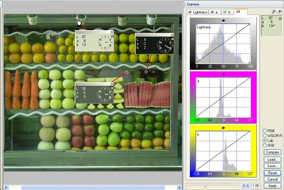

Here is a screen shot of the fruit picture.  I have placed three hue clocks on the picture, one on the whitest spot I could find, one on the darkest spot I could find, and one on what looks to be a gray area.
Looking at the numbers on the hue clocks, I don't understand what they mean.  In the white hue clock, the values are L = 86.....a = -6....and b = 13.  The pointer on the hue clock is towards yellow.  What does this information mean?  What does an "L" of 86 mean?  Does the 86 mean that in the "L" curve, the point that I sampled from has a brightness of 86?
Looking at the L curve while holding the cursor on top of the white sample point, you can see the "worm" is located between 75 and 100. (I assume the worm is there because the "L" is 86, which is between 75 and 100?) Okay, so what do I do now?  Do I set a control point somewhere between 75-100....maybe at the 86?  If so, then after I set a control point there, what do I do with it?
If that is correct, then does that mean that the "a" value of -6 means that in the "a" curve, the sample point is located on the negative side of zero.....towards the green?
If I have that correct, then what do I do with that information?  Do I set a control point at -6 in the "a" curve?  If so, what do I do with it?

Start by lifting the bottom Left corner of the A channel   While you lift it watch the A values of the hue clocks.  When they hit Zero you have made the A channel neutral.  Then Drop the Top Right corner of the B Channel until the B values of the hue clocks are zero or near zero. you then have made the B channel neutral.
The L values are a brightness scale that goes from 0 to 100.  0 =black 100 = white.  everything else is a shade of gray.
DO NOT WORRY THAT YOU DO NOT GET THIS PERFECT...I never do...
This is a great start.  You are asking the right questions...the other colors in the image are going to go all over the place but for now just try to make the A and B channels neutral in 2 out of the 3 hue clocks that you have set.

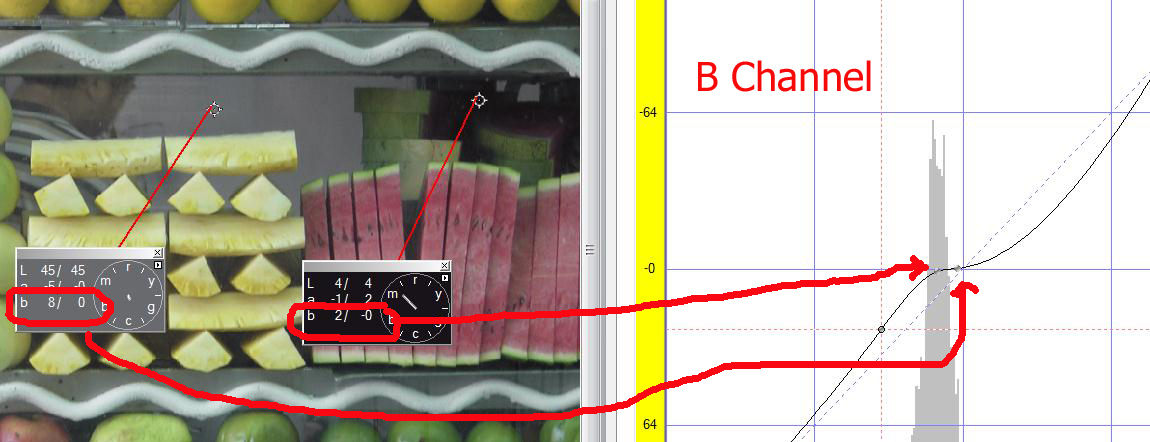

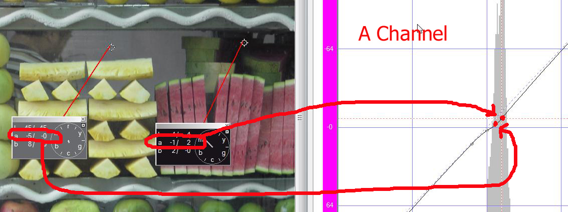

Shot 1 is the B channel and Shot 2 is the A channel.  The moves are very small and you might be better using the arrow keys to get the hue clock close.

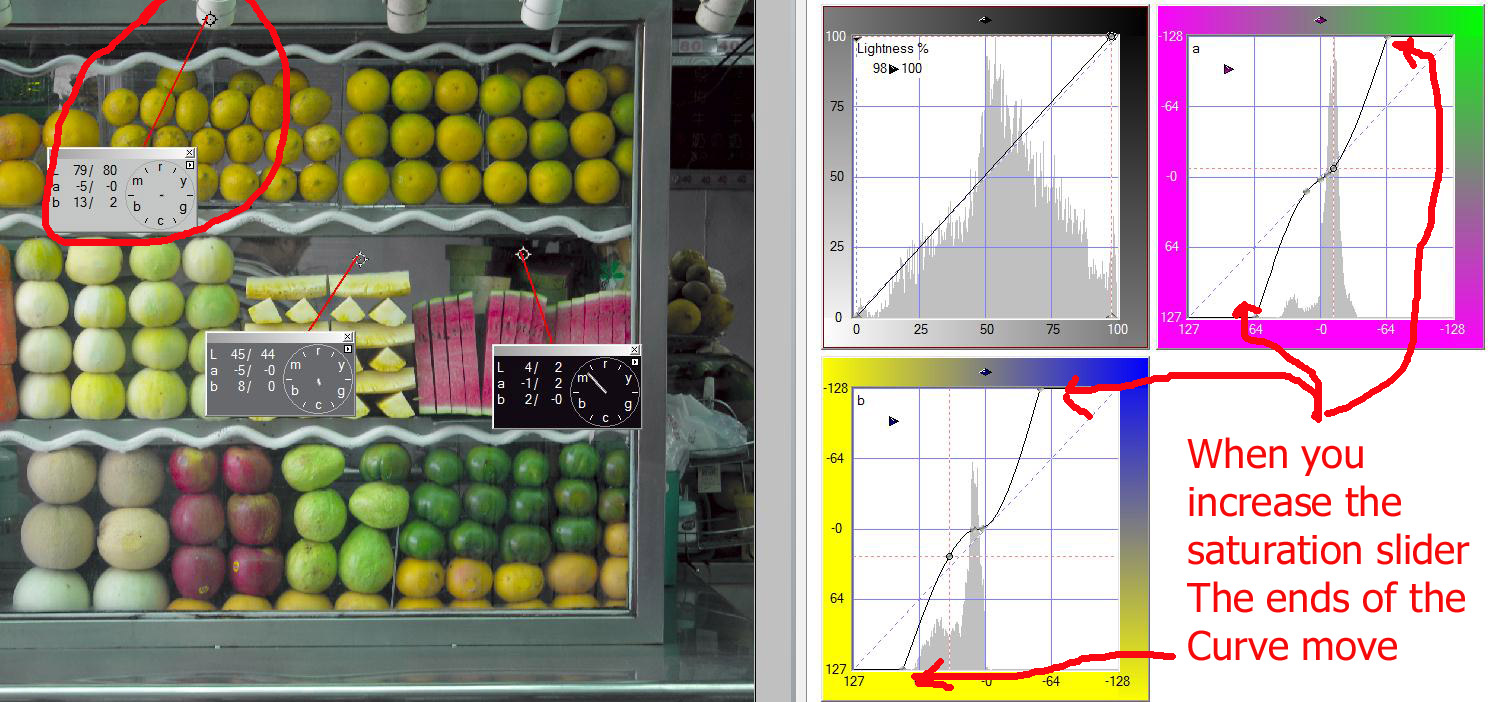

Shot 3 is the same settings with some saturation slider added and a third hue clock just to check the overall cast.
